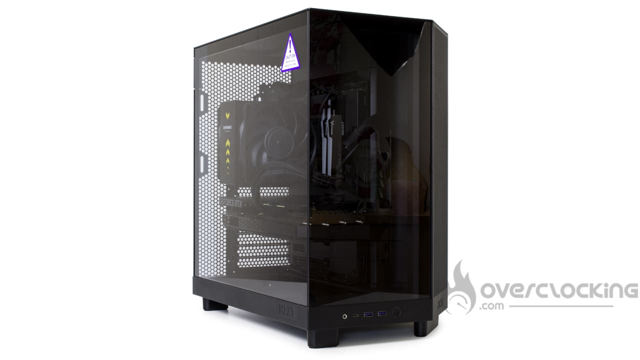

H6 Flow exterior:
This model is indeed a compartmentalized version, and its dimensions speak for themselves. Indeed, this model is particularly wide at 287 mm. However, the depth and height remain contained: 415 (D) x 435 (H) mm. As for weight, we’re in the acceptable range with 9.4 kg on the scales… A far cry from the 16.3 kg of be quiet!’s Dark Base Pro 901, for example.
As always with NZXT, we’re dealing with a sober product with a sophisticated aesthetic. As you can see, the glass of the front panel matches that of the glass… However, there are no visible pillars. As with Hyte cases, the aim is to emphasize the view inside the configuration. Otherwise, the brand logo can be found at the bottom, on the left. In short, a model with clean lines.
As for the price, as you can see, it’s a case that sells for around €110-120, depending on the store. If you want RGB, you’ll have to reckon with an additional cost of around twenty euros.

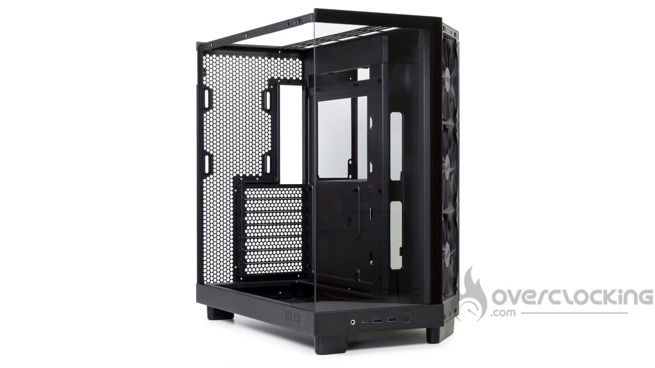

The underside:
NZXT H6 Flow dessous
A closer look at the underside of the case reveals its compartmentalized design. As you can see, the right-hand side is entirely dedicated to ventilation. It features two fan slots. The left-hand side has no practical use whatsoever.

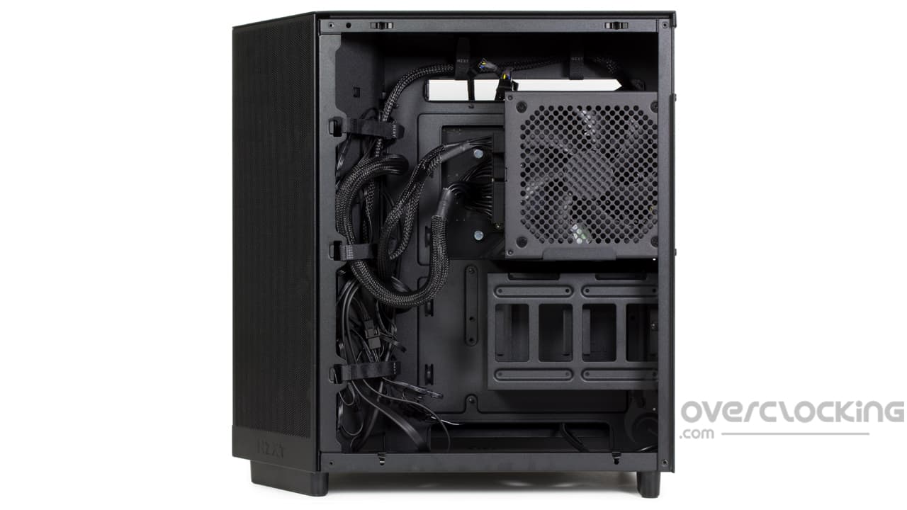

Internally, we find a spacious case with plenty of room around the motherboard tray. What’s more, this motherboard can be upgraded to ATX format. If we wish, we should be able to go as far as E-ATX, but this could undermine the airflow of the front panel fans… Finally, the bevel.
Cable routing won’t be a problem, as there are so many of them. Above, below and to the sides of the motherboard tray, there are enough. By using them, we should be able to reach the various connectors on our board without difficulty.
As for rear clearance, it’s not a problem, since there’s… Simply the width of a power supply unit!

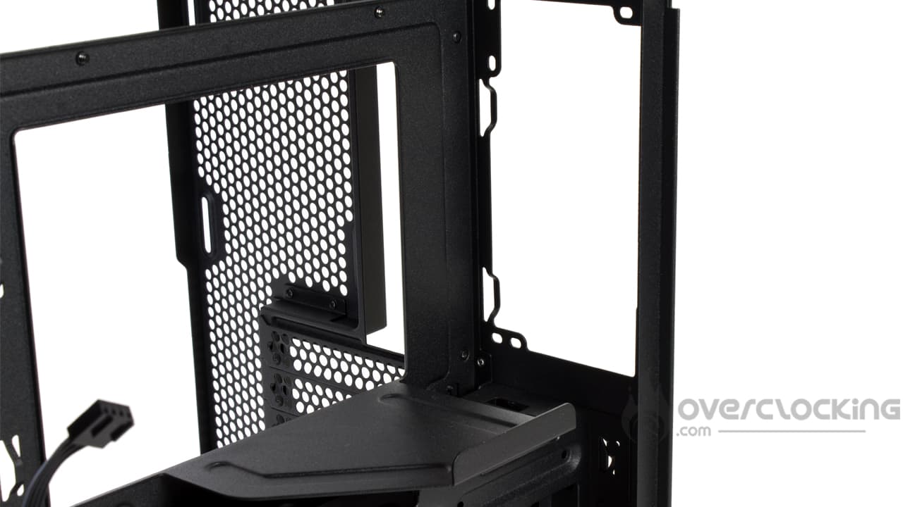

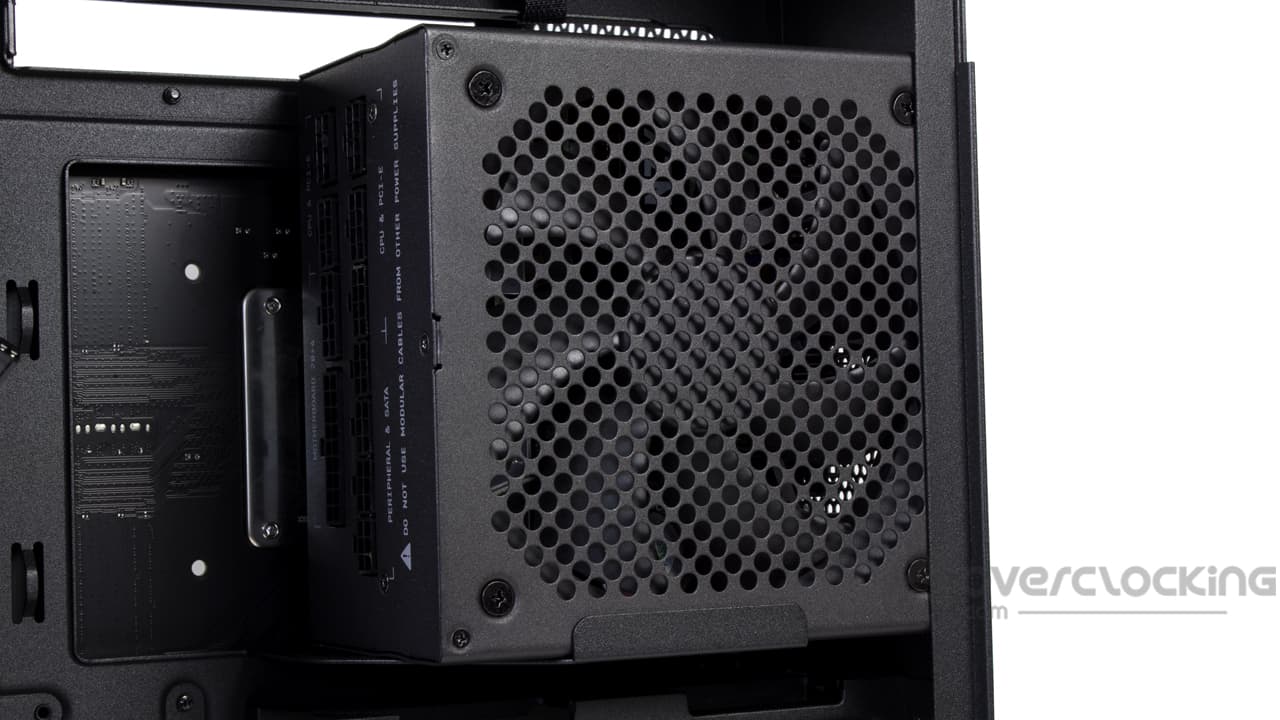

Power supply location:
NZXT H6 emplacement alimentation
The power supply location remains basic, with a simple steel bracket. Once again, there’s no device to dampen vibrations. Small rubber pads would have been welcome, especially as they cost very little to add.

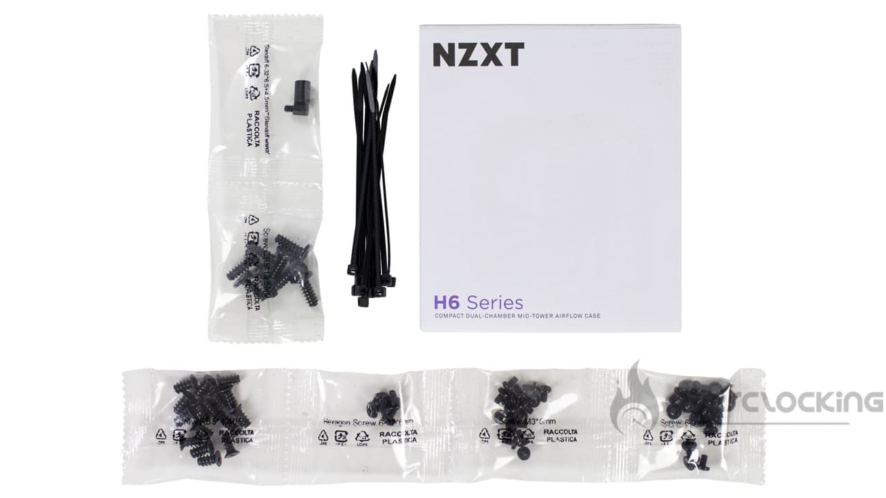

The bundle:
NZXT H6 bundle
Roughly speaking, the accessory section of this H6 Flow concentrates on the essentials, with :
  • Assembly instructions in leaflet form
  • Screws and bolts in individual bags
  • Nylon collars
In short, the bundle is as simple as can be, and focuses on the essentials. We have no additional accessories to help with assembly.

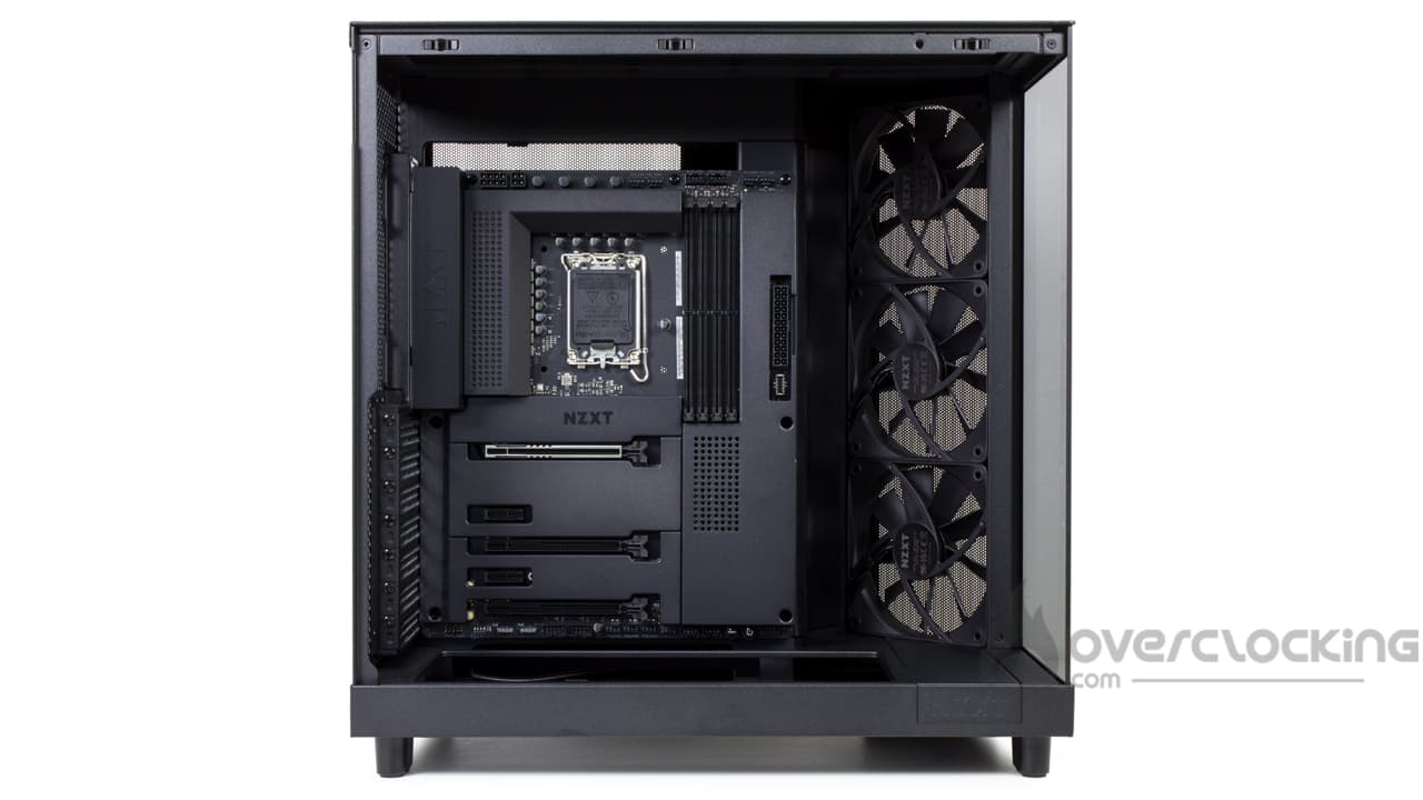

Installing the motherboard :
NZXT H6 Flow montage carte mère
Mounting our motherboard, an N7 Z790, is not particularly difficult, since, as you can see, its slot is particularly unobstructed. There’s plenty of room to manipulate it. What’s more, it’s surrounded by a number of cable passages, which are very practical for the management cable.

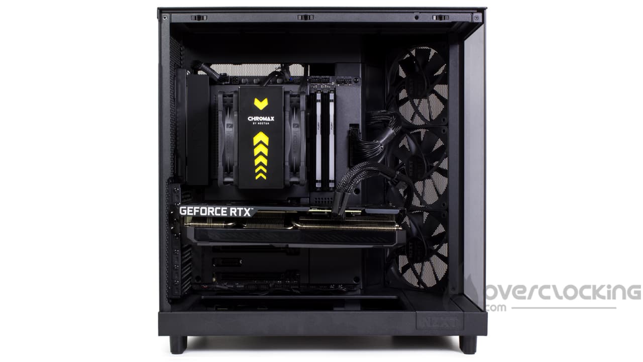

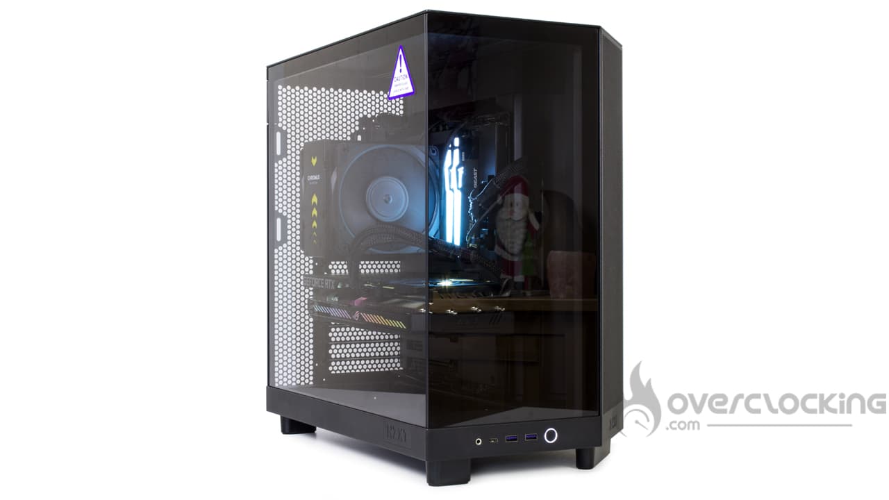

Overall:
NZXT H6 Flow montage final
Basically, assembling the configuration inside the case goes off without a hitch. Just bear in mind that, once in place, the power supply will completely obstruct backplate access to the motherboard. So either fit the motherboard and cooler before the power supply, or fit the CPU cooler to the motherboard before fitting everything to the case. Otherwise, the case is spacious, and the Velcro strips will help to secure the cables inside this H6 Flow!

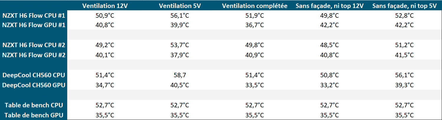

Airflow :
Résumé températures
This time, no graph, but a table to summarize the temperatures obtained, which lack coherence… At least for the GPU part.
As you can see, as the airflow inside the case increases, so does the temperature of our graphics card… But this is not logical. If we look at the results obtained inside a DeepCool CH560 Digital, as the airflow increases, the temperature of the GC decreases, but this is not the case here.
The only time temperatures drop with increased airflow is when two fans are placed in suction under the graphics card (survey #1). Otherwise, in the case of the second reading, temperatures rise slightly with one fan at the bottom, the other at the top in extraction.
On the CPU side, overall readings remain consistent, with low temperatures tending to rise as the speed of the three front fans is lowered. Removing the front and top panels also results in lower temperatures. The only inconsistency noted is with ventilation completed, which can be explained by the fact that the fans push the heat emitted by the GC into the processor area.

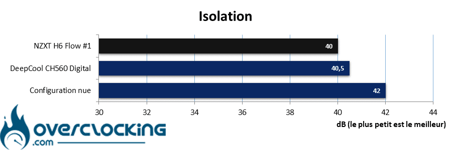

Insulation :

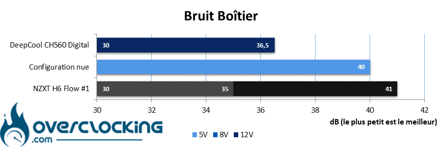

Here, we’re simply measuring the noise emitted by our configuration when running CPU cooling and GPU cooling at high speed.
Isolation
In terms of isolation, there’s no significant difference with DeepCool’s CH560 Digital… Except that it covers the noise emitted by our configuration a little better. We noted a 0.5 dB improvement. However, when compared with a benchtop configuration, the difference is a little more significant!
