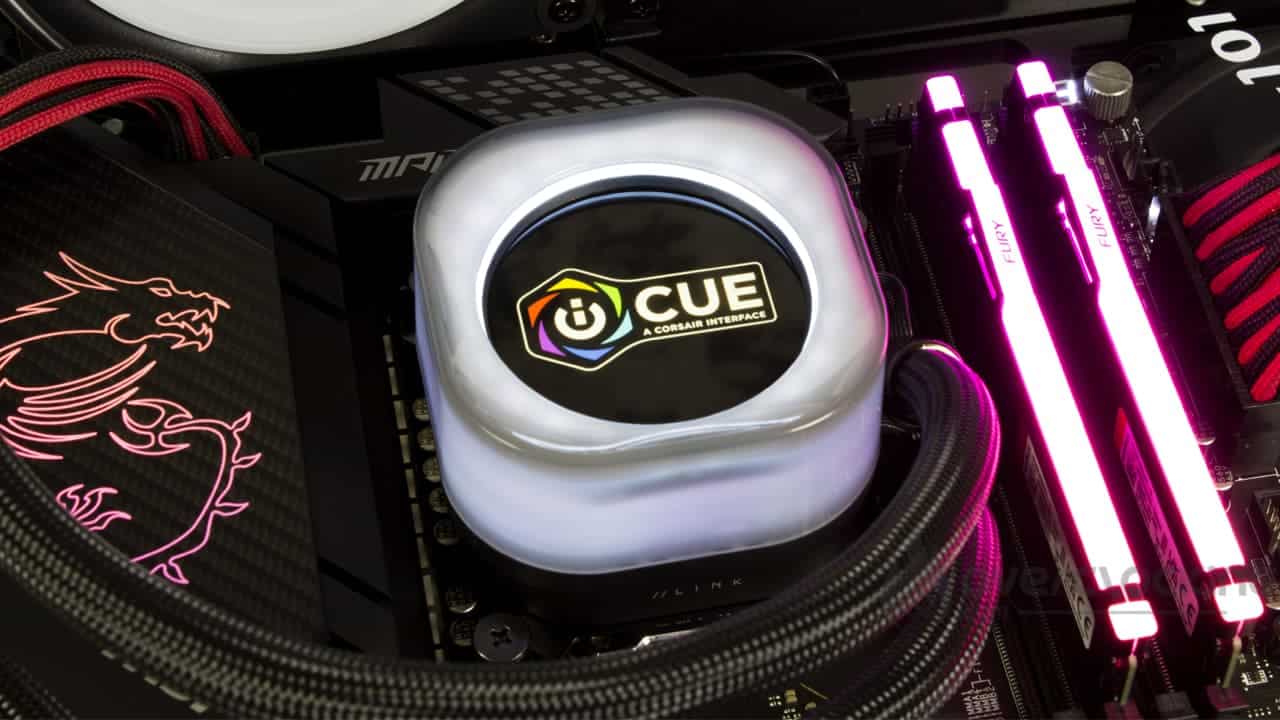

Assembling the iCUE Link H150i LCD :
In the case of the iCUE Link H150i LCD, mounting is identical to that of the H170i RGB from the same series. So, if you’re equipped with an AMD platform, you’ll need to start by removing the original (Intel) mounting arms. To do this, simply pull them out, then insert the AMD ones around the pump. Grooves simplify the operation.
Next, we place the multi-socket backplate on the back of the Intel board. As for the AMD motherboard, we’ll need to remove the original mounting arms. A large Phillips screwdriver will do the trick.
Once this second stage has been completed, the spacers need to be screwed into the four corners of the socket. Once the spacers are in place, there’s no need to apply thermal paste, as it’s already pre-applied to the base of the pump. All that’s left to do is place the whole assembly on the CPU and screw it in place using the nuts supplied.
