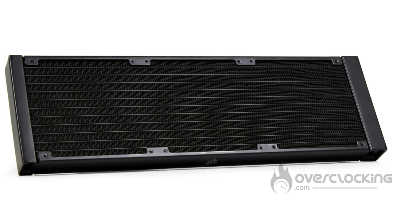

Radiator:
After reviewing the H170i RGB, the radiator on this 360 mm version looks tiny to us, but it’s not. Just a “bigger” habit. This translates into dimensions of 397 (W) x 120 (D) x 27 (H) mm. Here, the height is a standard 27 mm. Gone are the big radiators like the Arctic Liquid Freezer II in 38 mm.
Once again, there’s an imposing block between the tubes. This is the block to which the kit will be connected. It features two proprietary connectors linked to the iCUE Link system, plus a USB type C connector. The latter will be useful for connecting and powering the pump’s LCD screen.
Once again, the radiator is beautifully finished. The radiator features a neatly applied black paint finish. On the sides, unlike what NZXT can offer, there are no visible rivets or screws. Only the brand logo is present.
To connect the radiator to the pump, two 45 cm long tubes are used. These feature a nylon sheath for finishing, which is of the same type as that of the H170i. If it appears looser than on previous series, it’s because it’s also used to conceal cables, rather like Arctic’s Liquid Freezer II.

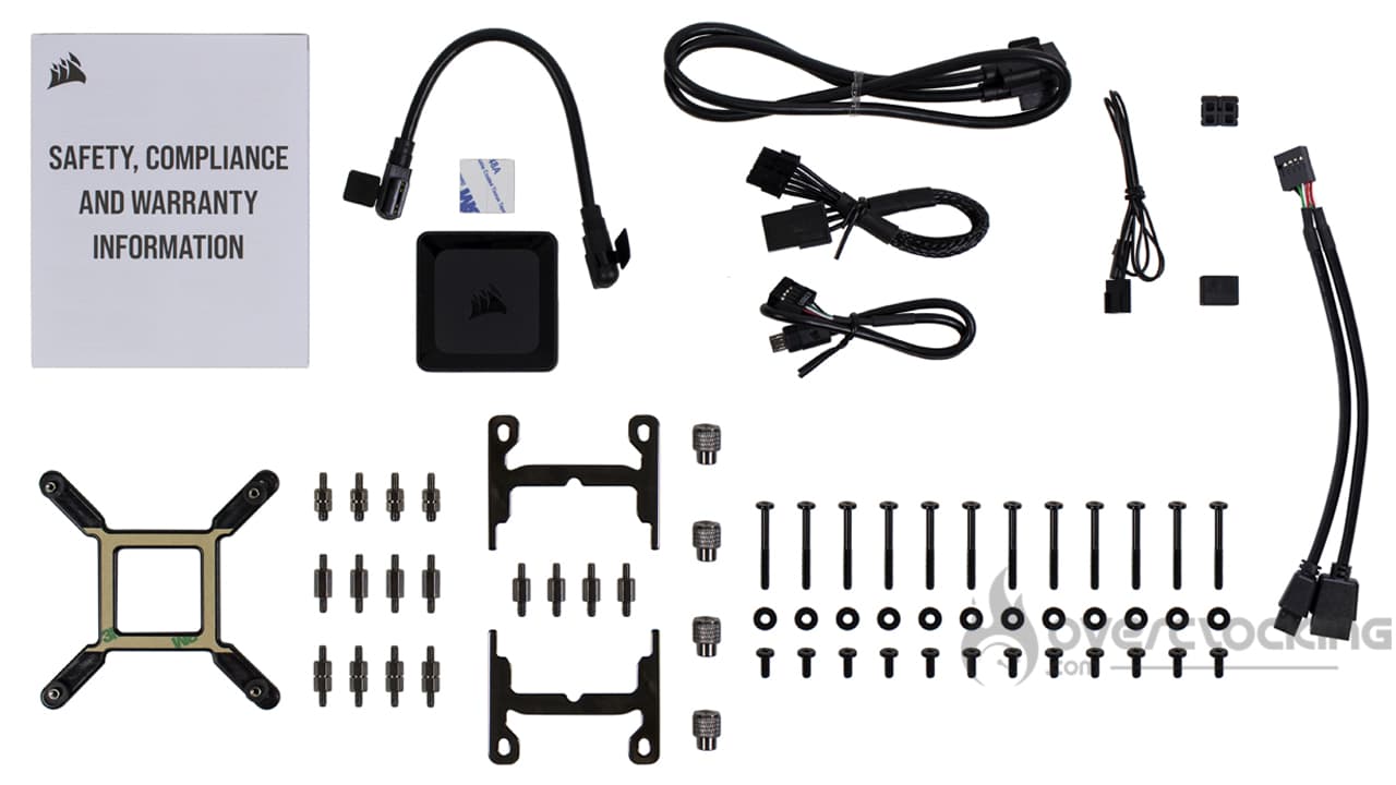

The bundle:
The accessory part arrives in various small plastic bags containing :
- A warranty guide
- A cable to connect the fans to the radiator
- ICUE Link hub
- A second cable to connect the radiator to the iCUE Link hub
- 6-pin PCIe power cord for the hub
- USB cable for connecting hub to motherboard
- Tachometer cable
- Connector bridge and shim (for fans)
- Metal backplate and screws for Intel sockets
- Mounting arms and spacers for socket AM4/5
- Fans/radiators screws and washers
- USB 2.0 dual header splitter
Once again, we find an accessory section offering everything you need to assemble the kit. This time, the splitter for a dual header 2.0 is supplied, as you’ll need to connect the screen to your motherboard in addition to the hub to benefit from all the kit’s features.
