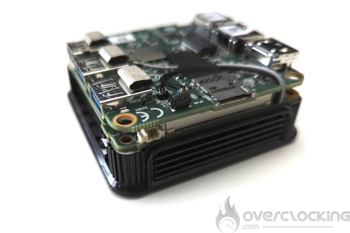

Disassembly is done by removing the 4 screws on the back of the device, once this is done, you will need to remove the top of the device. These screws are also used to apply pressure between the die of the processor and the cooling.
From a modification point of view, there is nothing we can do except replace the cooling system with a better one. Here, all elements are soldered to the PCBs. The PCBs are connected to each other in sandwich mode to save space.

Inside, once everything is disassembled, we have access to the cooler. It is a piece of cast aluminum overhung by a fan. There are off-set fins through which the air blown by the fan passes. The interface with the processor and the memory is done via thermal pads, the pressure applied here to maintain them in contact comes from the screws on the bottom of the device.

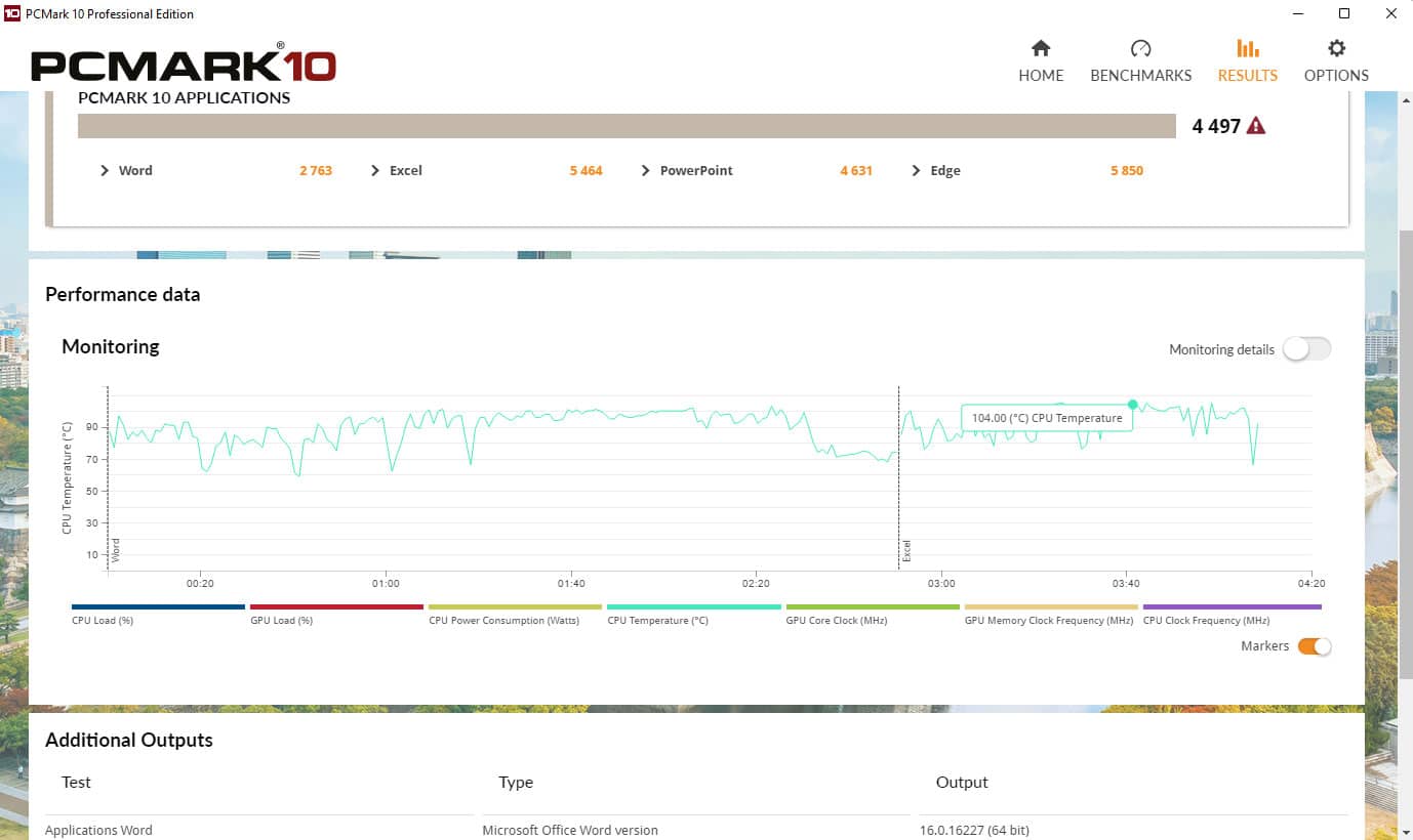

Concerning the heating, it is not at all mastered. Here, the simple fact of launching a benchmark on Excel, Word and Powerpoint generates a heating and an increase of the ventilation not very pleasant. We reach 105°C on the processor on Excel, Cinebench R15 or even Geekbench 3. In IDLE we are around 60°C. The device heats up a lot and this is in no way related to its performance.

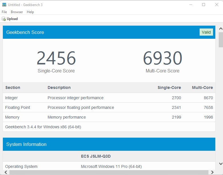

On Geekbench 3, the performance is once again very disappointing. Here, even a Ryzen 3 1200 shows almost twice the performance.

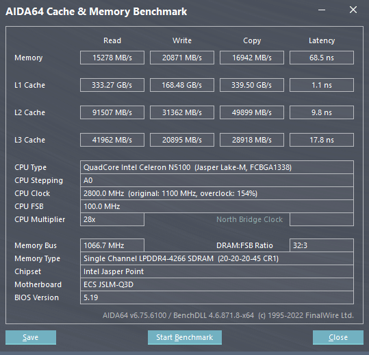

For AIDA64, we look mainly at the RAM and here the performance is disappointing. High latency and extremely low. Although the memory is given for 4266 Mt/s, the performance is actually closer to 2133 Mt/s in single channel.

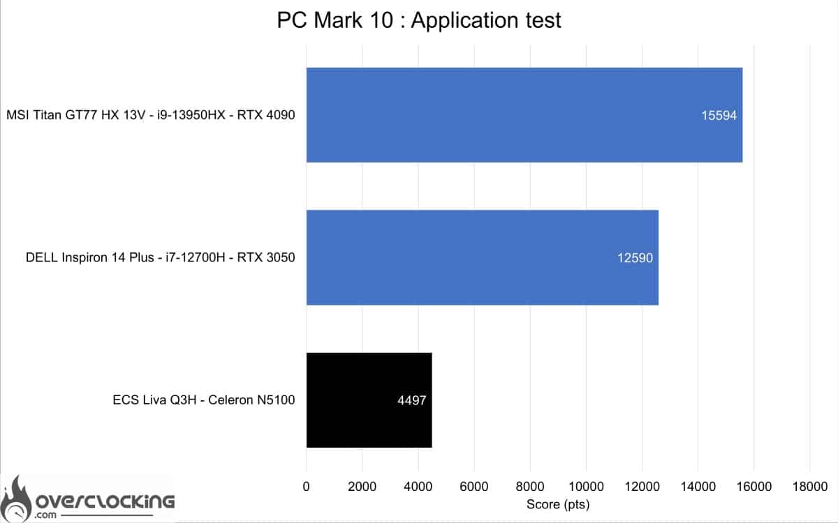

The benchmark presented here uses the Microsoft office suite to give us the performance of our machine on Word, Excel and Powerpoint. This is the most impactful negative point. Because here the N5100 combined with the 4 Gb of RAM do not even manage to make more than 5000 points on this benchmark. Considering the target of such a product, we would have liked at least 10,000 points.
