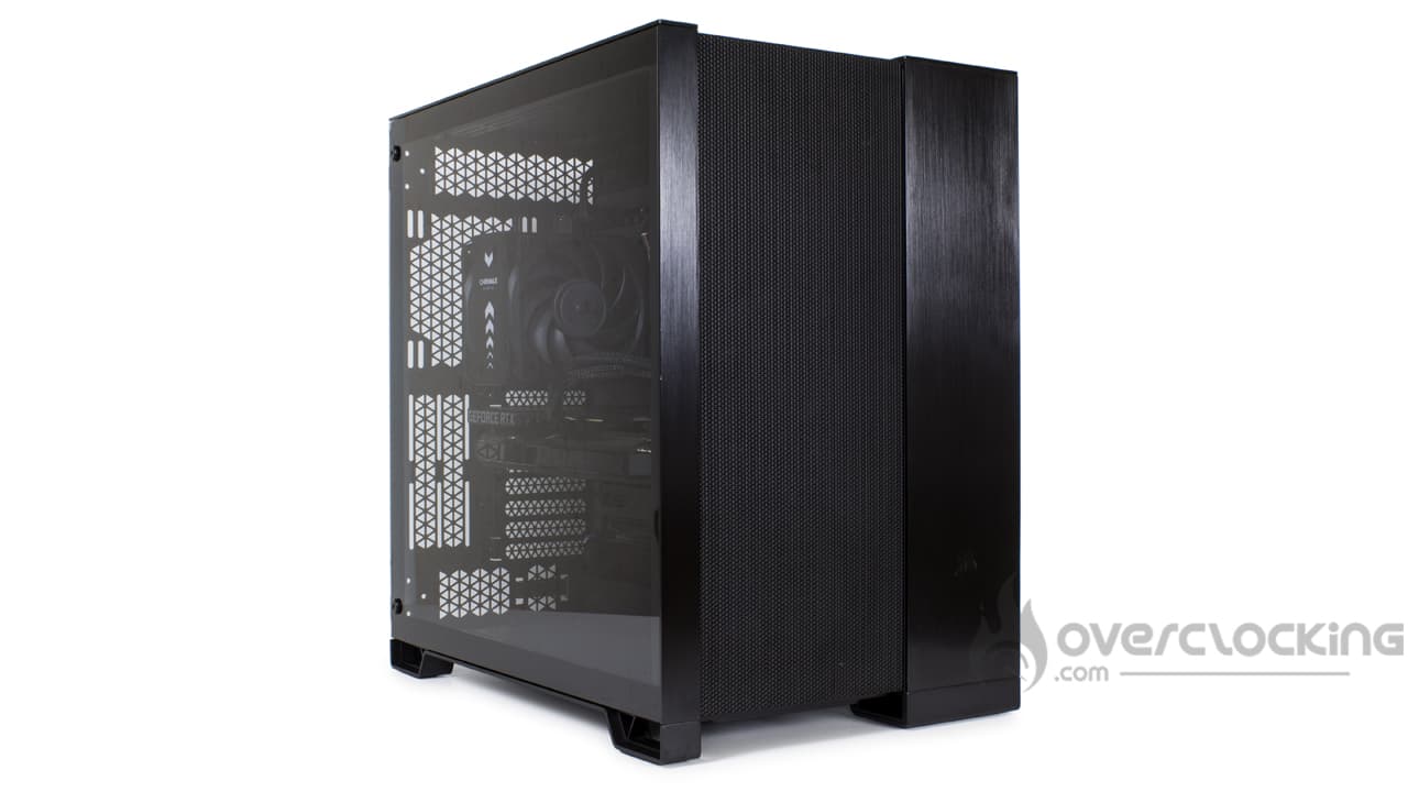

The exterior of the 6500D Airflow :
Corsair’s case is a rather imposing mid-tower reference. Due to its particular design, the case is rather wide at 328 mm. In terms of length and depth, this model remains under the 50 cm mark: 481 (W) x 496 (H) mm. However, what really shocks is the weight: 16.9 kg empty. It has to be said that this model features particularly thick steel parts on the front and top, which can be replaced as we’ll see later.
In terms of design, we find a sober case with a mesh grille on the front surrounded by black-painted steel parts. Note that this model is also available with a tempered glass front named 6500X.
In terms of price, the average retail price for this case is €195. Clearly, it’s expensive and positions it in the high-end sector.

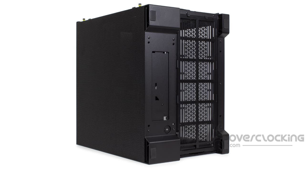

Rear:
Corsair 6500D Airflow arrière
At the rear, we have a rather unusual layout. On the left-hand side, at the very top, is the first grille, held in place by a hand-tightened screw. This hides the hard disk cage and the two baskets it contains. Just below, vertically, we find the power supply.
On the right-hand side, we begin by mentioning the presence of a first grid at the top, followed by the motherboard’s I/O Shield slot and a 120/140 mm fan slot. Just below this are eight open-work expansion slots with a tiny Velcro strip at the bottom. These will be used for cable management.

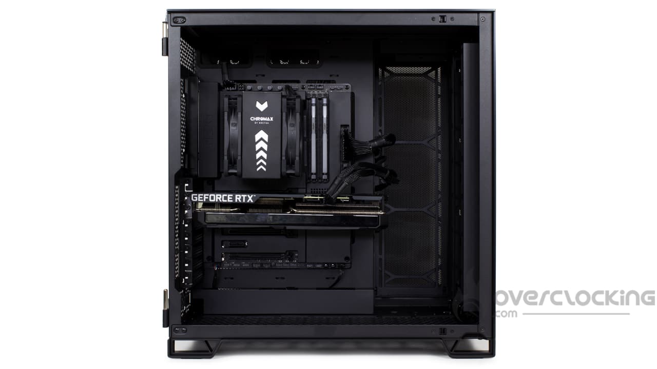

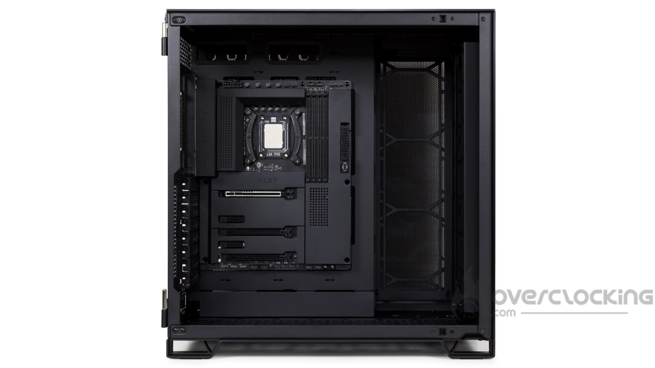

Inside the 6500D Airflow :

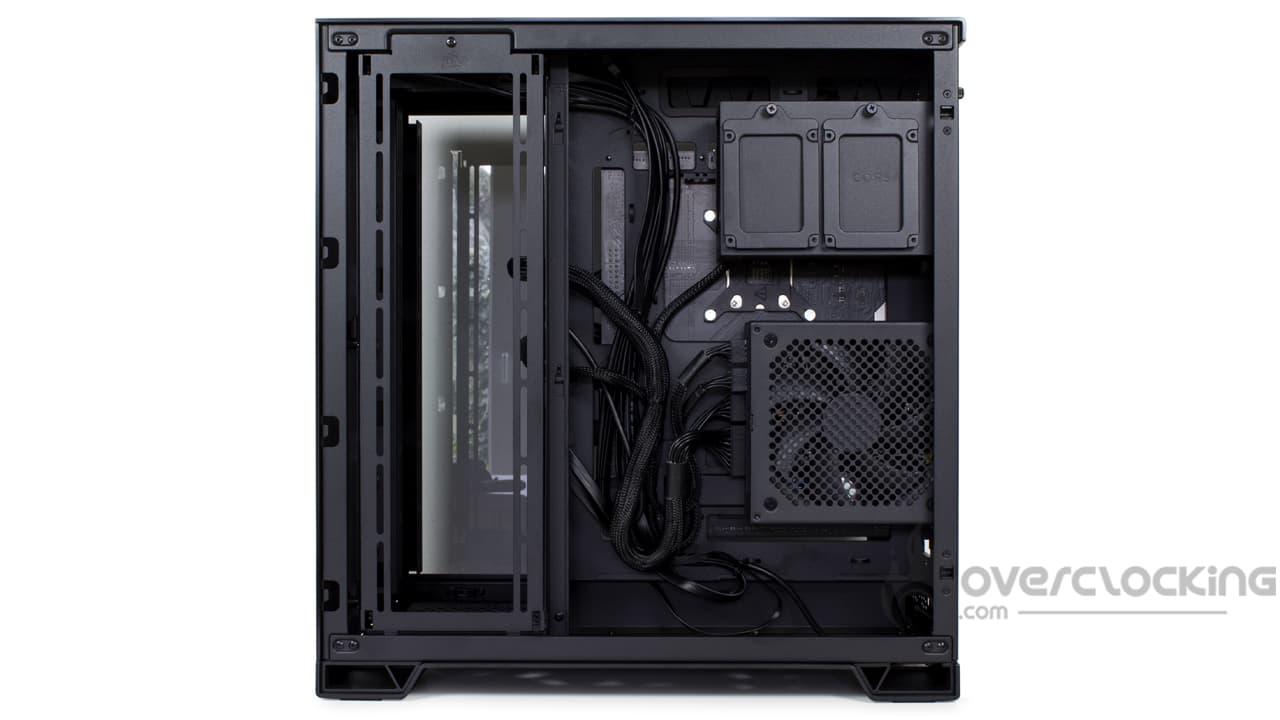

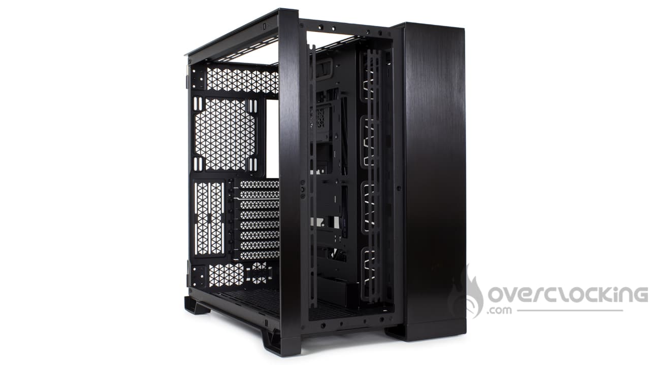

Opening the case is pretty straightforward, since the side glass is simply hinged and held in place by a push-pin system. This system is more or less the same as Antec’s P120 Crystal. However, we would have appreciated a system without visible screws to hold the glass in place.
As for the rear panel, it is secured by two hand screws, while being held in place by a push-pin system.
The chassis :
Internally, there are numerous openings on the motherboard tray. As you can see, there are the classic openings for cables. However, additional openings are provided for motherboards from the ASUS BTF series (TUF Gaming Z790-BTF & Maximus Z790 Hero BTF) and MSI’s Project Zero series (Z790 Project Zero).
Out of the box, this model is compatible with 30.5 cm-wide ATX and E-ATX motherboards.
At the rear, the presence of the power supply means there’s plenty of space. Clearly, cabling won’t be a problem, although no guides or Velcro strips are included as standard.

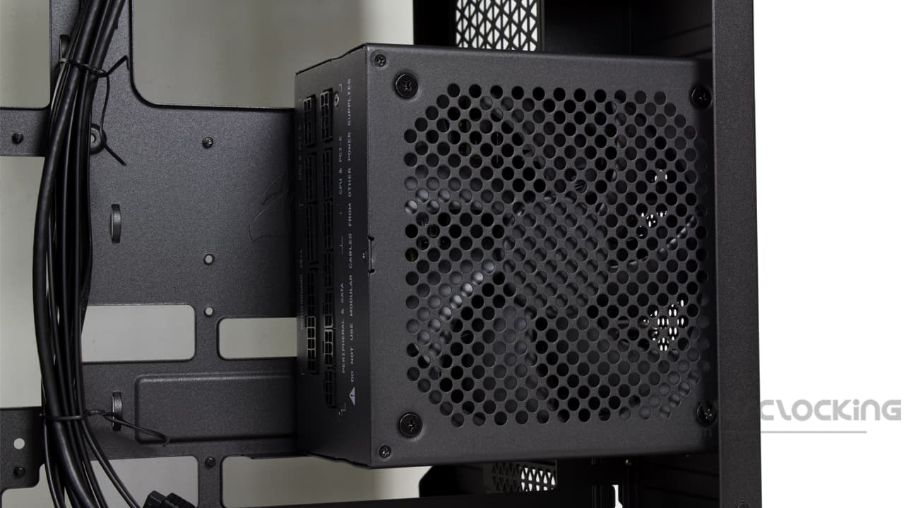

Power supply location:
Corsair 6500D Airflow emplacement alimentation
For the power supply, we can count on a vertical slot for an ATX-format block. In length, we’re comfortable, unless you opt for particularly imposing blocks like the Dark Power Pro 13 from be quiet! for example. No, on reasonable models, there’s no question.

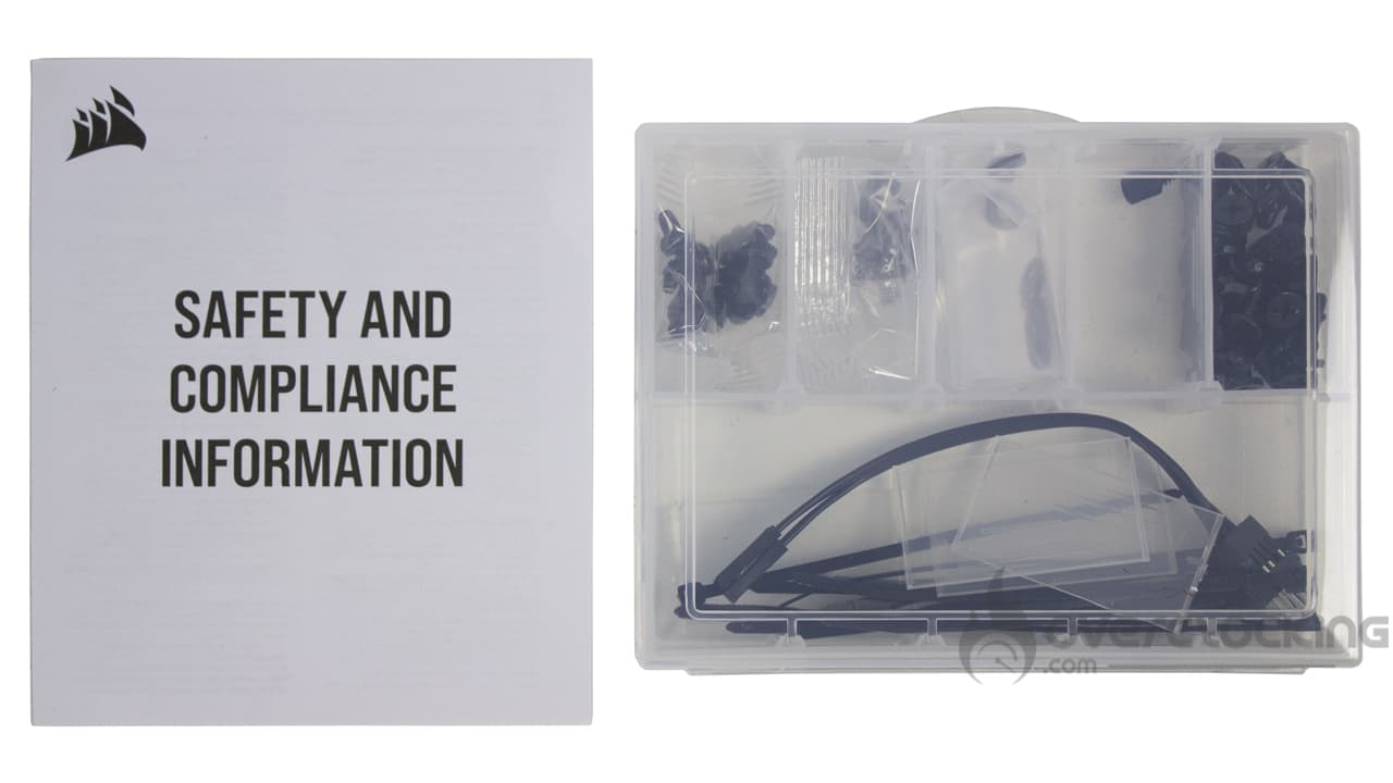

The bundle:
The accessory section features:
  • A simple warranty guide
  • A rigid box including screws, nylon cable ties and an adapter for the F_PANEL header.
Once again, we’re pleased with Corsair’s choice, as it keeps the case’s screws and bolts neat and tidy. Unlike other brands which opt for plastic bags to be torn open, that after three uses, there are everywhere and we no longer know who does what.

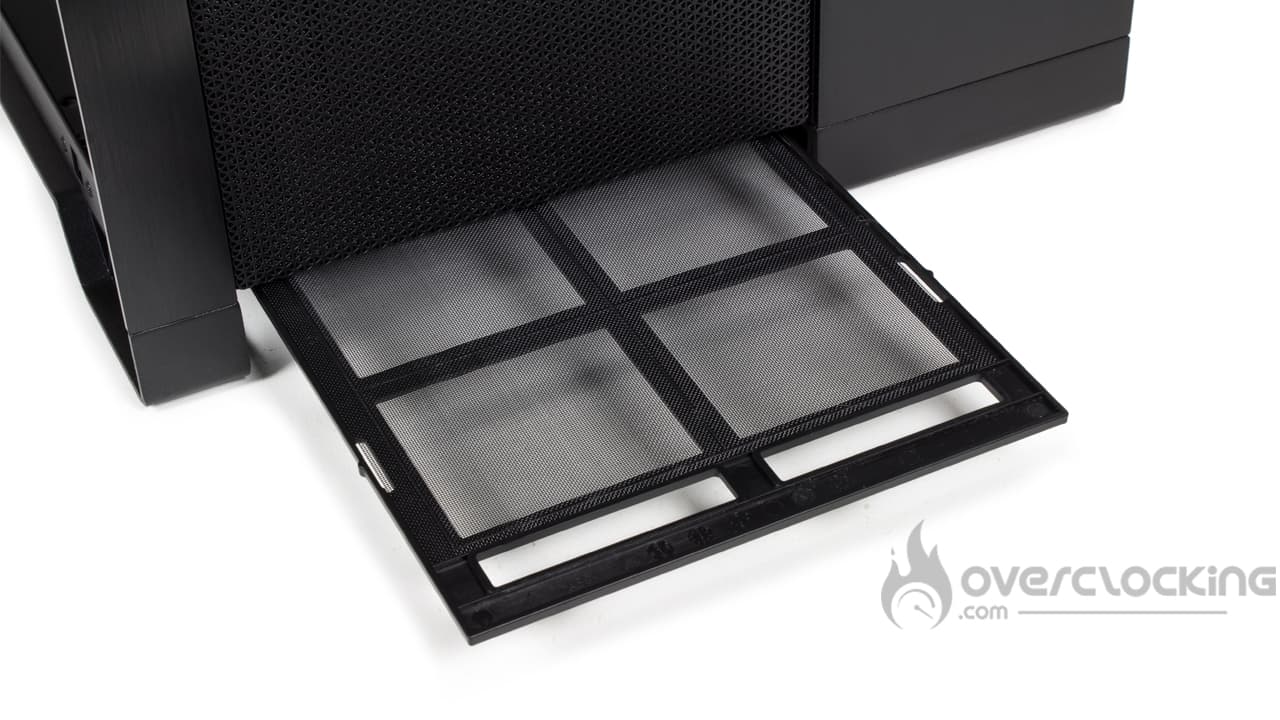

The little details:
Corsair 6500D Airflow filtre
In itself, the 6500D Airflow’s functionalities are fairly limited, with little more than a dust filter accessible from the front of the body. It’s silly when you put it like that, but not many references can boast that.
Otherwise, the side plate supporting the fans and watercooling radiator is removable. Rather practical for mounting the latter.

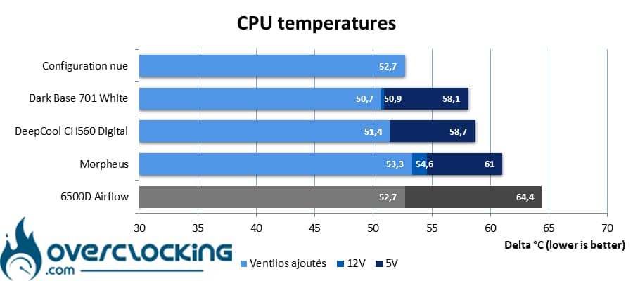

CPU airflow, original ventilation then completed:
We start with the temperature of our CPU. We’ll keep the front and top of our test case. Let’s see if the airflow is sufficient to influence the cooling of the Ryzen 5 3600X.
Since the case has no fan as standard, the graph shows only two bars. Meanwhile, by default, our CPU is hotter than when mounted in rival cases. This is to be expected, given the absence of a standard fan.
Finally, mounting fans inside this 6500D Airflow, we get temperatures on a par with the competition, although the Dark Base 701 fares better!

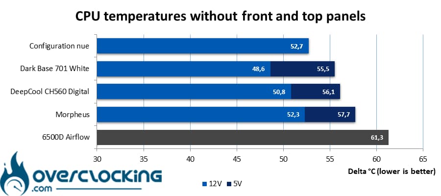

Original CPU airflow ventilation without front panel or top :
In order to ascertain the limiting factor in the story (and to what extent), we remove the top covers while we remove the bottom dust filter. The aim here is to show the raw performance of the built-in ventilation… Or to see how well the case keeps the heat in, since there’s no basic built-in fan in this 2500X.
Although there is no standard fan, it’s hard to know whether the front panel interferes with fan airflow or not. On the other hand, it seems to breathe well, given the small difference in temperatures measured with and without the front panel and top panel.

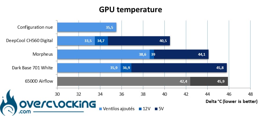

GPU airflow, original ventilation then completed :
We repeat the operation, but with measurements taken on the graphics card. Here, we test with original ventilation, then supplemented ventilation.
On the graphics card side, we find something rather surprising: our RTX 3050 is maintained at the same temperature level in this 6500D Airflow as in a Dark Base 701 from be quiet! However, by default, the graphics card took little advantage of the airflow provided by the case’s basic ventilation. The front fan was mounted quite high.
By adding ventilation, the temperature of the graphics card is reduced, but not by that much. Did we position the fan too high? Possibly.

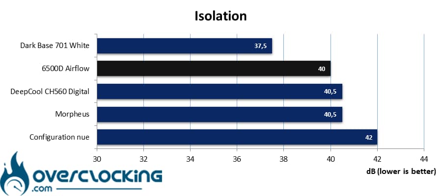

Insulation :
Here, we’re simply measuring the noise emitted by our configuration when we run the CPU and GPU cooling very fast.
As far as insulation is concerned, it’s a case in the middle of the pack, with 40 dB measured. For the moment, the Dark Base 701 is the model that fares best, with 37.5 dB.

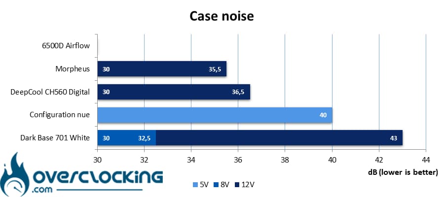

Original fan noise:
This time, we measure the noise emitted by the case’s original fan. To do this, the configuration is run in idle mode ( CPU and GPU ventilation at minimum), while readings are taken successively at 5V, 8V and 12V on the case ventilation.
Without default ventilation, and with the fan speed of our graphics card and cooler set to minimum, it’s logical to have a noise level at the daisy chain: 30 dB.
