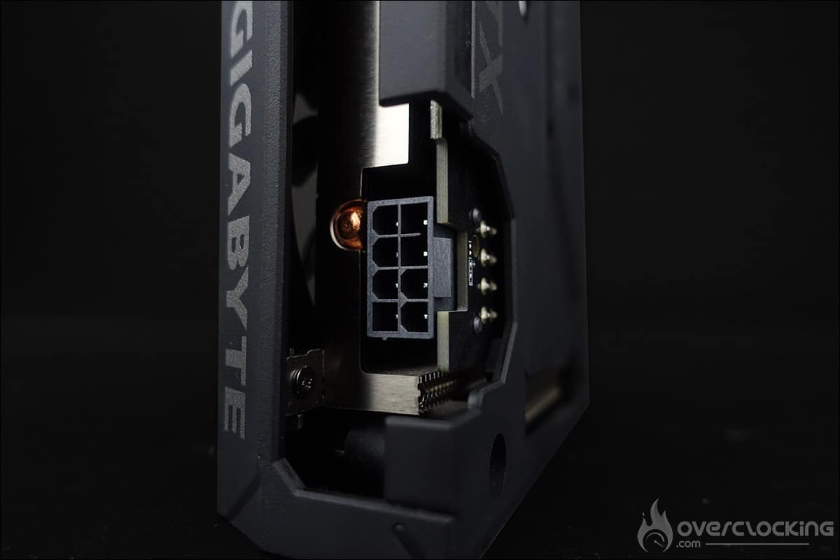

There’s nothing in the bundle other than a quick installation guide. The absence of a 12 4-pin adapter seems to confirm that Gigabyte has chosen to retain a “traditional” power connector.

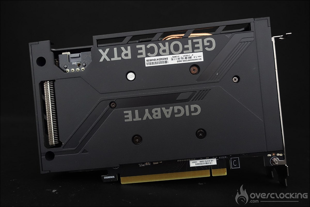

The black plastic casing encloses the slightly shorter PCB, and bears the Gigabyte GeForce RTX lettering on the top edge. The finish of the plastic shell is quite good for an entry-level card, and the fairly neutral aesthetic should suit many users. Gigabyte, surely for financial reasons, does without RGB backlighting here.

Let’s get down to disassembling the board’s cooling system. This is secured by six clamping points. The usual four around the graphics chip, but also two more around the power supply stages. This ensures optimum retention of the cooling system.
The aluminum radiator responsible for keeping the various PCB components cool is traversed by a single 6 mm heatpipe, which seems a little light to us all the same. This is in direct contact with the graphics chip. It’s a cooling system we’ve already encountered at Gigabyte on entry-level graphics cards. Memory chips, the power supply stage and certain PCB chips are covered with thermal pads to ensure heat dissipation.

The traditional 8-pin connector is used to power the board. Finally, the board’s video outputs include two DisplayPort 1.4a and two HDMI 2.1a ports.
