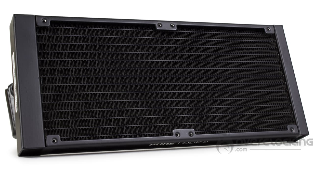

The radiator:
The radiator is a classic block. It features an aluminum construction. It is a little larger than a 240 mm model, measuring 317 (W) x 140 (D) x 27 (H) mm. The thickness is therefore quite standard. However, being wider, it also offers a higher-than-average number of channels: 14 versus 12 for a 240 mm kit.
On the other hand, the finish is quite satisfactory, since the radiator is square in shape. The ” Pure Loop 2 ” branding on the edge is a reminder of the kit’s series. Otherwise, an attractive matt black paintwork finish is carefully applied, while the filler hole is located at the end of the radiator.

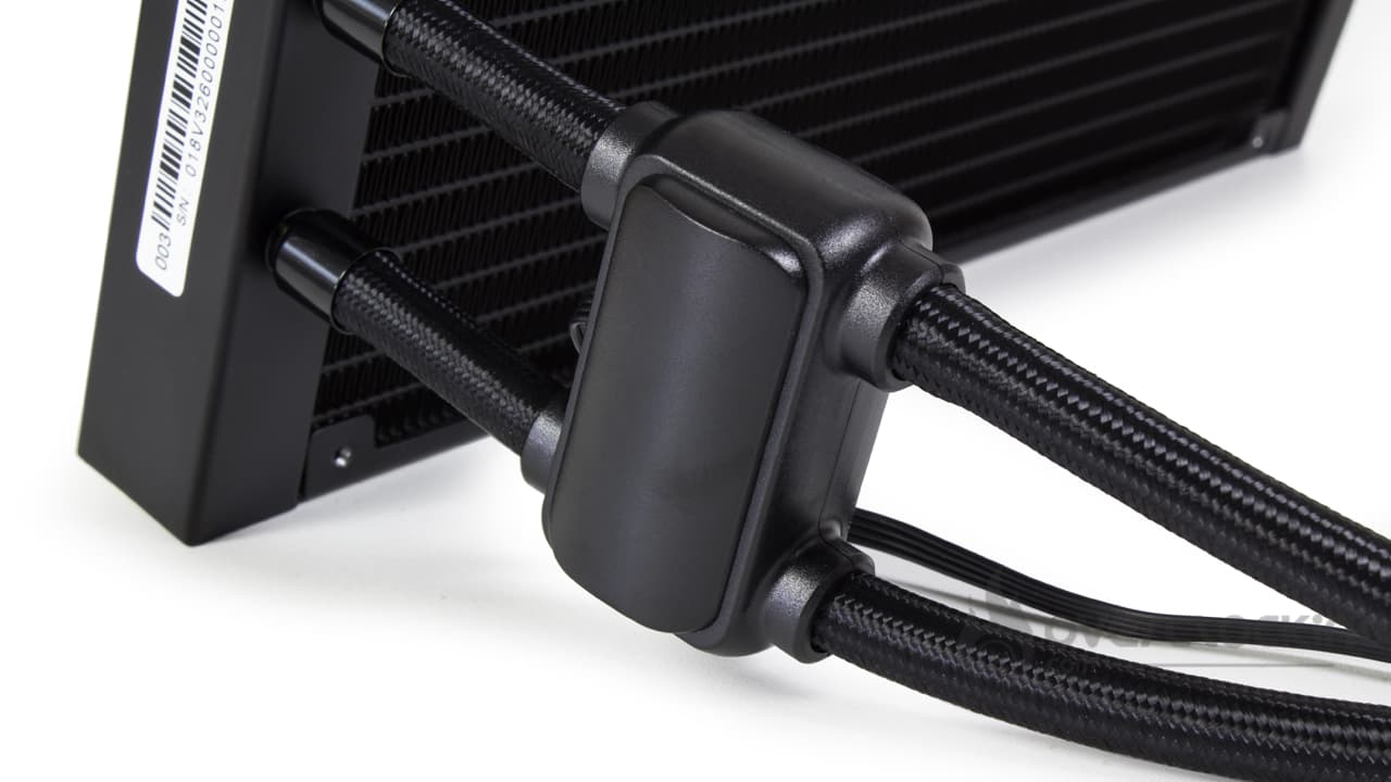

The connection to the waterblock is provided by two pipes measuring some forty centimetres in length. To ensure a high level of finish, we use an attractive black nylon sheath. As for flexibility, this is quite satisfactory and will not hinder installation in a housing.

However, as we said, this block has no pump, as the latter is taken from the kit’s tubes. As you can see, it will leave a massive protrusion at pipe level. Once again, not all its characteristics are known, but we do know that it will operate at up to 5500 rpm. Via its PWM power supply, it will be possible, if desired, to lower its speed to 4000 rpm.

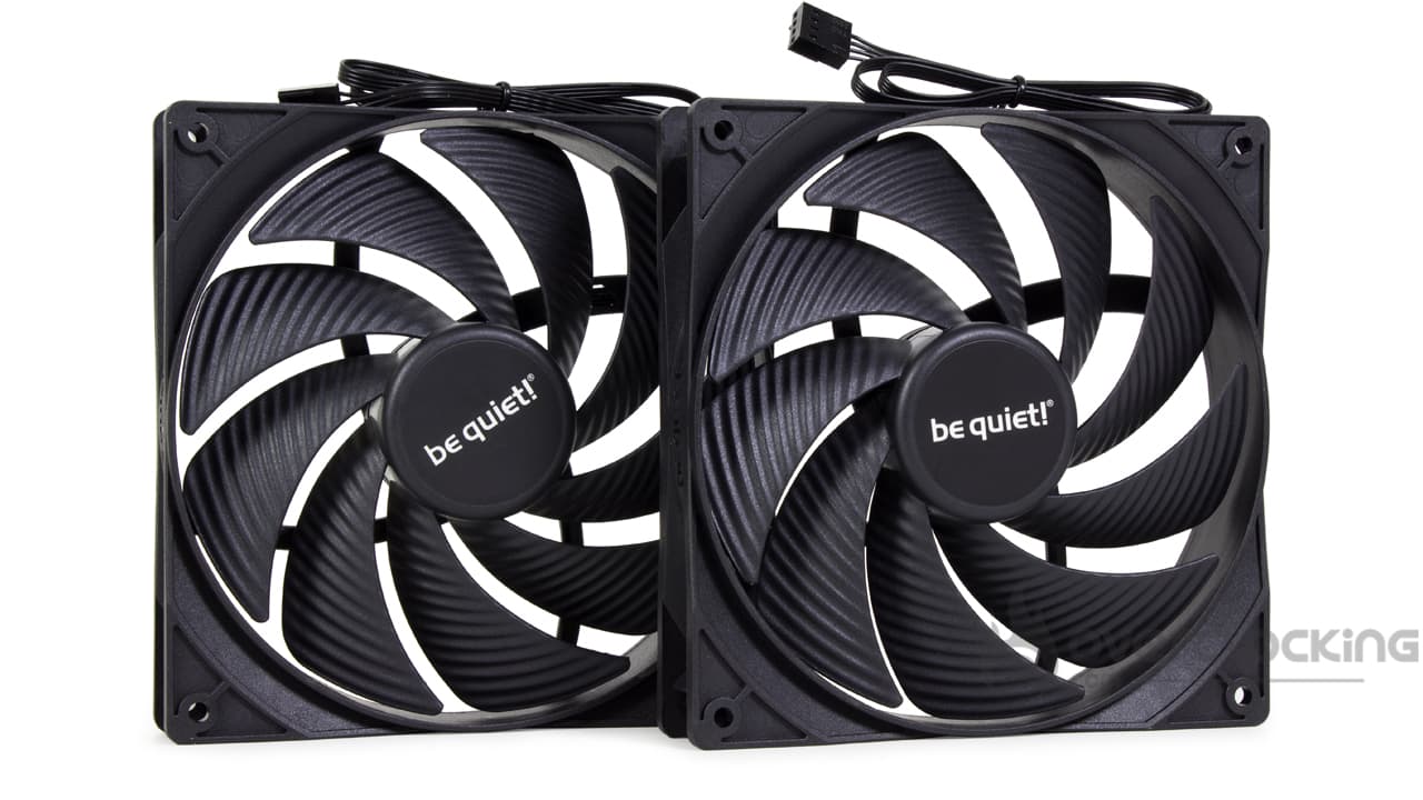

Fans:
With a 280 mm radiator, this kit comes with two 140 mm fans. This time, we’re talking about new Pure Wings 3 fans. From a visual standpoint, we find some of the distinctive elements of the brand’s fans, such as the ribbed blades. However, unlike the second-generation Pure Wings, these are now more curved and, above all, wider.
As for the frame, we’re dealing with something basic with a square frame. However, there are no rubberized silentblocks to reduce any parasitic vibrations generated when the mill turns.
At present, the full specifications are not known, we just know that they will operate at 1800 rpm and that’s all. No information as to static pressure or airflow is communicated.

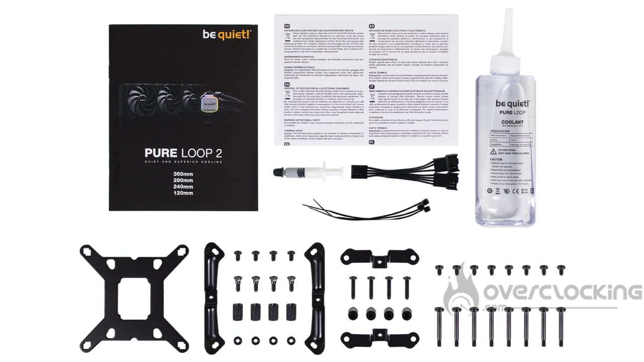

The bundle:
The accessory section is housed in a small cardboard box, so let’s take a look at what this Pure Loop 2 280 has to offer:
- Assembly instructions
- A warranty guide
- A bottle of liquid for topping up
- A syringe of thermal paste
- 2 -> 1 splitter
- Intel multisocket metal backplate
- Intel mounting arms and hardware
- AMD mounting arms and hardware
- Screws and bolts for fan and radiator mounting
The accessories section is therefore complete. In addition to the pump and heatsink mounting hardware, be quiet! also supplies the necessary fan and fluid connections. This is a welcome addition to extend the life of the kit.
