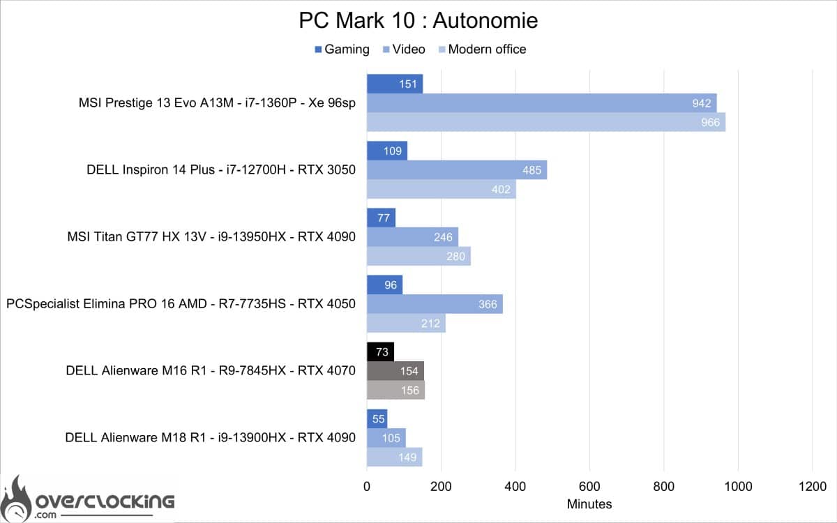

Battery life was measured using PCMark10’s built-in battery benchmark. The modes tested were video, productivity and gaming. Power management remained in normal mode and the GPU in hybrid mode. Screen brightness was set to 200Cd/m² without HDR, and sound was output via headphones plugged into the M16 R1’s jack.
As we can see, we’re not dealing with a champion of autonomy, in fact it’s rather disappointing on this point, once again we have a Dell Alienware at the bottom of the ranking. There may well be a problem here.
