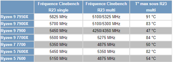

We thought it would be interesting to provide you with a summary table of the real frequencies we found during our tests. You will be able to better understand the results on the following pages.
As you can see, the frequencies of the Ryzen 7000X processors are much higher and will consequently give higher scores in the benchmarks against the non-X Ryzen 7000 with the same number of cores and threads. Temperatures will also be quite different, as a higher voltage is needed to hold these higher frequencies. No doubt we will also be looking at the differences in power consumption between these processors.
