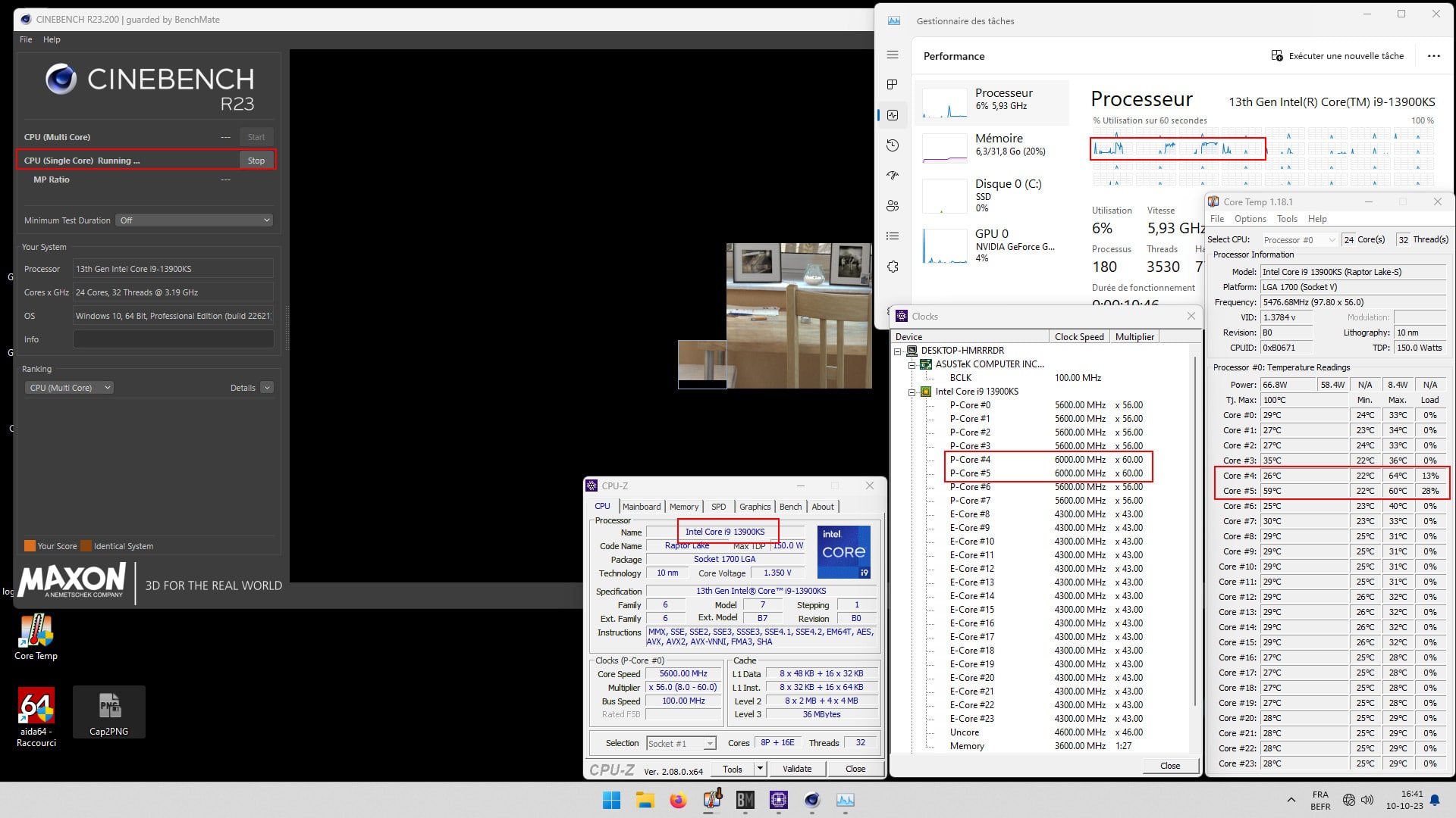

In single-core mode, we can see that cores #4 and #5 reach a frequency of 6000 MHz, which is in line with Intel’s claims. The temperature of the two cores alternating at 6 GHz is 60 and 64°C, while the others are not used.

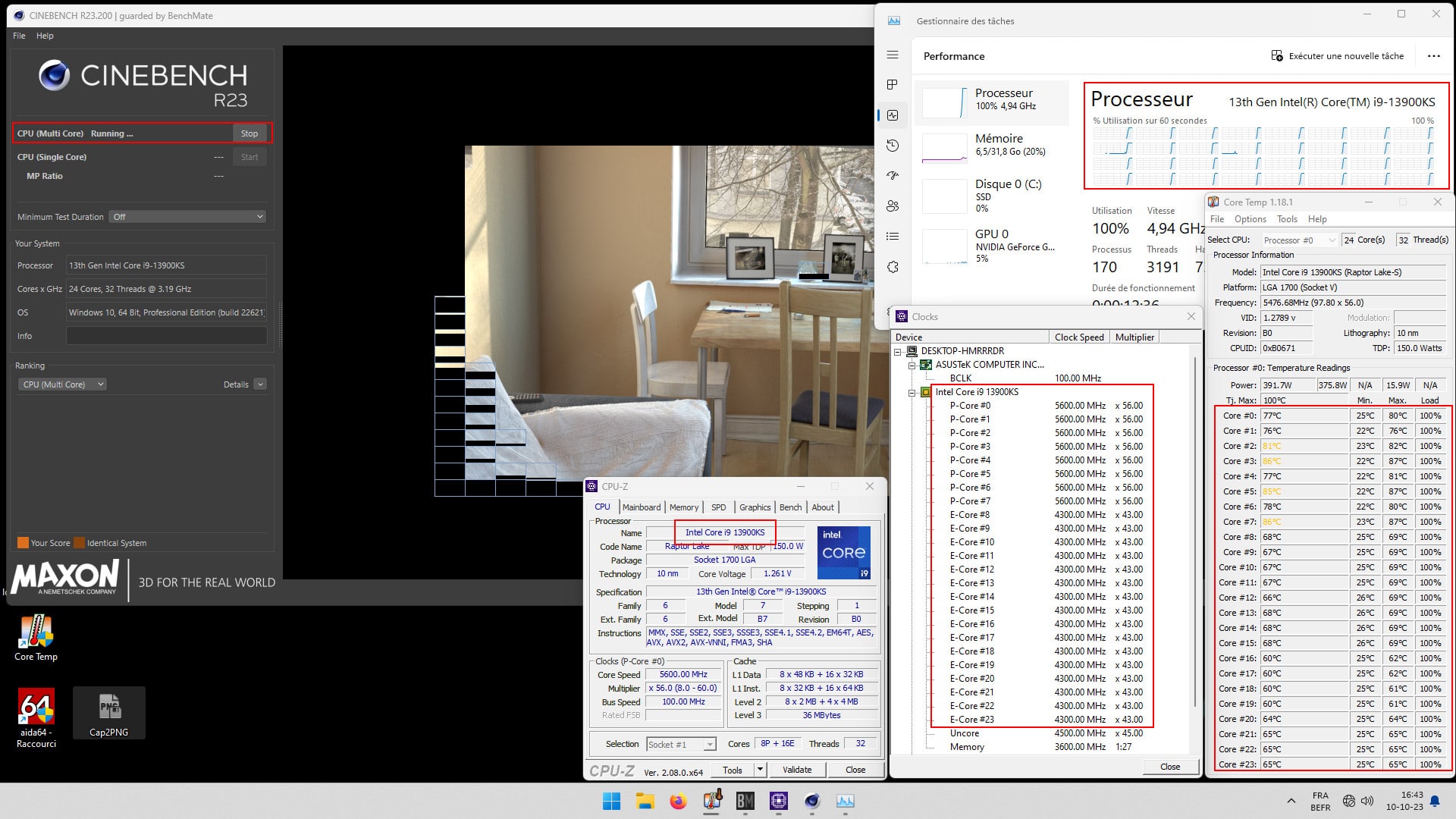

When the 24 cores of our i9-13900K are called upon, the frequency is fixed at 5.5 GHz on the P-Core and 4.3 GHz on the E-Core. The temperature of the hottest P-Core is 87°C, while that of the E-Core is 69°C. Let’s not forget that we’re equipped with a 480 mm custom cooling loop. In other words, if you opt for this processor, you’ll need at least a high-performance 280/360 mm AIO.
