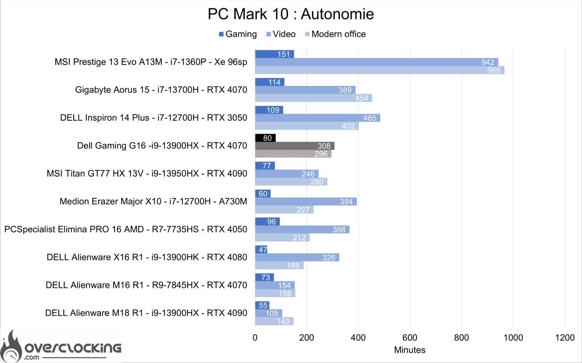

Autonomy
Device autonomy was measured using the PCMark10 integrated battery benchmark. The modes tested were video, productivity and gaming. Power management remained in normal mode and the GPU in hybrid mode. Screen brightness was set to 200Cd/m² without HDR, and sound was output via headphones plugged into the laptop’s jack.
As we can see, we have here a good student in the gaming laptop category, with almost 5h in video mode and almost 1h20 in gaming, this G16 is a real nomad laptop for gaming and why not for work?
