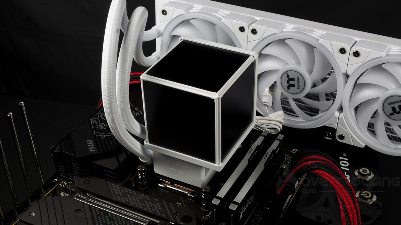

At present, this MineCube 360 Ultra aRGB Sync is the only representative of its kind, since the kit is currently only available in 360 mm. Therefore, it will not be possible to acquire it in 240/280, or even 420 mm for the time being. It remains to be seen whether Thermaltake will offer other versions in the future. In the meantime, two colors are available: white and black. As you can see, the brand sent us a white copy!
Well, there’s no need to beat about the bush, since the number-one attraction of this kit is its pump cover, which was the talk of the town at Computex. It features four 3.95″ LCD screens, each with 720×720 resolution, so you can manage each one independently or apply a single visual to all screens. The choice is yours!
Otherwise, the kit comes with a trio of Swafan EX aRGB fans. These feature interchangeable blades. So, whatever the position of the radiator in your case or the configuration of your airflow, you’ll always have aesthetically pleasing fans (blades never visible). They also benefit from a frame connection system with magnetic connectors to limit the number of cables in the PC.
Aesthetics aside, the kit’s pump features a pump fan concealed beneath the screen unit. Its role will be to cool the elements located around the socket: RAM, motherboard VRM heatsink, etc. Otherwise, the pump block features a copper cold plate, but the brand doesn’t dwell too much on these elements. Instead, the emphasis is on the set of screens mounted on the pump.
Thermaltake MineCube 360 Ultra aRGBOn the other hand, a kit of this scale is anything but cheap. The official price tag is $369.90. That’s right at the top end of the market. Besides, who can boast of offering an AIO with four screens?

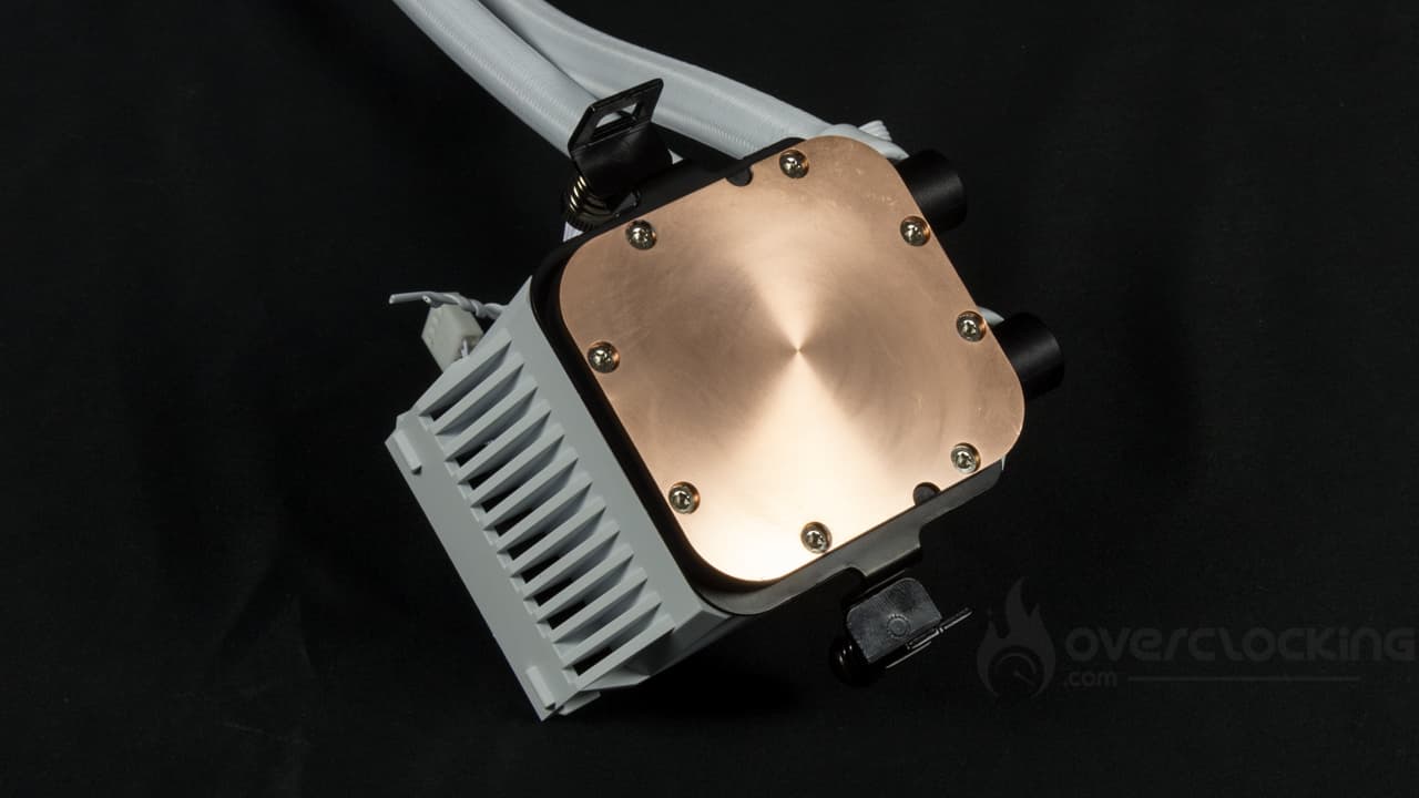

The pump:

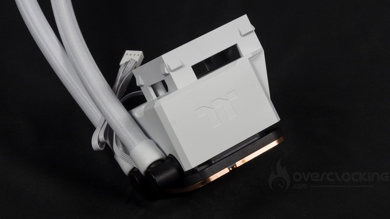

For its part, the pump unit, without the screen unit, offers quite reasonable dimensions, measuring 72 (W) x 72 (D) x 62 (H) mm… Approx. Once again, Thermaltake does not disclose the dimensions of its pump. However, when the display unit is fitted, things take a completely different turn. The unit is 88 mm square and 143 mm high. Clearly bigger than some air-cooling fans, a Pure Rock Slim 3 is less tall.

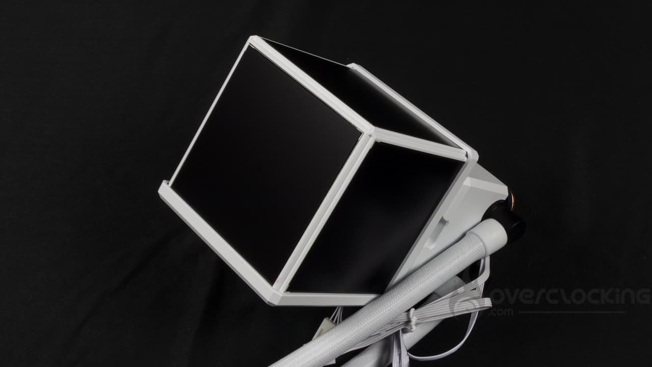

The pump cover then integrates four screens featuring a 3.95″ diagonal. Resolution is 720×720 px. However, the brand does not communicate on display frequency or brightness, for example.

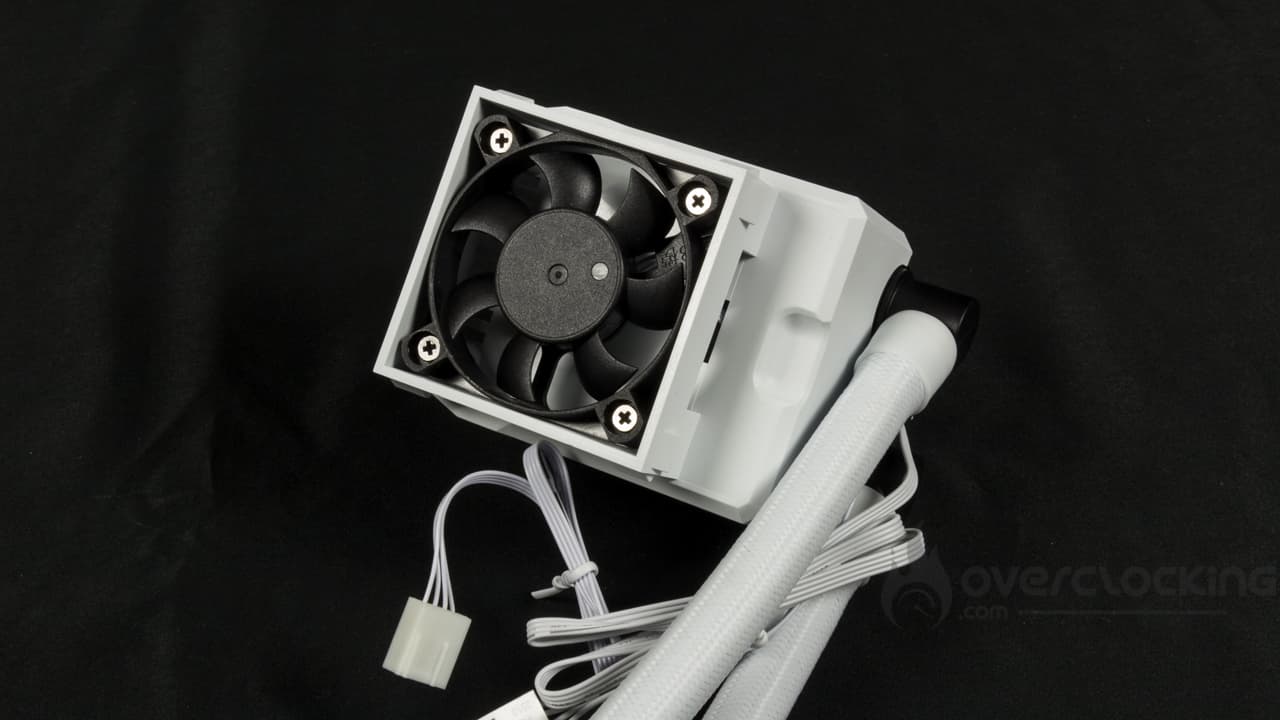

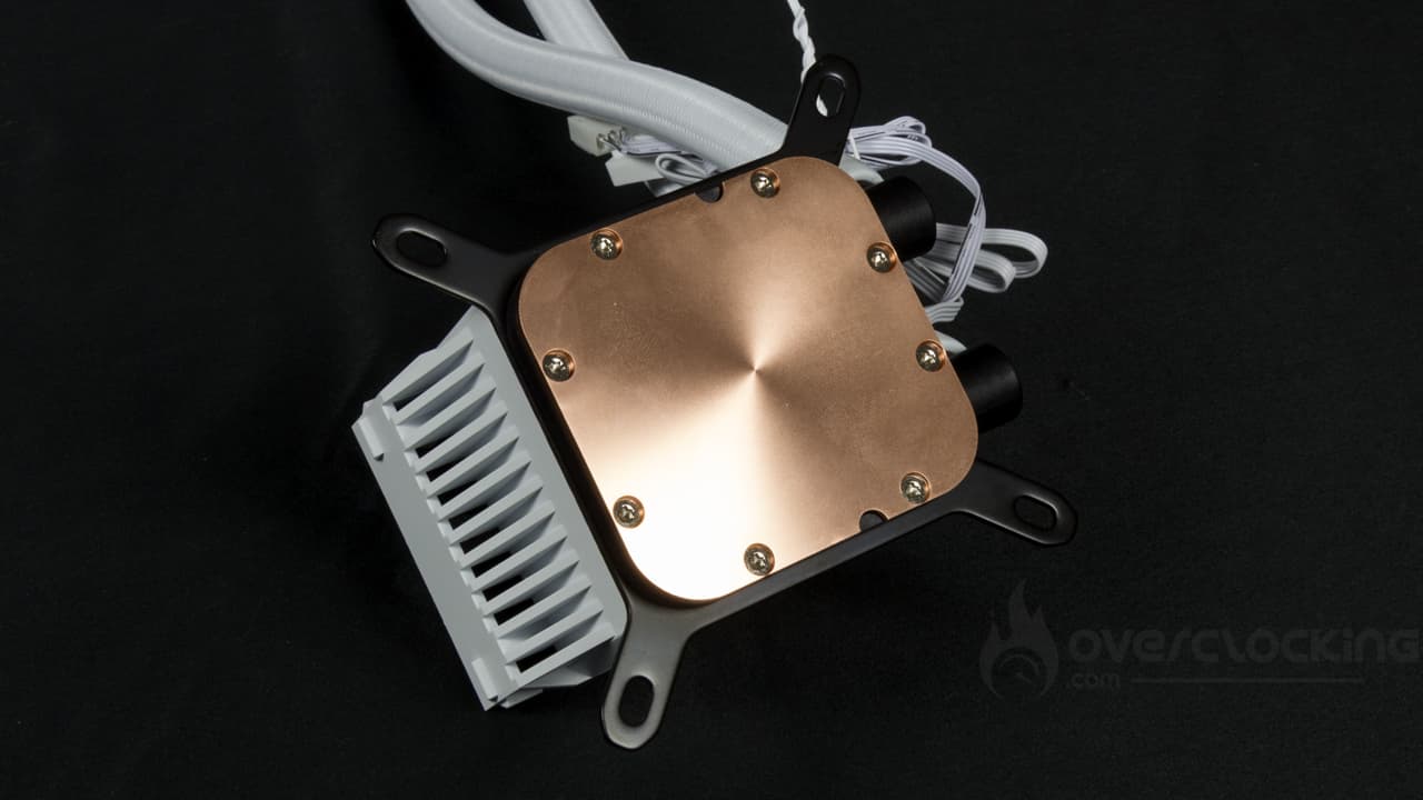

Without the screens, a small fan is present to cool the elements located around the socket. Memory and VRM heatsinks spring to mind. In all cases, this fan can reach 3500 rpm. At full speed, it will generate an airflow of 6.8 CFM and a static pressure of 1.5 mmH2O. It is powered by PWM and has its own cable.
The cold plate is, of course, made of copper. It is screwed to the rest of the block by eight Torx-head screws. The plate measures 60×65 mm and has been carefully treated. You won’t feel any traces of machining on your fingertips: it’s smooth and soft to the touch.
Thermaltake MineCube 360 Ultra aRGB pompeThe pump benefits from a PWM-type power supply and boasts an operating speed of between 1500 and 3300 rpm. Once again, no precision is given as to flow rate, and the same goes for the water column.
On the other hand, beware of the number of cables, since once the screen block is in place, we end up with four connectors. There are already two PWMs for the pump and pump fan… But a SATA power supply and a micro-USB are also present at the screen output for powering and managing the latter.

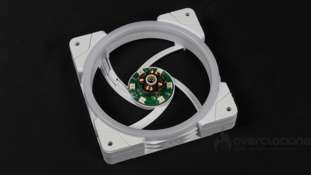

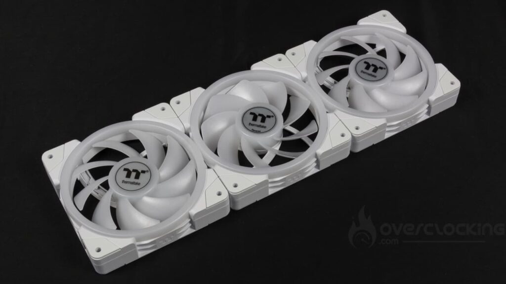

With this kit, ventilation is provided by a trio of Swafan Ex aRGB in 120 mm. As you can see, these have a rather massive appearance, reinforced by the presence of a thick frame and rather short blades. The latter, of which there are nine, are fairly thin and not very curved. Naturally, they are translucent to help diffuse the aRGB lighting. As for the frame, an imposing luminous ring stands out, while rubber silentblocks are present to attenuate vibrations.
Another special feature is that fan connections are integrated directly into the frame. As a result, each mill has a pogo connector and contact pins for serial connection of the fans. Finally, a MagForce connector is present to connect the cluster to the motherboard.
Thermaltake MineCube 360 Ultra aRGB ventilateurs

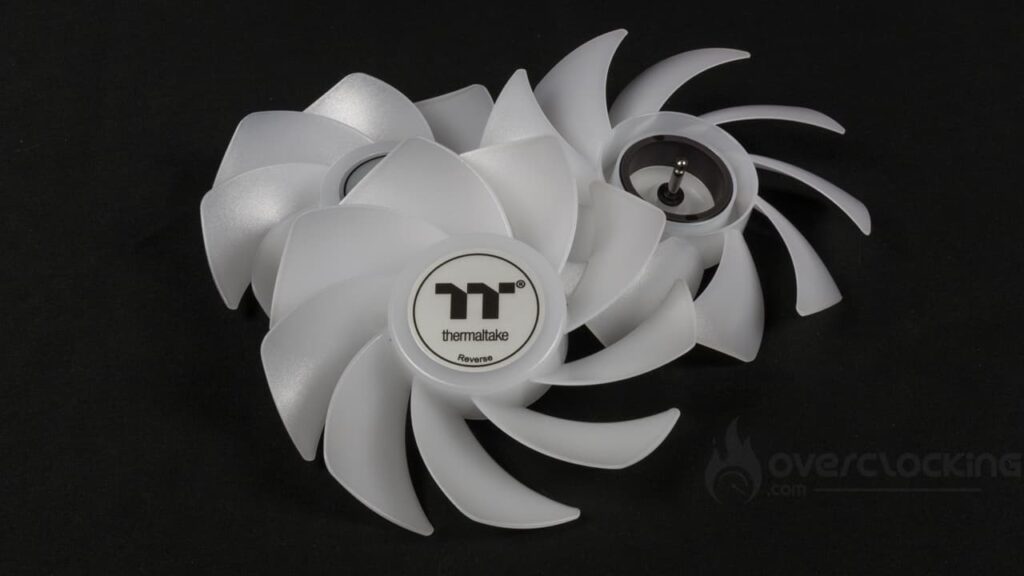

Most importantly, Thermaltake supplies two sets of blades with its fans. There are classic blades fitted by default, and inverted blades. These are simply removed by turning the fan over and pushing on the blades. The new ones are inserted by inserting the shaft into the motor and pushing on it. At the very least, this guarantees simplified cleaning operations!
Thermaltake announces operating speeds of between 500 and 2000 rpm. The rest of the specifications highlight :
  • Classic blades :
    • Air flow: 57.11 CFM
    • Static pressure: 2.39 mmH2O
  • Inverted blades :
    • Air flow: 56.26 CFM
    • Static pressure: 2.02 mmH2O
Finally, the MagForce 2.0 connector ends in a PWM fan socket for connection to the motherboard for power and speed management. For aRGB lighting, there are two dedicated sockets, one male and one female, for serial connection to other equipment.

In broad terms, the MineCube 360 Ultra aRGB Sync is an impressive piece of kit, especially its pump and numerous screens. Otherwise, the finish is flawless, and high-end fans are included. In short, we can’t wait to put it all together and power it up!

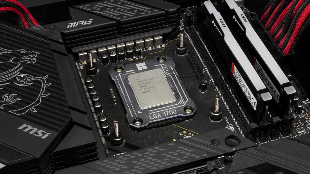

For installation, you’ll need to keep your AMD backplate, as Thermaltake doesn’t supply one. If you don’t have one any more, a quick look on eBay should enable you to find one easily.
Assembling the MineCube 360 Ultra aRGB :
As far as assembly is concerned, the first step is to fit the right arms to your motherboard. To do this, simply insert them around the pump. The latter then has a dedicated groove. More specifically, if you have an AMD motherboard, you’ll need to start tightening the clamps. Be careful not to over-tighten, or you won’t be able to fit them onto the original AMD arms – a few turns will suffice.
Next, on the Intel side, you’ll need to position the correct backplate on the back of the motherboard, and then screw the spacers around the socket. The spacers for LGA-1000 sockets are black, while those for LGA-2000 are silver.
Thermaltake MineCube 360 Ultra aRGB montage AMD 2The next step is to position the pump on the CPU, having first applied thermal paste. On AMD platforms, you’ll need to tighten the hooks once they’ve been fitted into the motherboard’s original mounting arms. On Intel CPUs, screw the spring-loaded nuts onto the backplate spacers.

Thermaltake MineCube 360 Ultra aRGB bloc écranTruly, this screen block is very satisfying to look at, all the more so as Thermaltake offers some frankly sympathetic visuals by default like the Minecraft-themed one… The inspiration for which can clearly be felt in the AIO‘s name. Best of all, each screen can be managed independently, allowing you to display different things on each one. You can display a different visual on each one, or system information on each face with a different theme on each. In short, a permissive system that lets you customize your display as you wish.

Four screens on one pump!
Clearly, with this kit Thermaltake sets itself apart from the competition with an original concept: integrating four screens on a single pump unit. This means you can cover virtually every side of the MineCube 360 pump, and always have something to look at. Better still, the software lets you manage each screen independently or synchronize the display on each of them, while you can choose what to display where.
Beware, however, that this comes with a few drawbacks, not least in terms of size. In terms of height alone, the screen block is bigger than some aircooling fans.
