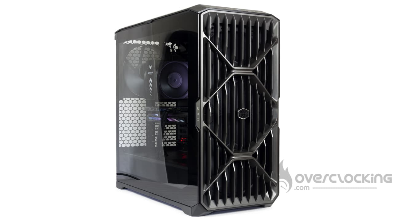

Today, we’re taking on a real beast—and for good reason: we just received the latest large case from Cooler Master—the HAF II 500! As a reminder, HAF is an acronym that simply stands for High AirFlow, and when you see what this beauty has to offer, you’d expect it to deliver some serious airflow. We actually first spotted this case at Computex at the brand’s headquarters, and it caught our eye right away. Anyway, let’s see what it’s really made of!
Cooler Master HAF II 500
The Cooler Master HAF II 500:

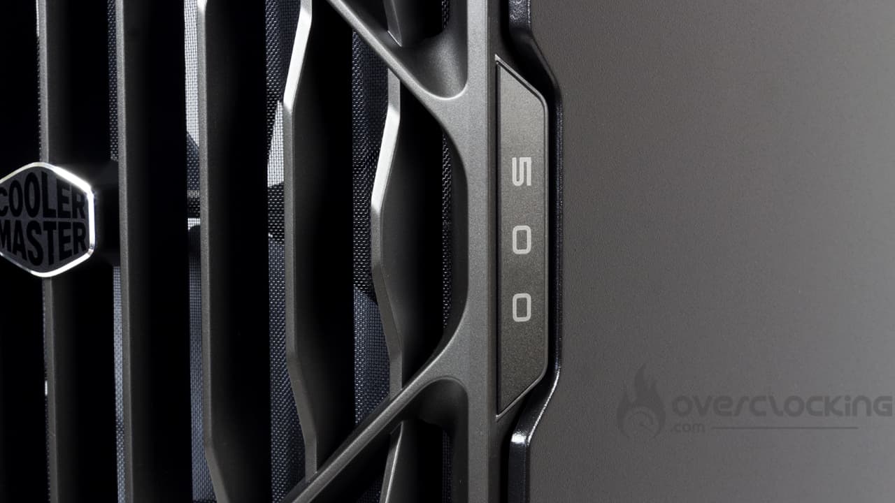

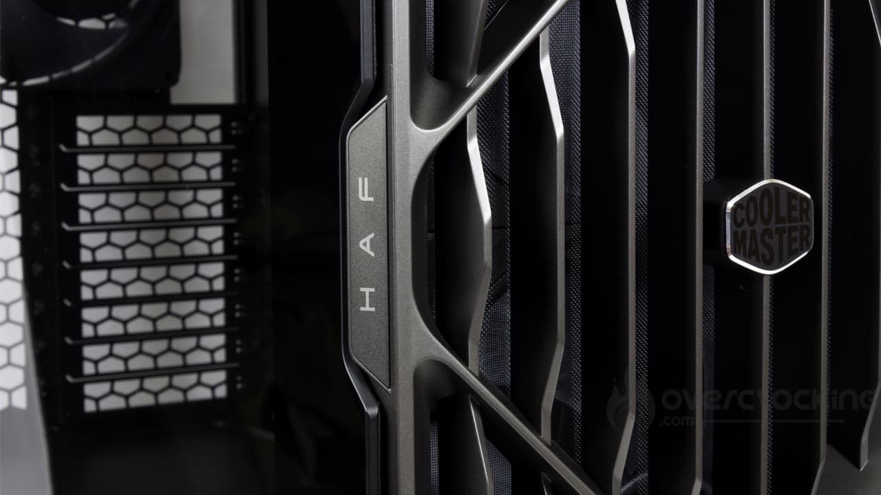

Quite clearly, with this case, Cooler Master is offering us a model that’s—to put it mildly—aggressive; at the very least, you can tell it’s got some serious potential. The front panel features a very wide grille with pronounced edges. In the center is the brand’s logo, while “HAF” and “500” inserts are positioned on either side. Clearly, we have a very open front panel with plenty of space between the edges, so we expect maximum cooling from this design.
Furthermore, the case is constructed with a steel chassis and plastic front and top panels. In fact, the edges tend to bend fairly easily when touched, especially the one featuring the brand’s logo. But visually speaking, the finish is satisfactory—at first glance, it looks like aluminum.
In terms of dimensions, this is quite a beast—it measures 262 (W) x 557 (D) x 548 (H) mm. As for the weight, I won’t lie—with a bad back, testing this model was definitely no walk in the park, especially considering it weighs 14.2 kg when empty… Who said this job wasn’t physically demanding?
Price-wise, it’s clear we’re dealing with a model that falls squarely in the high-end segment. Prices start at €180 at Top Achat and go up to €350 on Amazon via a marketplace. Clearly, an average price of around €200 seems likely depending on the retailer.

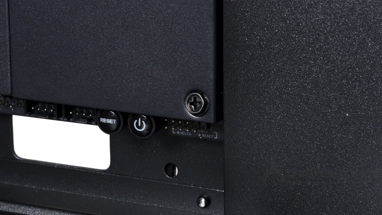

Cooler Master HAF II 500 panneau de contrôleOn this HAF II 500, the control panel is located on top of the case. It’s fairly standard and features a familiar set of ports, including:
  • 2xUSB 3.2 Gen1
  • 1xUSB 3.2 Gen2x2
  • 1x 3.5 mm headphone/microphone jack
  • 1xpower button
  • 1xreset button
This set of ports is functional, to say the least, and you can easily plug two USB flash drives into the case. This is a change from some cases whose port layout is minimalist, featuring only a single Type-A port.

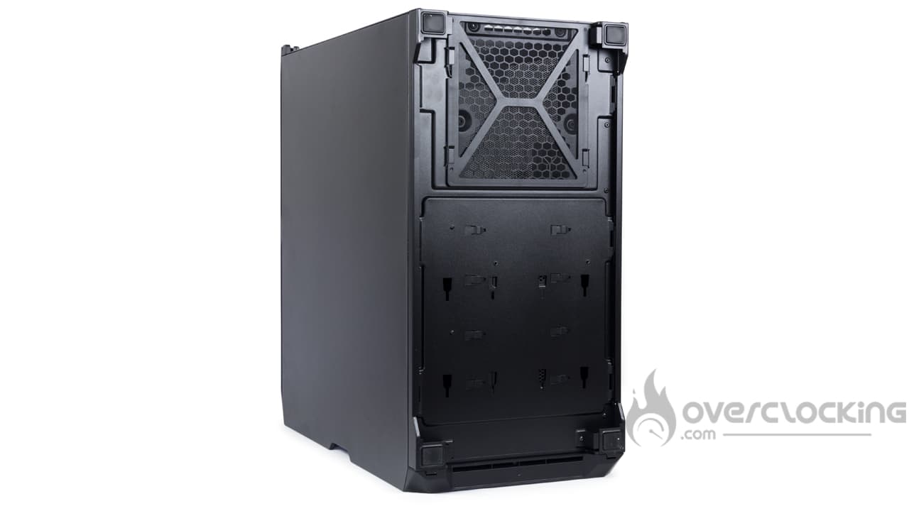

The bottom:

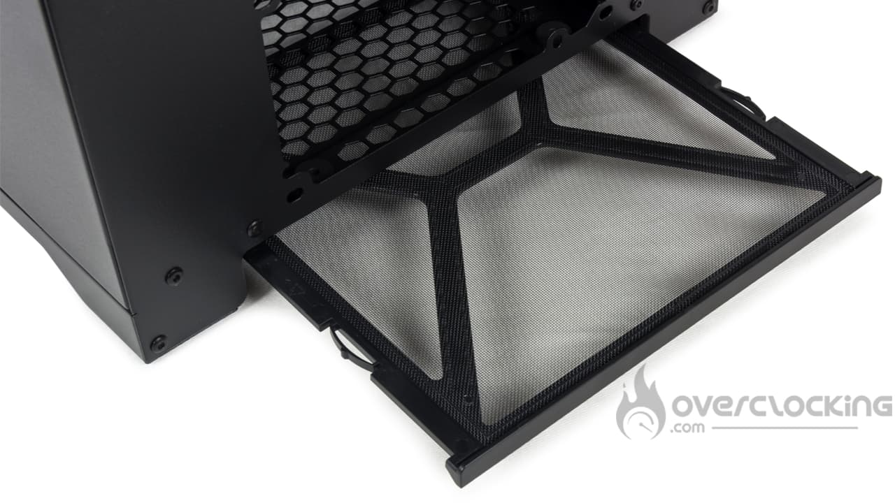

As you can see, the bottom of the case doesn’t have much to offer. There’s a filter located toward the back for the power supply. Incidentally—and this is a shame—the power supply is only accessible from the back of the PC. To clean it, you’ll inevitably have to move the tower. We would have preferred it to be accessible directly from the side, for example.
Finally, at the four corners, there are four rubber-coated feet. These provide good grip, which doesn’t make moving the PC any easier.

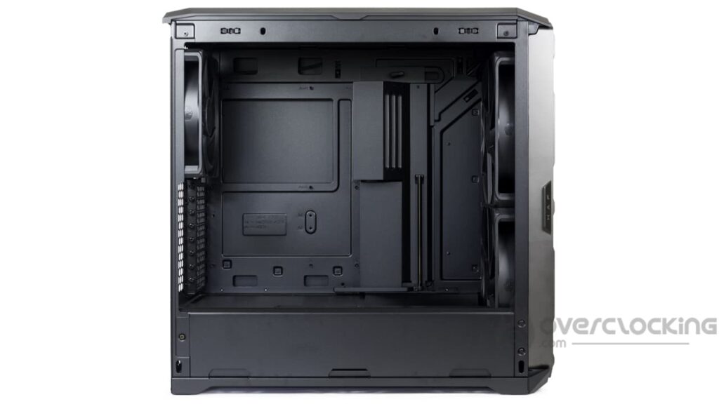

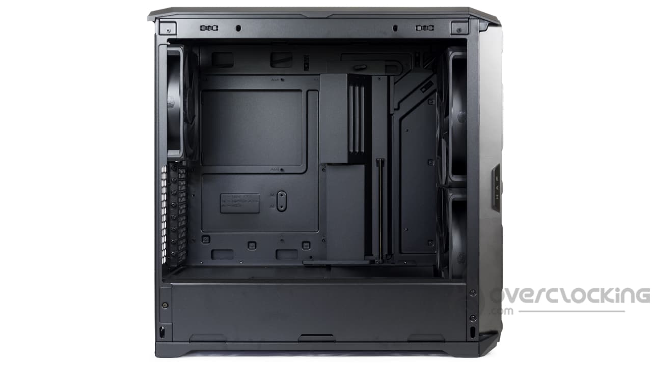

Once inside, we can take a look at the chassis of this HAF II 500, which is fairly standard in itself. At the top, we find the motherboard slot, which can accommodate E-ATX-format models. However, there’s no support for motherboards with rear-mounted connectors—we’ll see why a little later.
As for the openings, there are just enough without being excessive. At the top, there are two openings for routing fan cables as well as theCPU power connector. At the bottom, there are also two small openings for routing cables to the control panel. Finally, on the side, there’s a long opening topped by a perforated metal cover designed to hide the cables without obstructing airflow.

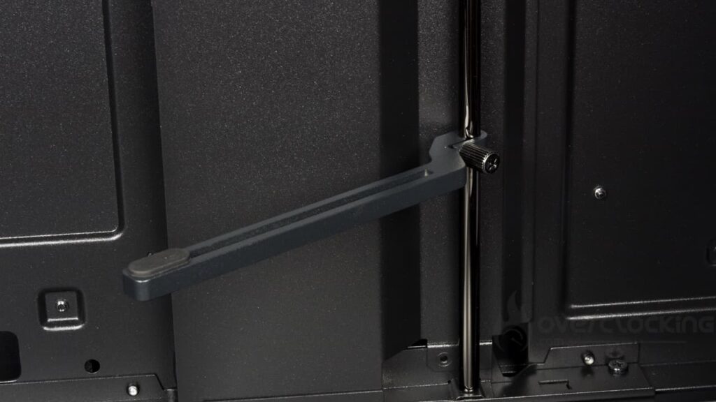

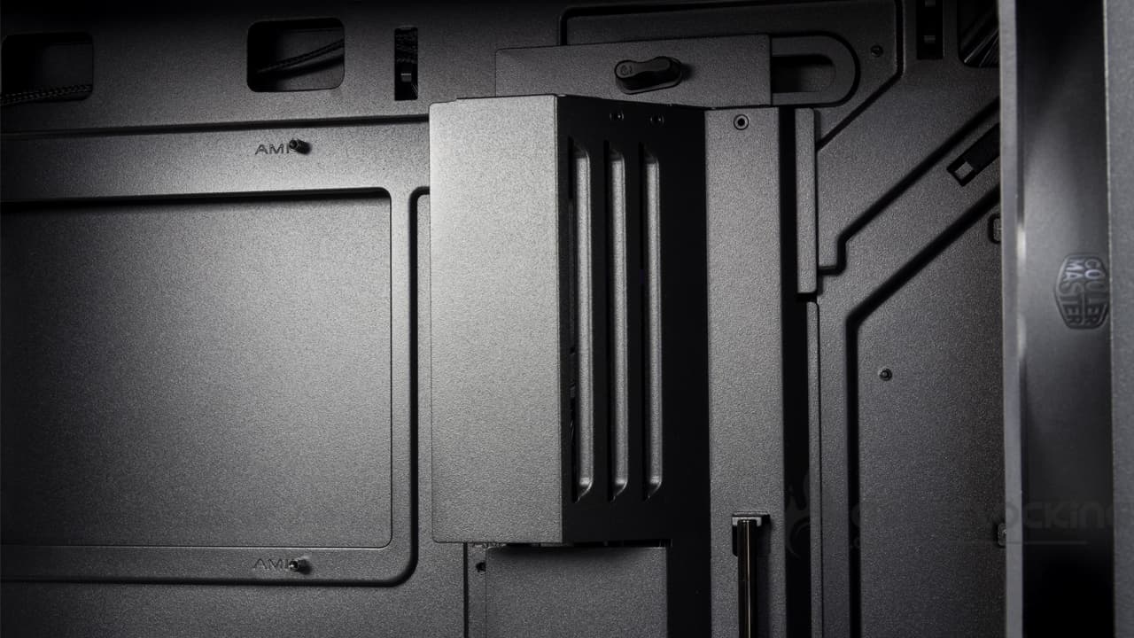

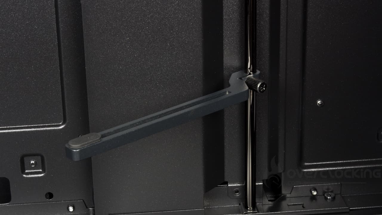

As for the graphics card mount, there’s a dedicated bracket with an arm mounted on a long metal rod. You can swivel it so that it’s positioned directly under the card’s shroud.

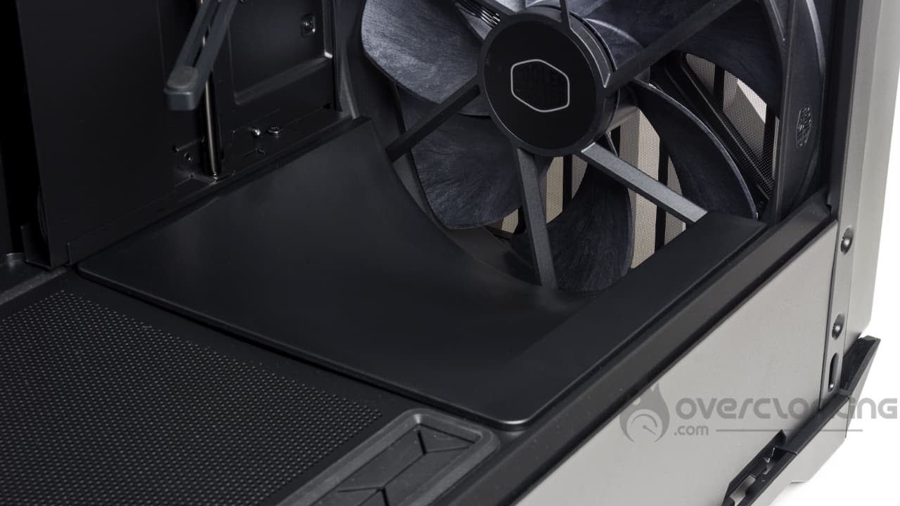

Additionally, at the bottom front, there’s a deflector designed to channel some of the airflow from the front of the case toward the graphics card(s). With its eight expansion slots, this model allows for the installation of multiple GPUs.

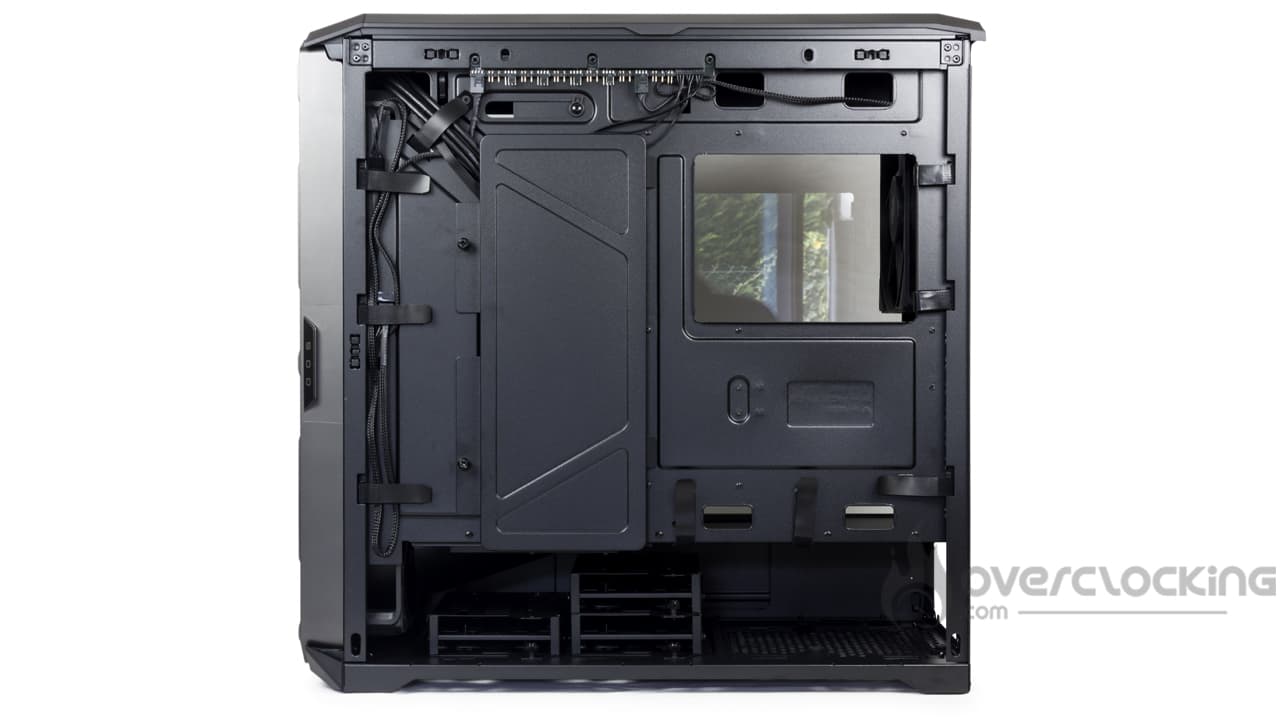

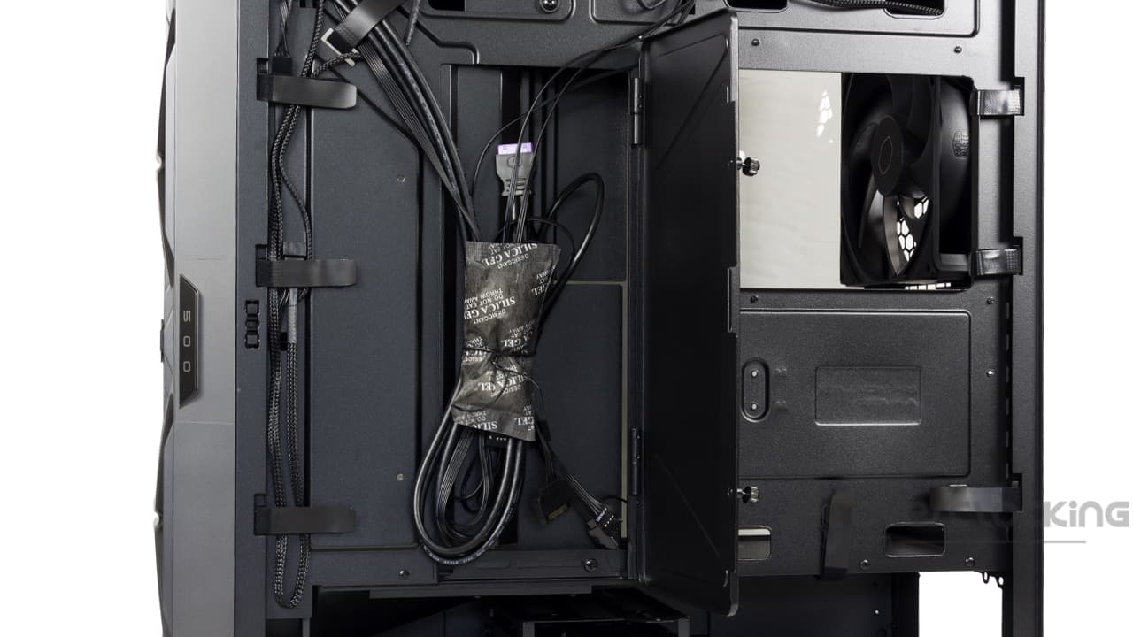

Additionally, at the rear, there are numerous cable management features to help keep cables organized, along with a cable cover. This cover helps keep cables secured to the back of the motherboard tray while ensuring a neat installation. Finally, at the top, there’s a hub that allows you to connect six fans and six RGB devices. It’s worth noting that this unit provides a total power output of 54 W—so your fans certainly won’t lack power.

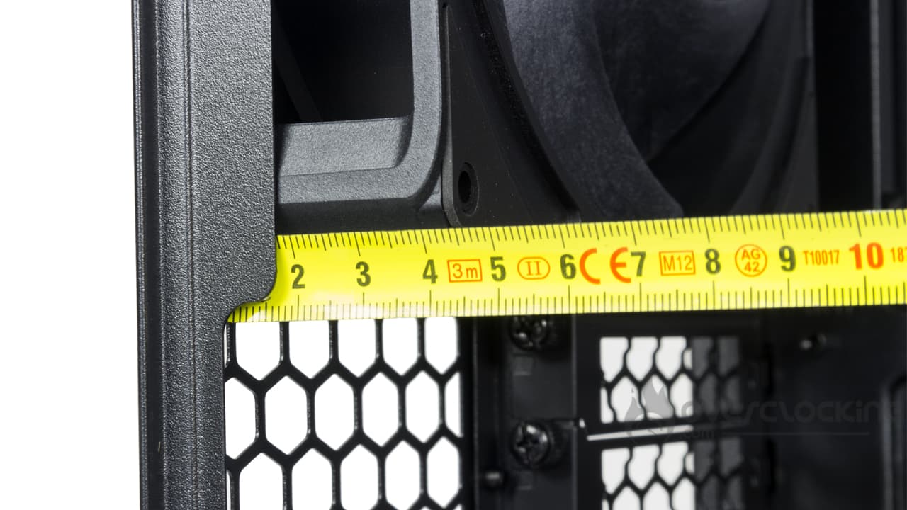

However, at the back, this isn’t the most spacious case, with generally less than 2 cm of room for cables. You’ll have to be a bit frugal with your cable routing. Let’s just say that the rear space was reduced to make room for a large exhaust fan.

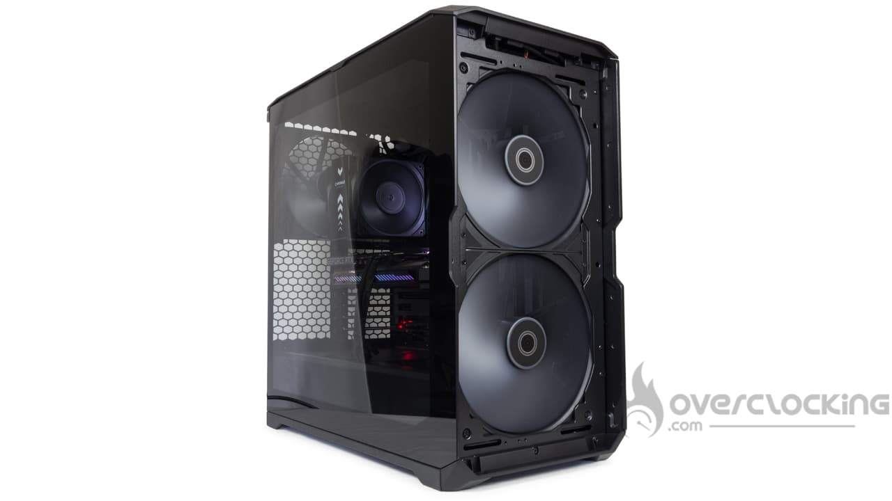

Cooling options:

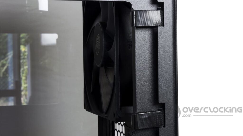

Cooler Master really went all out with the stock cooling setup. By default, the brand’s HAF II 500 comes with three fans installed as standard. And the brand didn’t hold back, featuring two large Mighty40 F220 fans in the front and a Mighty40 V180 in the rear… Yes, a 180×40 mm fan mounted at the rear! The fans are thick and exude sturdiness, with an ultra-rigid construction featuring LCP for the blades and PBT for the frame. To put it simply, the two 220-mm fans spin at up to 1,050 RPM, but generate an airflow of 203.8 CFM at full speed and a static pressure of 3.1 mmH₂O. At the rear, the 180 mm fan spins faster: 1,370 RPM, generating an airflow of 161.5 CFM and a static pressure of 4 mmH₂O.

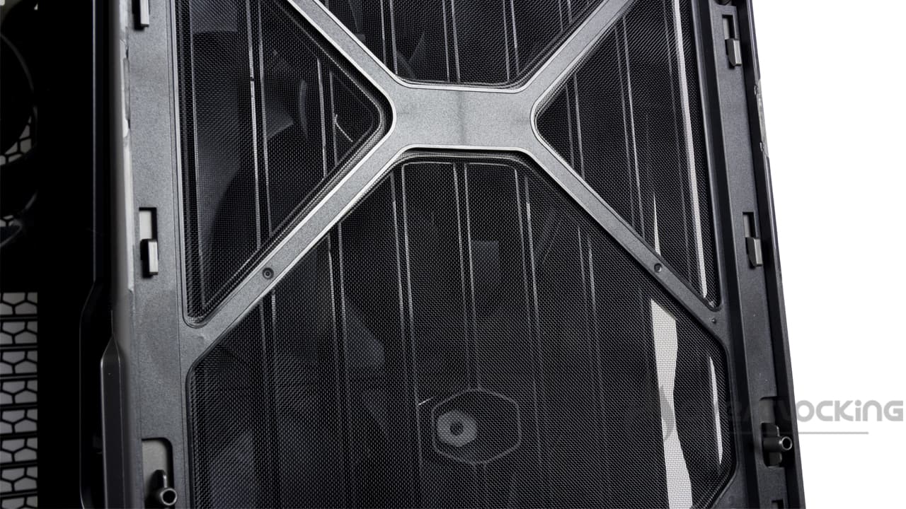

In all cases, the case also features full filtration. The front panel and top section are lined with a nylon filter, so there’s no need to worry on that front.

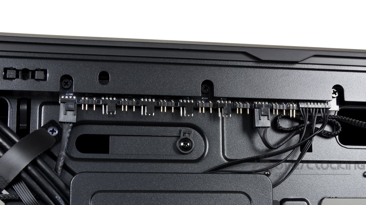

Cooler Master HAF II 500 It will be possible to add fans, since there are empty slots at the top. Using a rail system and removable metal sliders, you can install:

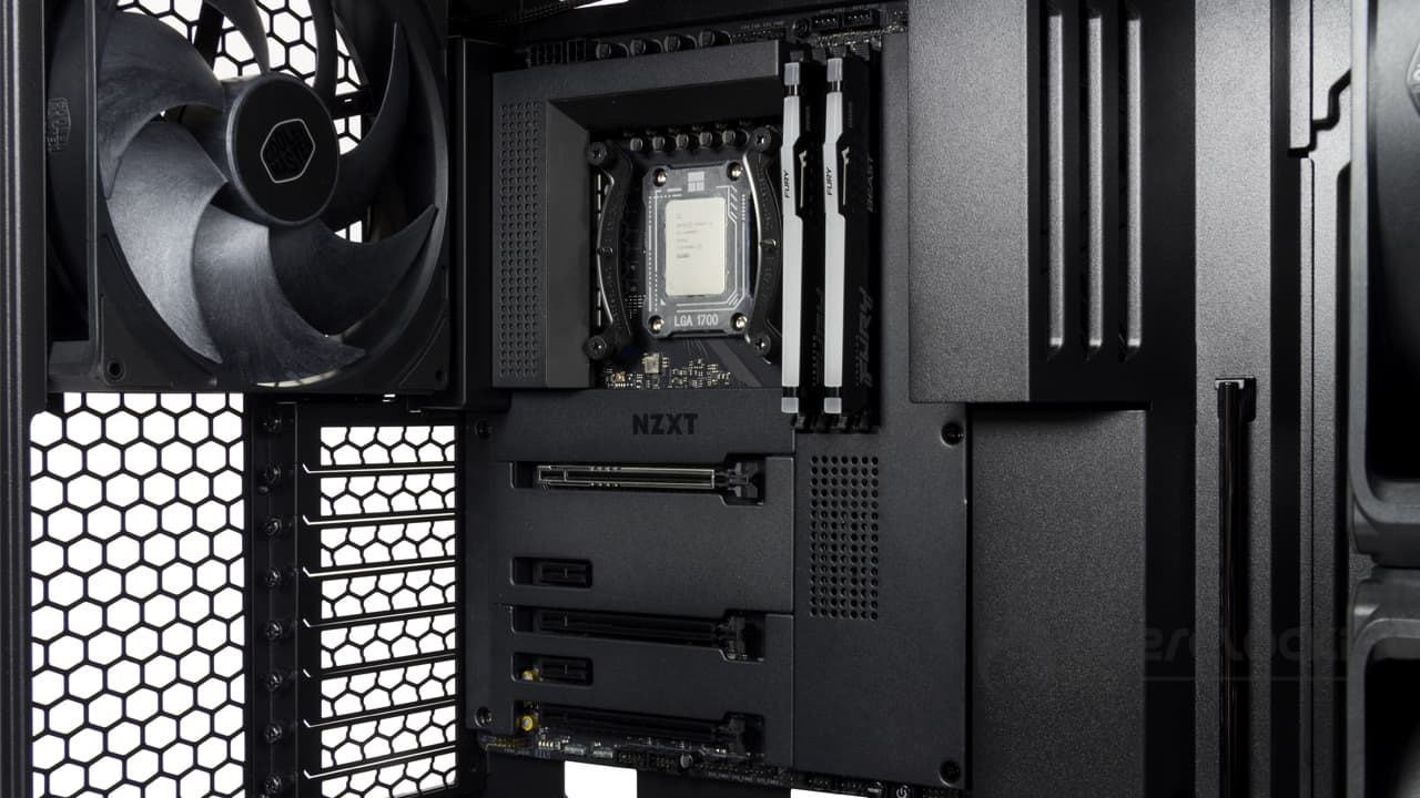

As for installing the motherboard, before placing it on its tray, we moved the cable-management plate to the side. Once in place, we encountered a small surprise: the screws provided by the manufacturer wouldn’t fit through the shield on our NZXT N7 Z790. This isn’t the first time this has happened, as be quiet! cases also tend to come with these same screws. We had to use our own hardware to secure the motherboard.

As for the cabling, to put it simply, we reorganized the cable routing inside the case. As a result, the front panel connectors now run through the front of the case and down again. Of course, the F_PANEL and HD_AUDIO connectors come out through the bottom openings.The USB 3.2 Gen1cable runs through the bottom of the rear door, while the USB Type-C cable runs through the top of the door. Of course, the cables are secured in place by the Velcro strips along the route. However, don’t pull too hard on them, as the metal tabs used to secure the cables are quite fragile and can bend easily.
It’s also worth noting that the hub’s SATA power cable runs through the front, while the RGB and PWM fan cables connected to the motherboard run along the back of the case.

Cooler Master HAF II 500 montageThe large backplate opening leaves plenty of clear space at the back of the motherboard. This gives you all the room you need to work with the CPU cooler’s mounting hardware.
As for installing the graphics card, it’s not very complicated either—just locate the brackets corresponding to the graphics card slot, remove them, and slot in your card. Finally, connect it using the 8-pin PCIe cable coming out of the power supply shroud. Finally, you can use the graphics card bracket by adjusting its height and spacing to position it under the card’s shroud. All that’s left is to tighten a thumb screw to lock it in place.

Honestly, when we saw that the case had less than 2 cm of space in the back for cabling, we were a little worried we wouldn’t be able to close the side panel. But Cooler Master’s engineers did a great job here, and we were able to route the cables neatly and close the panels without any trouble!

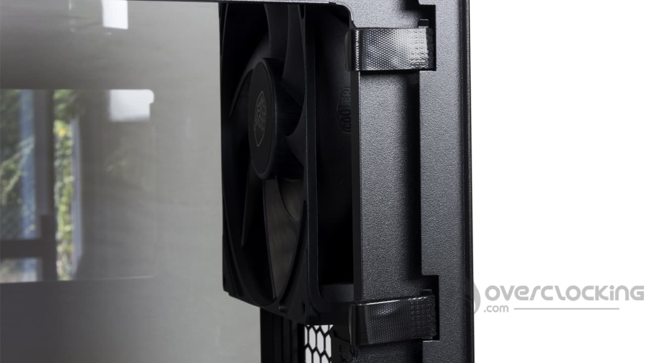

  • The dust filter, which is still only accessible from the back
  • Perhaps the lack of rigidity in the plastic on the front panel
  • Be careful not to pull too hard on the Velcro strips
