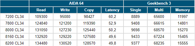

Step 2: 7800, 8000, 8160 and even 8200 MT/s
We’ve been testing DDR5 kits for several months now and are starting to get a better handle on overclocking. Important point, we received a new ROG Z690 APEX dating from 2022. The 2022 versions have the advantage of not having to worry about overclocking the memory. The 2021 versions can be very limited in terms of frequency on slot A. We were able to validate four profiles ranging from 7800 to 8200 MT/s. Regarding the voltages, they were 1.60 volt (VDD), 1.60 volt (VDDQ), 1.35 volt (IVR) and 1.30 volt (Memory Controller). The SA voltage is 1.40 volts. Here is a table that shows the different scores we obtained at these different frequencies under AIDA64 and Geekbench 3.4.4.
And to finish, the screenshots of our different results.
Please note that we have just received a copy of the ROG Maximus Z790 APEX and we will retest this kit on this new motherboard. We will keep you informed of our results by publishing a brief very soon. [nextpage title=”The last word: “] Wow, how lucky we are to have been able to test this first A-die kit from Teamgroup which was able to reveal its potential on our ROG Maximus Z690 APEX. We are only waiting for one thing, it is to be able to test it now on the Z790 APEX version. This kit left a very strong impression on us and the overclocking potential of these A-die chips is very much in evidence. We also expected a lot from this kit and to say the least, we were not disappointed. The performance is the best we’ve seen so far and it’s a first place finish in all our benchmarks for this Teamgroup Delta RGB 7200 MT/s CL34. Teamgroup continues to do a great job with their memory kits combining high frequency and tight timings. The great thing about this kit is that once you own it, you only need to enable the XMP profile to take advantage of its performance. There is no need to make any changes in the BIOS. Despite its characteristics, the XMP profile was perfectly recognized on the ROG Z690 APEX. We could only post once again the data rates obtained at 8200 MT/s in CL34.
