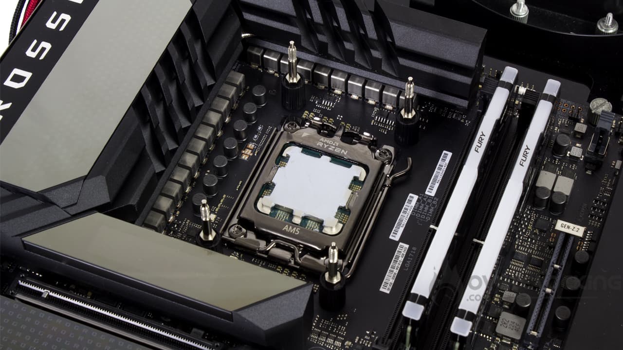

For installation, you’ll need to keep your AMD backplate, as Endorfy doesn’t supply one. If you don’t have one any more, a quick look on eBay should enable you to find one easily.
Assembling the Navis F360 aRGB:

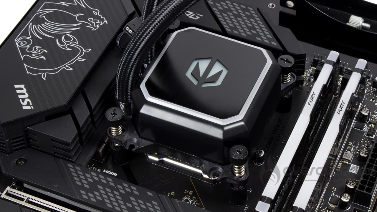

For mounting on AMD platforms, the first thing you’ll need to do is remove the original mounting arms from the motherboard. Once that’s done, you’ll need to place the mounting screws in the four corners of the socket. In this case, there is no difference between those for AMD and Intel mainstream sockets, as you will need to use the same ones: the one with the black plastic ring.
Next, you apply some thermal paste to the CPU and place the pump on top. All that’s left to do is screw it on, but before you do that, you’ll need to place springs on each threaded rod and then screw the whole thing on using black nuts. Of course, to distribute the pressure more evenly on the CPU, we screw in crosswise, at opposite angles.

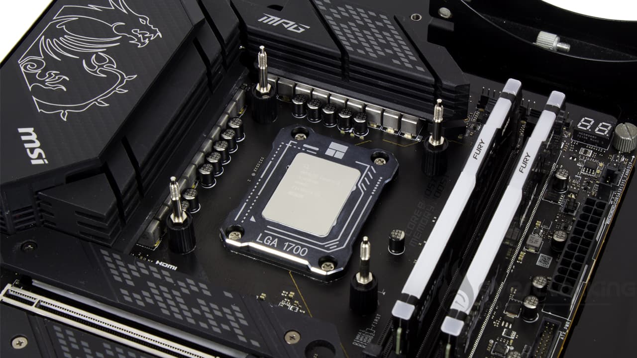

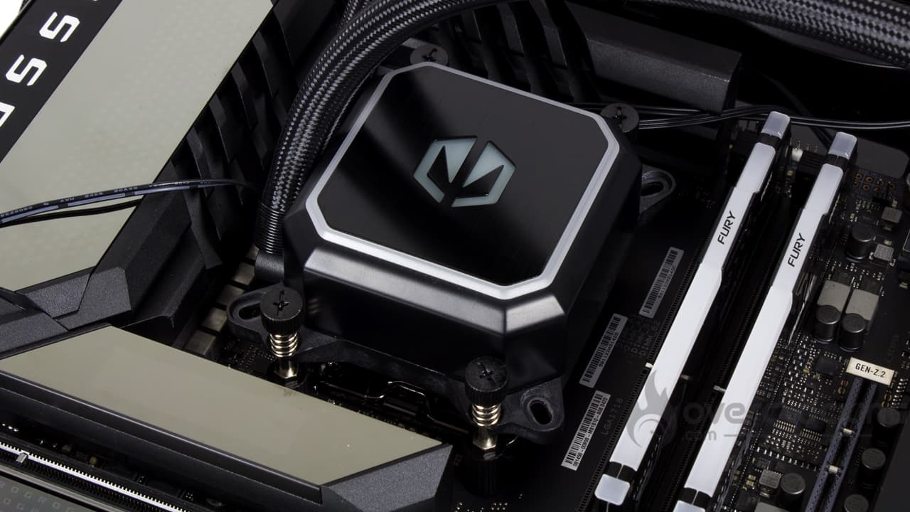

The procedure for Intel platforms is exactly the same. The only difference is that the backplate must be positioned on the back of the motherboard. Be careful, though, because depending on the socket, it may need to be placed at an angle, as is the case with the LGA-1200/115x.
All that’s left now is to connect the kit to our motherboard. In itself, this isn’t very complicated, as all you have to do is pull a PWM extension lead (supplied) to connect the fans to the motherboard. The same goes for the RGB, however, as all the fans are connected to each other and, ideally, the pump should also be connected to the fans, you end up running out of length. In short, with more up-to-date solutions like Corsair’s iCUE Link, for example.
