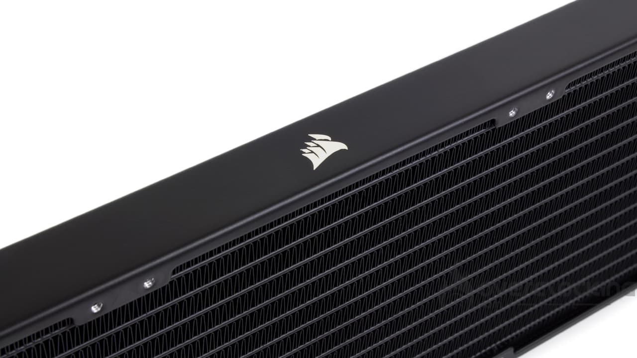

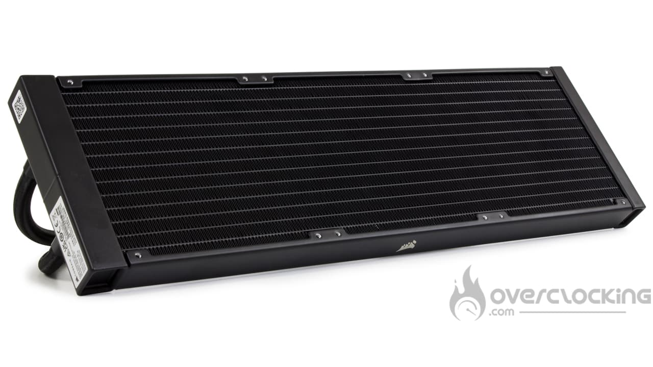

We now move on to the radiator part of this H170i Elite LCD XT which, out of its format in 3x 140 mm remains quite classic. Indeed, the manufacturer in aluminum and the thickness is 27 mm. Regarding the number of channels, we are at 13, as for the former H170i Elite Capellix. Finally, there is also no change in dimensions at this level since we find a total length of 457 mm and a width of 140 mm.
In addition, the finish does not change since the block remains square, without visible screws. It is also painted in black with a paint applied correctly. It will not leave a gray area at the level of the fins. Finally, we have, on the sides, a small bright Corsair logo in gray.
Finally, the only real drawback to this radiator is the dimensions of the radiator. 457 mm, clearly, you need a case that can accommodate such a monster.
To connect the pump and the radiator, we find two tubes of 45 cm in length. Regarding the finish, R.A.S since we find a nice nylon sheath very soft to the touch. In addition, the pipes remain very flexible, so that you can make tight curves without forcing, which is very practical for the assembly.

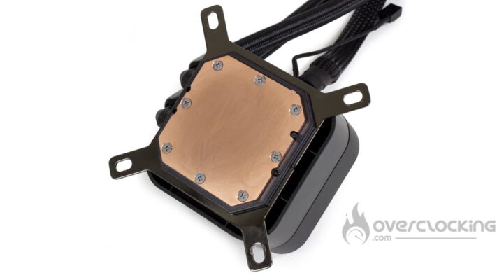

Underneath, we have our copper base which will be in contact with our processor. This base measures 56 mm on each side and will cover the IHS of the AM5 and LGA-1700 CPUs. For the AMD sTR(X)4, if a big part of the processor should be covered, the whole will not be. Finally, it will be held in place by eight Phillips screws.
On the connectivity side, there’s a lot to talk about since starting from the pump we have two connectors, one big, flat, 22-pin and a second one of USB 2.0 type. Finally, we have a third, non-PWM fan type with a single cable pin to retrieve the pump speed.

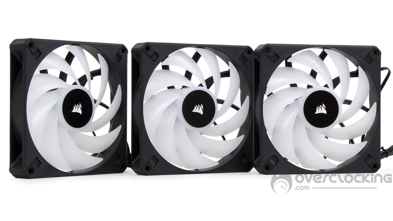

Finally, the biggest change Corsair has made is in the ventilation. Unlike its Elite Capellix counterpart, this time we get three 140mm AF RGB Elite fans.
These feature a smooth frame with four rubber silentblocks to reduce stray vibrations. In addition, the mills offer nine long, rather curved and thin blades. They are white and translucent to maximize the diffusion of aRGB lighting.
Besides, we find a double RGB connector with a proprietary connector and PWM with a universal connector. While the first will be used for color management, the second will be used to manage the operating speed.
Now, what interests us is the performance. At this level, the brand announces speeds between 500 rpm and 1700 rpm. At full speed, the air flow will reach 89 CFM while the static pressure will rise to 2.00 mmH2O.
