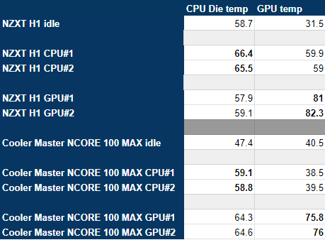

Before showing you the graphs, here’s the table to show you the data retained.
As you can see, at rest, the NCORE 100 MAX is 11 degrees Celsius cooler than the NZXT H1 for the CPU, but 9 degrees Celsius warmer for the graphics card. However, Cooler Master wins the arm-wrestling match when the load is increased.
It’s worth noting that during our CPU load tests on the H1, the GPU heated up to the point of triggering its fans… Which wasn’t the case with the NCORE 100 MAX, where CPU heating didn’t negatively impact GPU temperature.
Processor :
Here, the observation is clear: the Cooler Master 7-degree Celsius case is less hot than the H1 under full load. The CPU temperature is so low as to give us plenty to play with in the BIOS.
Graphics card:
When it comes to GPUs, Cooler Master’s case wins again, with 5.7 degrees Celsius of difference compared to NZXT’s H1. In such a compact case, the RTX 3080 had more room and therefore better airflow than in the H1, where it was shoehorned in.
