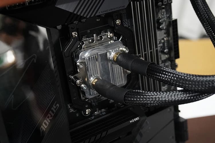

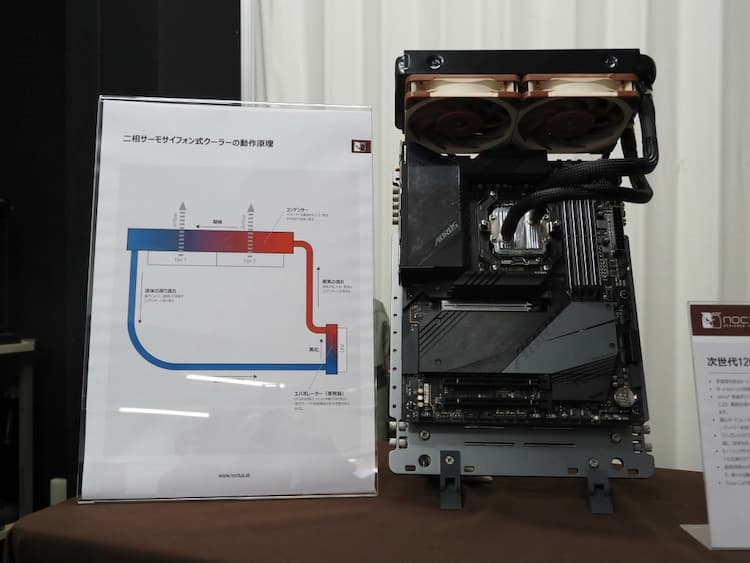

Noctua ThermosiphonThe thermosiphon system is already well known, since it is based on the heat pipe principle. Basically, the kit is filled with a liquid that evaporates at low temperature. As it evaporates, the liquid transports the heat to a condenser, where it cools and condenses. It then falls back in liquid form to the block installed on the CPU , where it can once again capture heat. The disadvantage of such a system is that it works with gravity, so the condenser will have to be installed at the top of your PC case.
But there’s also a big advantage to having such a system. It doesn’t need any mechanical parts to work. Unlike an AIO, we don’t have a pump, which greatly improves the reliability of the system.
Noctua Thermosiphon prototype
