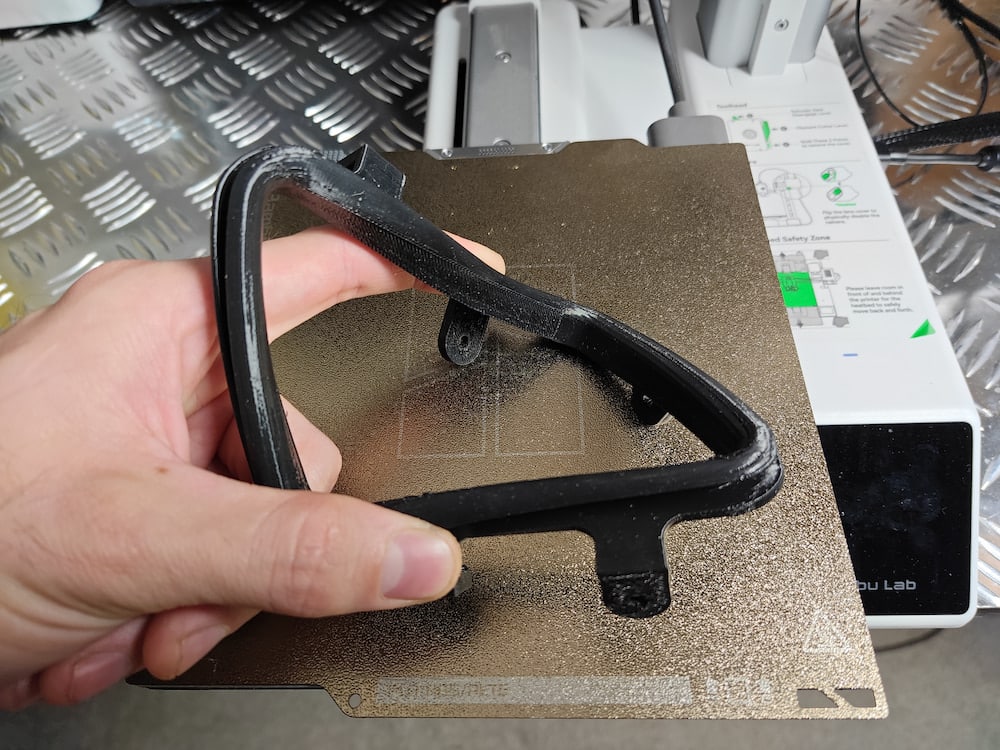

As with the PETG HF, I wanted to create a useful object. And as with the PETG HF, we’ve got some work to do on the restoration of the Porsche 928. This time we’re interested in a gasket that comes around the reverse light. Made of rubber, after 30 years, sometimes 40, it has to be changed. But no reproduction is currently available. Perfect for us, we’ll reverse engineer and print it in TPU 95A HF.
BambuLab Filament
Original
So out come the calipers and Autodesk Fusion. The rubber has worked hard over the years, so we have to make a few educated guesses.

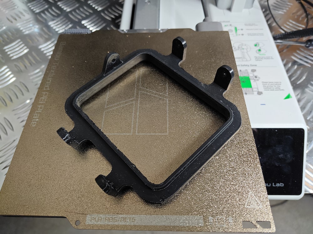

BambuLab Filament TPU 95A HFOnce the model is ready, we make a first impression in PLA, this time I’ve chosen a green PLA to make it easier to see. This allows us to make sure that the dimensions are right. This time we didn’t have to make any adjustments, as the geometry of the part was pretty straightforward. But to make the challenge more complicated, the best position to print it is vertically. This is simple for PLA, but much more complex for a flexible material.
BambuLab FilamentWe now move on to printing with BambuLab TPU 95A HF filament. Once again, the printer automatically recognises the spool thanks to its RFID chip. And the software already has its default settings for this material. Printing vertically is no problem… amazing. Not all the surfaces are perfect, but we already have a functional part to test in real conditions.
Now we’ll have to rework the supports by hand or change the orientation of the print to make this part even more presentable..
