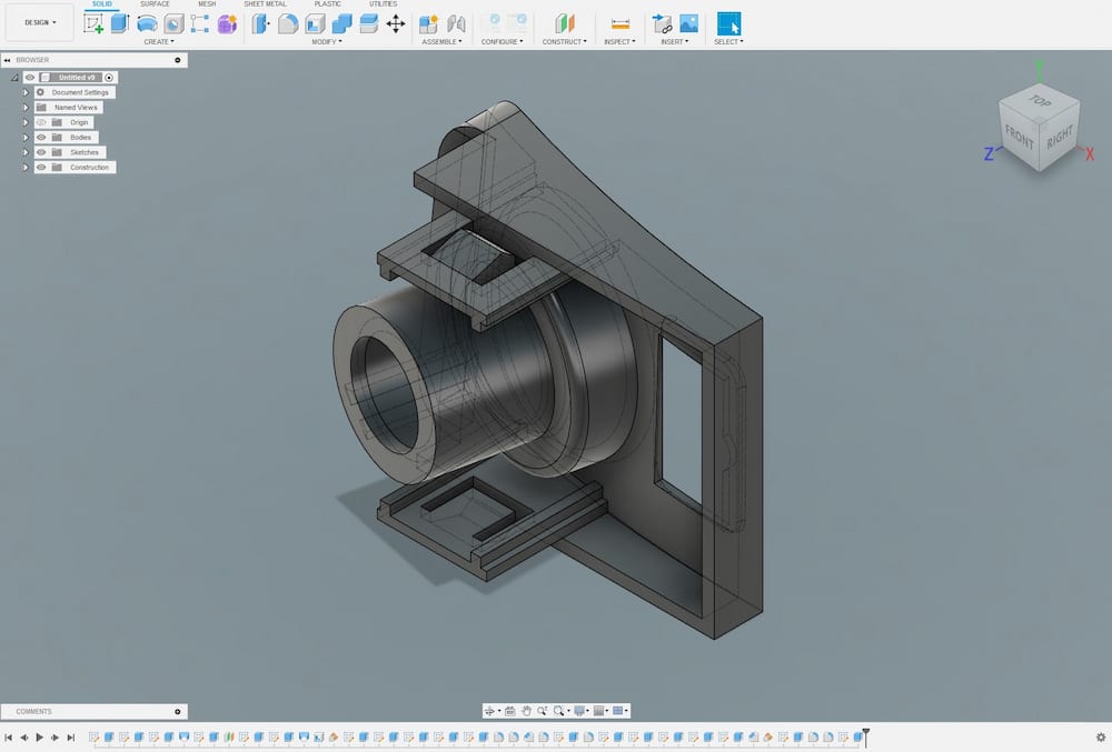

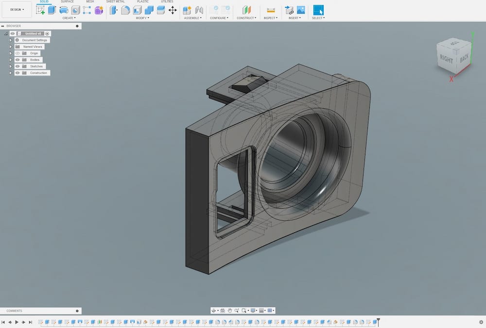

So, out come the calipers and Autodesk Fusion.

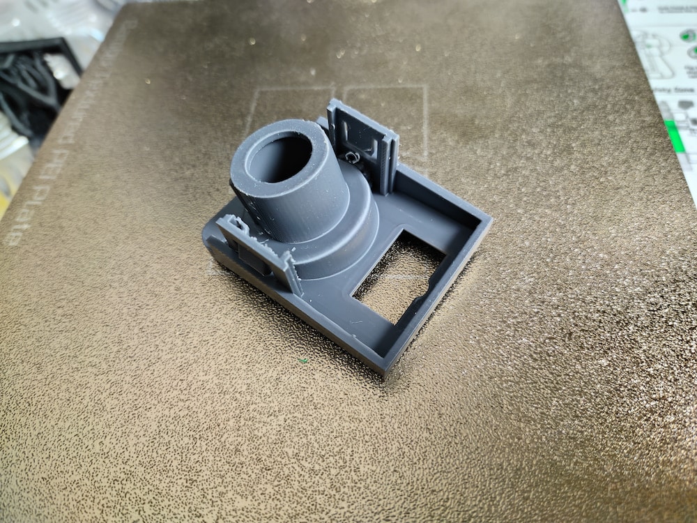

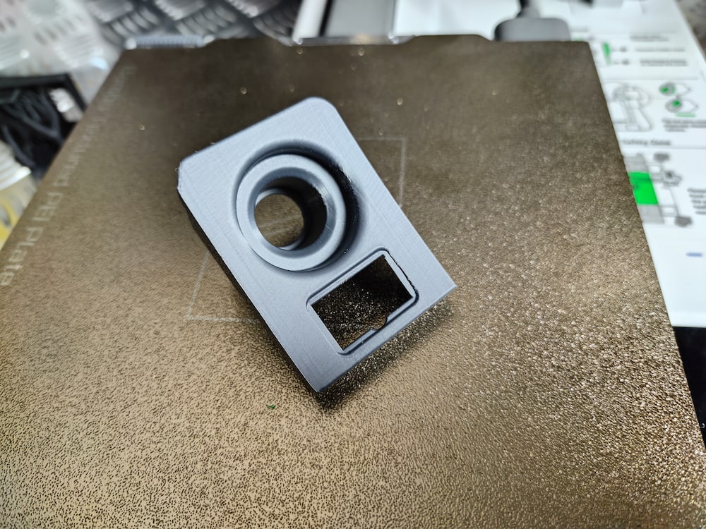

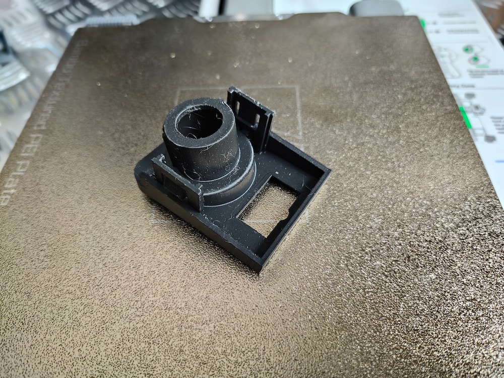

The room isn’t flat, with a few curves and angles. To make sure my measurements are right, I start with PLA prints, which are simpler and cleaner than the PETG HF we’ll be using for the final model.
After 2 tests and a few corrections. Let’s get down to business with the PETG HF. Normally, BambuLab printers automatically recognize the brand’s filaments, thanks to an RFID chip in each spool. A firmware update later, and the job’s done. That must be the problem with getting the filaments in advance.

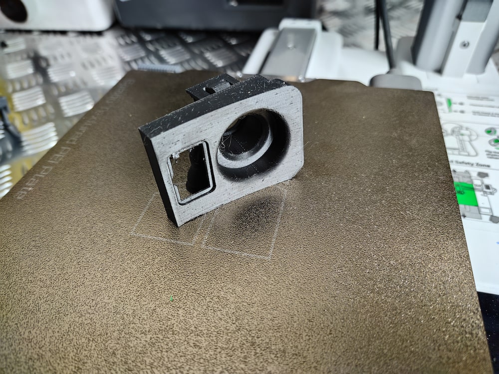

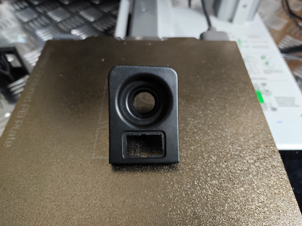

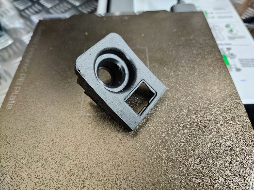

Anyway, I’ll leave you to admire the first PETG HF print of the copied part.

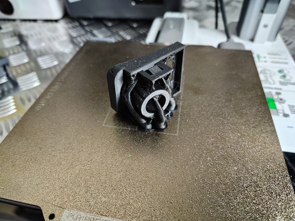

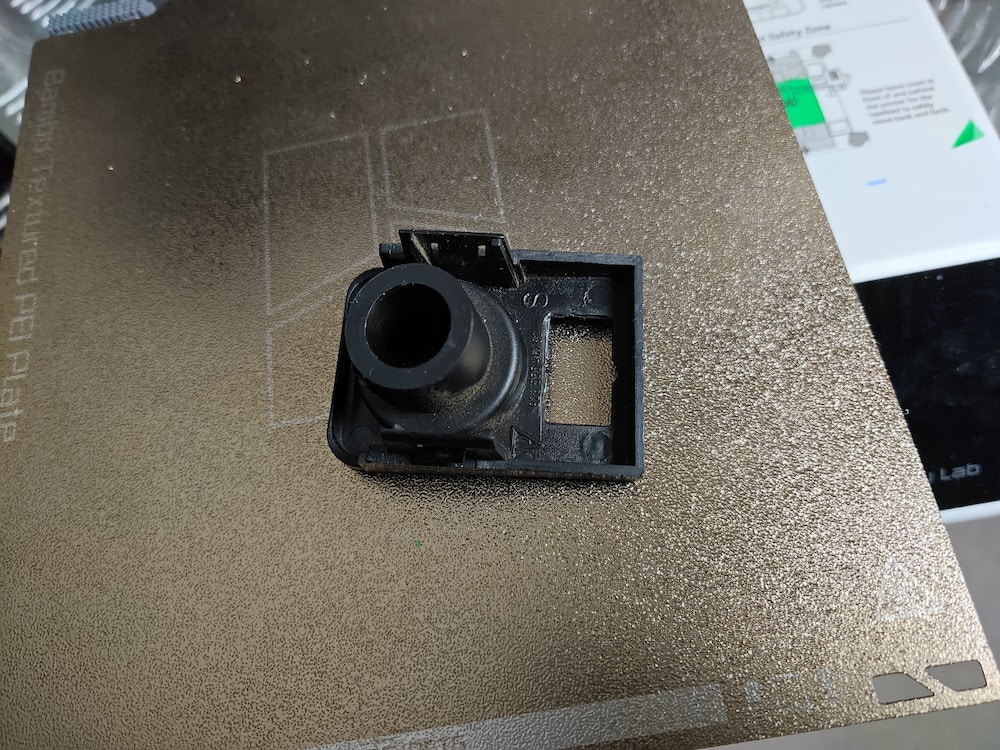

The supports are easy to remove and leave few traces. After a lick of paint, it will fit into a car being restored.
Yes, it’s the first one! As BambuLab does things right, each filament is pre-calibrated, which makes it all the easier to create, as there’s no need to fiddle around and do 10 tests.
