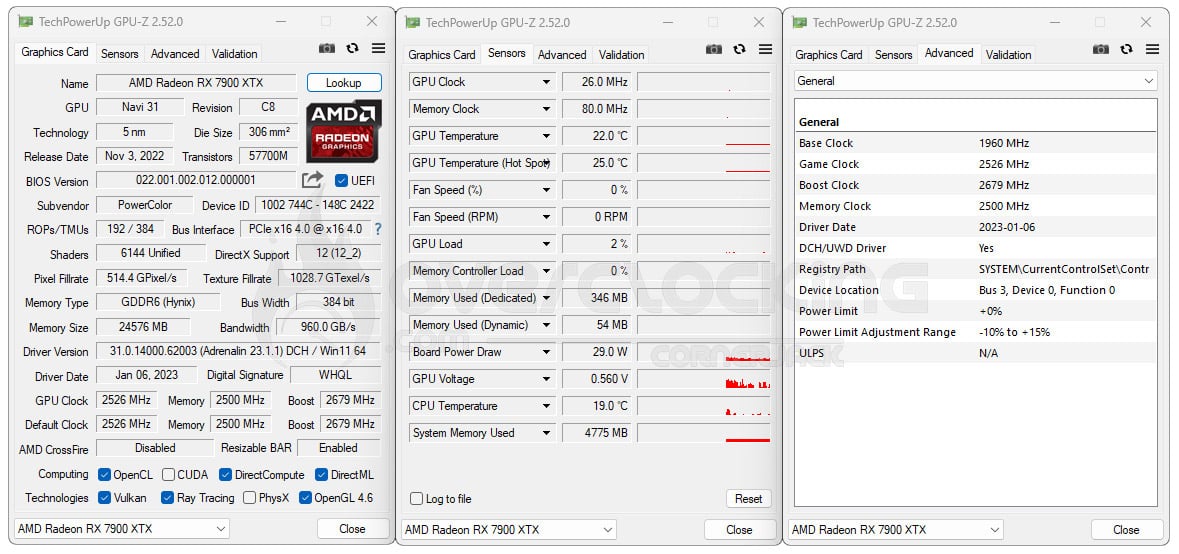

In terms of frequency, the base frequency is announced at 2526 MHz while the Boost is at 2680 MHz. The 24 GB of G-DDR6 memory runs at 2500 MHz (980 GB/s) on a 384 bit bus. Our Powercolor RX 7900 XTX Liquid Devil benefits from a very good factory overclocking, since the reference card, the RX 7900 XTX benefits from a Boost frequency of 2500 MHz.
A small passage through GPU-Z to check that the information read is correct. The information is correct with, as you can see, very cool temperatures. The power limit can still be adjusted to +15%, so we should still have some room for overclocking.
