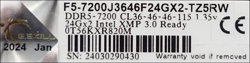

One side of the heatsink reads “Trident Z5 RGB”, while the other has a label with the technical specifications of our example, which looks more like a code name: “F5-7200J3646F24GX2-TZ5RW”. This is what we’re going to look at in detail. For example, in the case of today’s model, here’s the information we know.
- Brand: G.Skill
- Model: Trident Z5 RGB
- Capacity: 2 x 24 GB
- Frequency: 7200 MT/s
- Timings: 36-46-46-115
- Voltage: 1.35 volts
- Review: –

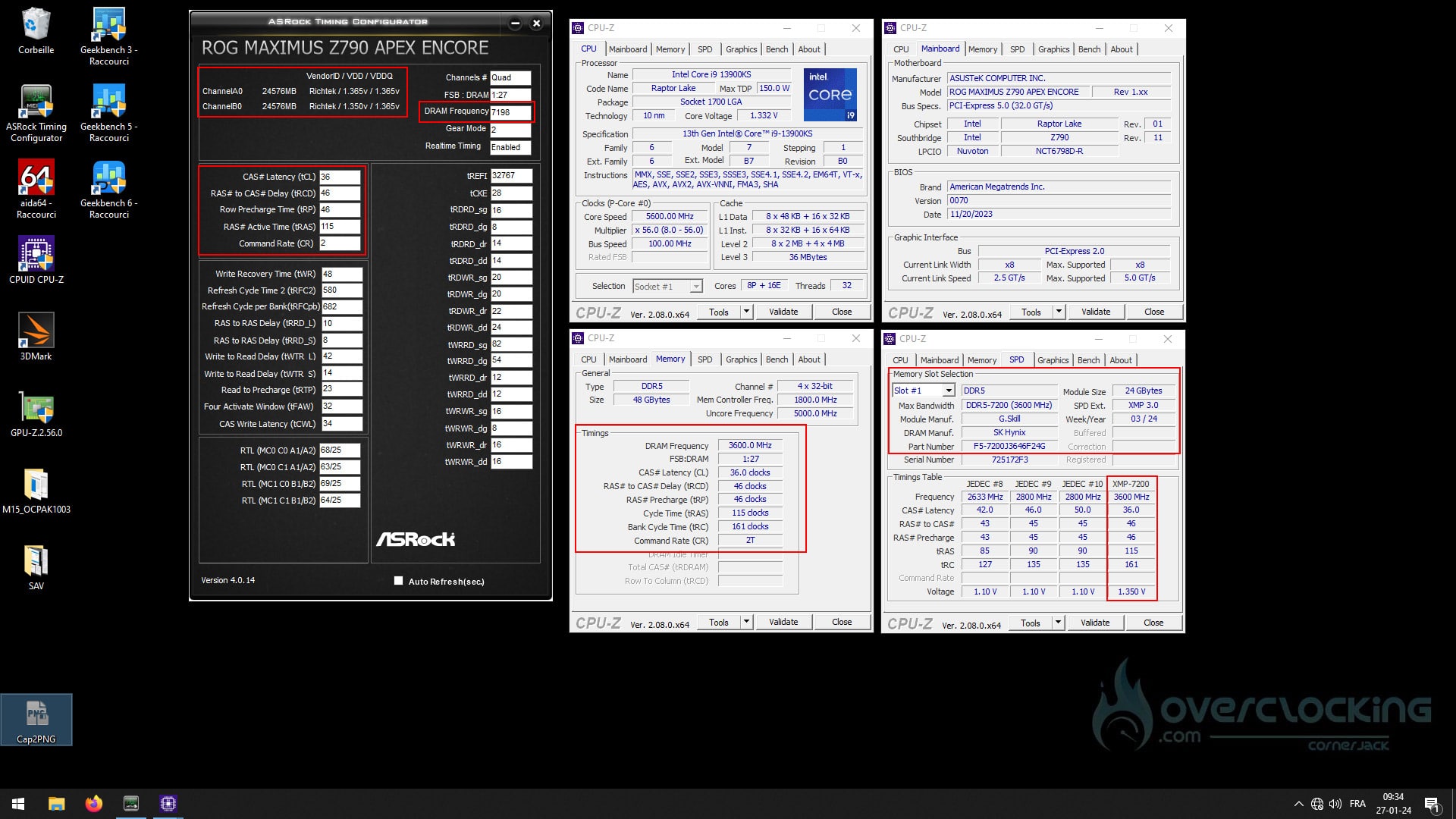

CPU-Z always present :
Fortunately, our trusty CPU-Z software is still at work, enabling us to verify this information, particularly with regard to the type of chips used in our kit. At present, there are three types of chip: Samsung, Hynix and Micron.
Our kit is perfectly recognized under Windows 10 and the different timings perfectly read. The memory chips used in our kit are Hynix. These are the chips with the best overclocking potential. As this is a 2 x 24 GB kit and not a 2 x 16 GB, we already know with virtual certainty that these are second-generation Hynix M-die chips.
Our memory kit PCB :
Our kit benefits from 3 GB chips, of which there are 8. We’re using Hynix M-die here, not A-die, but this is a new generation which further improves frequency rise. Our kit is an “SR” model for single rank, meaning that all the chips are on a single side. On the other hand, there are “DR” kits for dual rank , with chips on both sides of the PCB.
