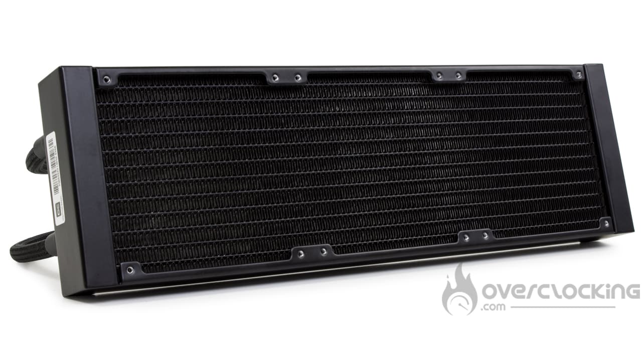

The radiator:
Alphacool Ocean T38 360 radiateur

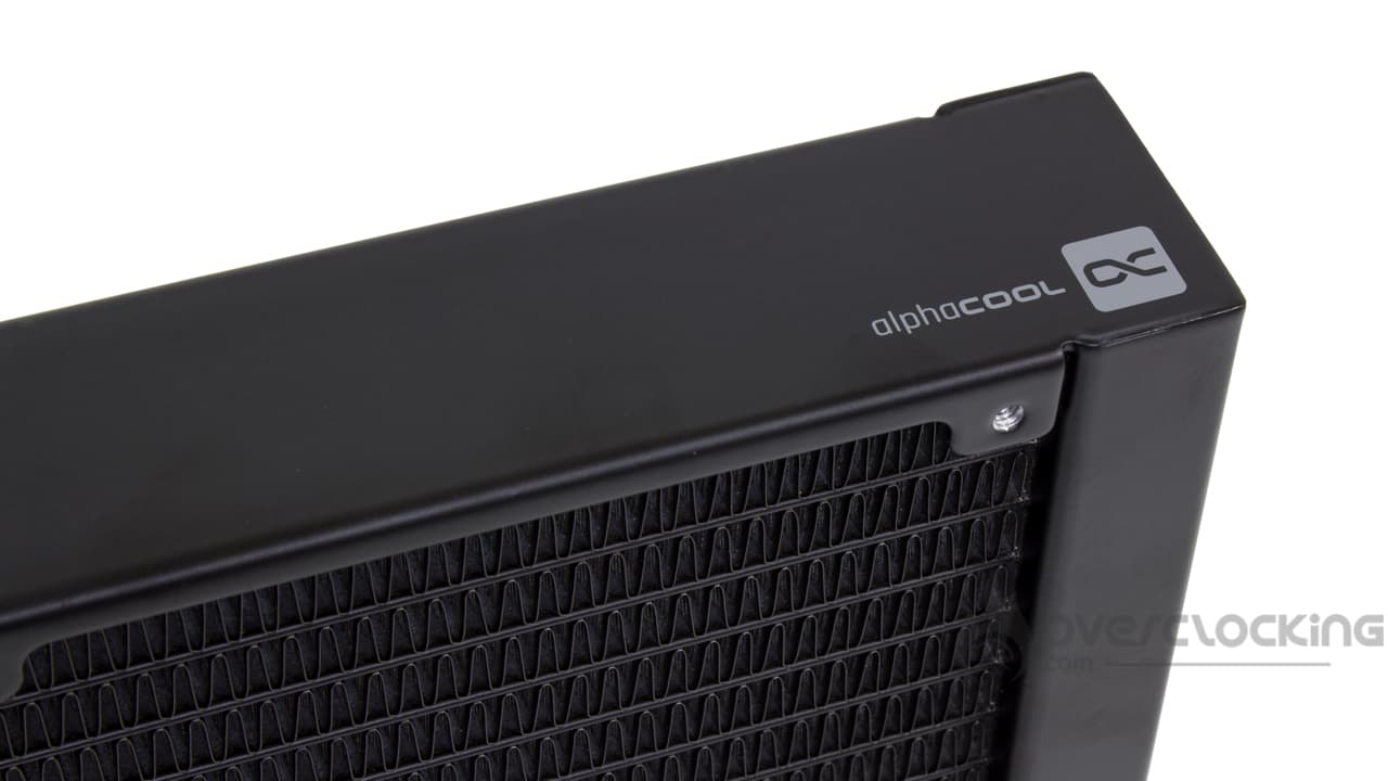

With this Ocean T38 series, we have the right to a radiator quite similar to what we can find at Arctic. This model offers a neat finish with a very elegant square shape. On the sides, we find a small Alphacool logo painted directly on the sides.
Nevertheless, what they have in common with the Swiss brand’s radiators is their significant thickness. The latter is increased to 38 mm in order to maximize performance. Moreover, Alphacool communicates on the fin density which is 19 fins per inch. A density rather low compared to what we usually test. But the goal is to maximize the airflow through them.
Otherwise, as we told you, the manufacture is aluminum. And the other dimensions are 397 (L) x 12 (W) x 38 (H) mm.
To connect the pump and the radiator, we find two FEP pipes with a total length of 40 cm. These also have a rather coarse nylon sheath. On the other hand, we can’t say that the tubes are very flexible.

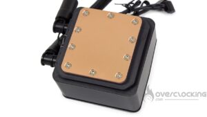

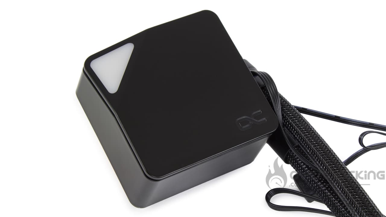

The waterblock:
The pump block has a rather sober and refined design. The latter benefits from a black plastic shell that will mark the fingerprints. As you can see, the whole displays a logo ” Alphacool” and a translucent triangle. Via the latter, we can enjoy an RGB lighting. On the other hand, the assembly is not necessarily the most precise, the plastic tends to crack.
Alphacool Ocean T38 360 pompe
Under the pump block is the cold plate which is made of copper. The latter is screwed to the rest of the hull by a total of ten Torx screws. The finish is excellent to say the least, since the copper base has a very pleasant sandblasted finish. The dimensions are 5.8 cm x 5.2 cm, enough to cover the IHS of any AM5 or LGA-1700 processor
As far as features are concerned, Alphacool announces that its pump will operate from 2500 rpm to 3500 rpm via a PWM power supply. Unfortunately, nothing is said about the flow rate or the water column, which is a shame for a manufacturer specialized in this field.
Alphacool Ocean T38 360 pompeFinally, on the connector side, we find a four-pin PWM fan plug for the power supply. As well as a second aRGB male/female connector to control the lighting via your motherboard.

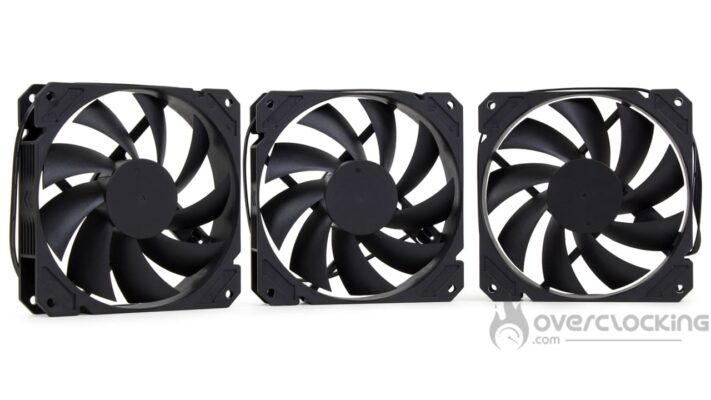

The fans
For its part, the ventilation will be provided by a trio of Core fans in 120 mm. These fans remain quite basic in their presentation. They have an entirely black frame, just like the blades. Moreover, the frame has no anti-vibration device. We can clearly feel that the brand has done everything to keep the price down.
Speaking of the blades, they are quite thin and not very curved. There are also nine of them. The frame, on the other hand, has a worked shape at the level of the anchoring points, but that’s all. Finally, the connectivity is simple with a single PWM connector with four pins at the end of a black and flat cable of 40 cm.
Alphacool Ocean T38 360 ventilateurs
In terms of features, the fans will run from 0 RPM to 2500 RPM. At full speed, the airflow will be 62.8 CFM while the static pressure will reach 2.13 mmH2O. Beware of the noise that may be present, often, beyond 2000 RPM, it is difficult to find quiet fans … Or at least not very noisy.

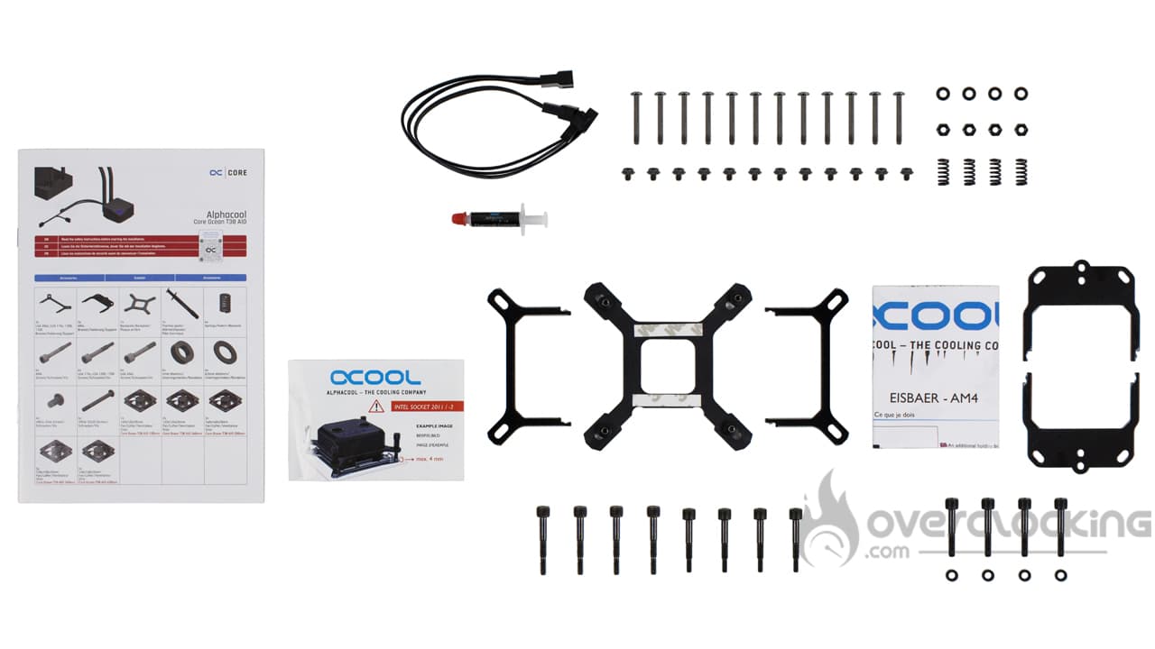

Bundle:
Alphacool Ocean T38 360 bundle
As for the accessories, we find something complete since the brand offers :
  • An assembly manual
  • A splitter allowing to connect three fans on a single plug
  • A small syringe of thermal paste
  • Screws and bolts for the assembly of the fans and the radiator
  • The screws for the assembly of the pump
  • Detailed instructions for each type of AMD and Intel platform
  • Steel mounting arms for Intel and AMD
  • A plastic backplate for Intel sockets
  • Screws and bolts corresponding to the different sockets
The accessory part is thus complete by offering all the elements necessary for the assembly of the Ocean T38. The splitter allowing to concentrate the three fans in a single plug is very practical and will save a good part of the connectivity on your motherboard. On the other hand, despite the years, it’s still a shame to find this old plastic Intel backplate whose elements separate as soon as you handle it a little too much.

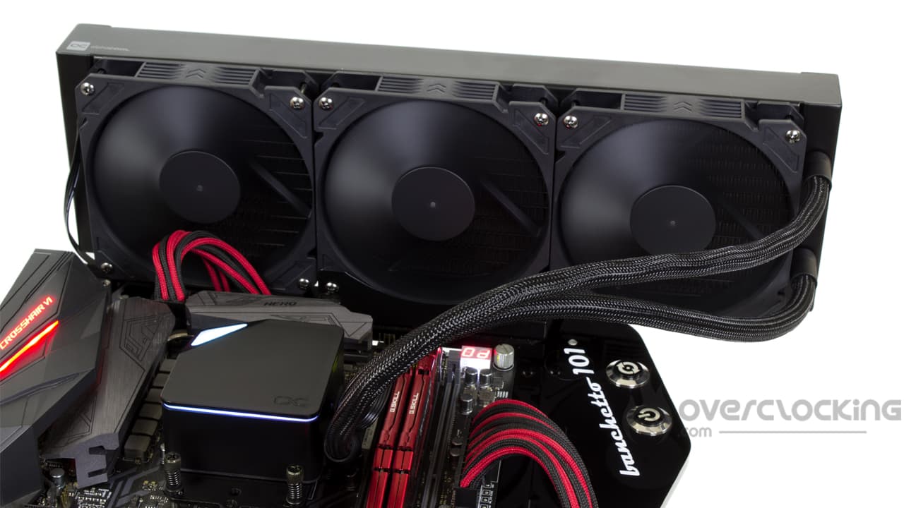

[nextpage title=”Installation and RGB”]
For the installation part, you will have to keep your AMD backplate, the manufacturer does not provide one. If you don’t have it anymore, a little tour on eBay should allow you to find one easily.
Preparation of the screws and the pump:
The first thing to do when assembling the Alphacool kit will be to prepare the pump. To do this, you will have to put the mounting arms around it. Depending on your motherboard, it will not be the same arms to install: cross-shaped for an Intel board, against the extended model in case of AMD platform.
The assembly is simple, you will have to clip the arms around the pump, a groove is present for the guidance.
Next, you will have to prepare the screws. For this, you will have to choose the right screws that will depend on your motherboard. In Intel, it is enough to thread a spring and a small washer when with an AM4 card, you will have to add an additional plastic washer.
And we mount!
The final assembly is still simple to do since you will have to add the plastic backplate to the back of your Intel motherboard. Be careful not to manipulate it too much since the screw threads of the backplate tend to come off quickly. Nevertheless, once in place, you can put a small amount of thermal paste on the CPU and install the pump. To do this, you’ll have to insert the screws (spring + washer) into the mounting arms and screw everything in place.
On the AMD side, it’s the same thing, you’ll just have to remove the original mounting arms to free the screw threads.

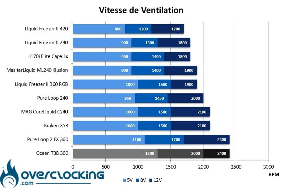

Fan speed :
So we start our series of temperature readings. Here, we start from scratch. Let us specify the fan speeds recorded during our readings (for 12V, 8V, 5V):
Vitesse
Clearly, the Core fans are capable of running at high RPM. As we can see, at full speed, we read 2400 rpm, with the Pure Loop 2 FX 360, the Ocean T38 is the fastest kit in our comparison.
At “8V”, the speed doesn’t even decrease that much since we go to 2000 rpm. Finally, at low speed, we find 1300 rpm, the fastest fans in our comparison.

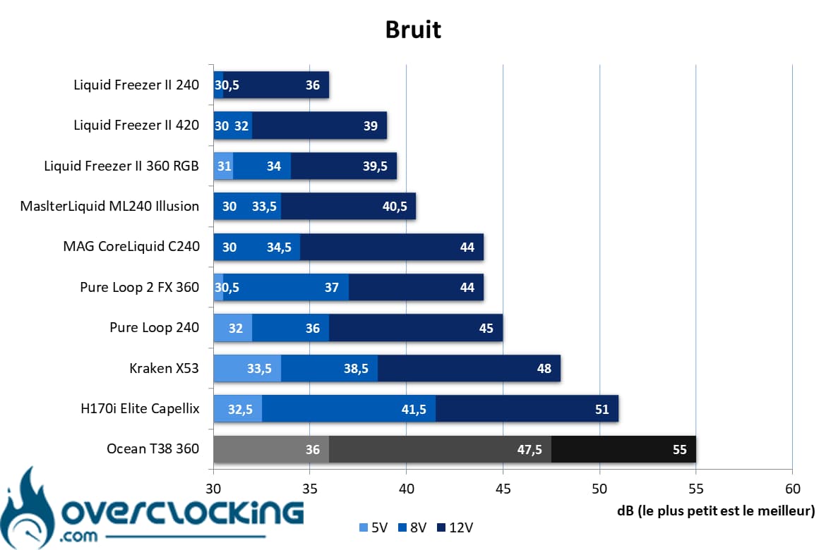

Noise :
Bruit
Of course, the noise quickly becomes very very present since we read 55 dB at full volume! Even when we were outside the room where we took our readings, we could hear it quite loud!
Reducing the fan speed brings a gain, but it’s not huge either, since it’s 47.5 dB. At low speed, things are more bearable with 36 dB… But it is not exceptional either. To have a fully silent kit, don’t hesitate to set a custom curve from the bios of your motherboard.

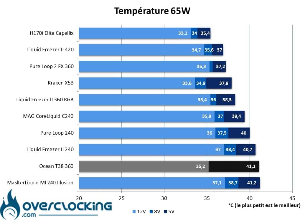

Processor at 65W
Despite a more violent 65W profile, this last one still represents the least stressful phase of this protocol. It allows to highlight the performances obtained with compact/entry-level heatsinks. These results are only indicative for the largest heatsinks (AIO, large dual tower heatsink, etc.).
Températures 65W
On our 65W profile, there are some things to say. Indeed, when the pump and the fan are running at full speed, we read 35.2°C. A respectable score that puts theOcean T38 on a par with Arctic’s Liquid Freezer II 360 RGB. Moreover, at mid-range, we did not notice any difference in temperature.
However, at low RPM, the temperatures increase significantly with 41.1°C of readings. As you know, at low speed, we regulate both the ventilation and the pump. Obviously, reducing the speed of these two elements is detrimental to temperatures where other models do better.

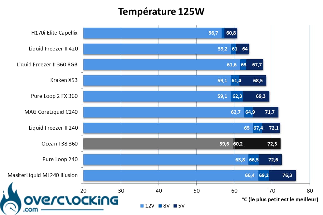

125W Processor:
Finally, we finish with our 125W profile. Here the heat release is more important, let’s see how our coolings do!
Températures 125W
In 125W, the story repeats itself with rather good temperatures on the highest speeds but which collapse at low rpm.
Summary
Overall, we can say that the Ocean T38 does very well as soon as its fan is running at 2000 RPM, higher, there is no real gain to be had. On the other hand, if you decide to reduce the speed of the pump and the fans, there may be a problem. Indeed, temperatures tend to rise quickly. So, if you want to be quiet, you will have to let the pump run at full speed so that you can reduce the fan speed without having a big impact on the temperatures.
