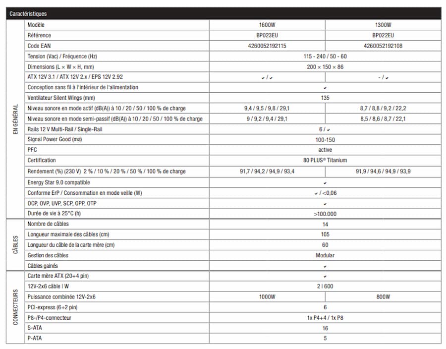

be quiet! continues to expand its lineup of high-end power supplies with the Dark Power Pro 14 IO. This new generation is clearly aimed at the most demanding setups, whether they’re gaming PCs equipped with next-generation graphics cards, heavily overclocked machines, or workstations designed for content creation and post-production. The lineup consists of two models, with power ratings of 1,300 W and 1,600 W. It combines 80 PLUS Titanium and Cybenetics Titanium certifications, the ATX 3.1 standard, compatibility with PCIe 5.1 graphics cards, and a cooling system capable of operating in active or semi-passive mode.

Up to 94.9% Efficiency
The 80 PLUS Titanium and Cybenetics Titanium certifications accompany an efficiency rating of up to 94.9%. High efficiency helps minimize energy losses and also contributes to reducing heat generation and cooling requirements.

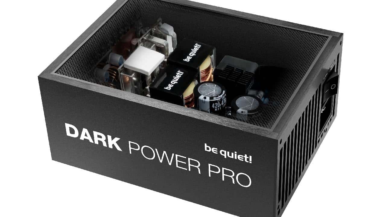

Dark power Pro 14 IO
be quiet! uses a fully digital design based on Active Rectifier full-bridge LLC technology. This is intended to ensure better regulation, high efficiency, and reduced ripple noise.

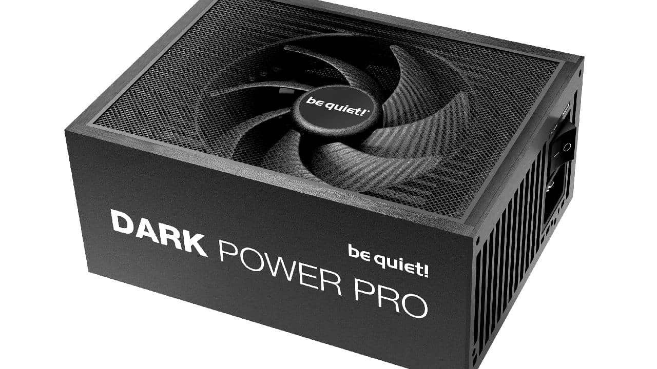

Cooling is provided by a new aluminum heatsink. In active mode, the Silent Wings fan runs continuously. In semi-passive mode, it remains off during low load and starts only when cooling demands increase. The fan is directly integrated into the heatsink to minimize vibrations. It features a 6-pole motor and a hydrodynamic bearing, designed to offer a long service life while maintaining low power consumption.
ATX 3.1, PCIe 5.1, and 12V-2×6 Connector

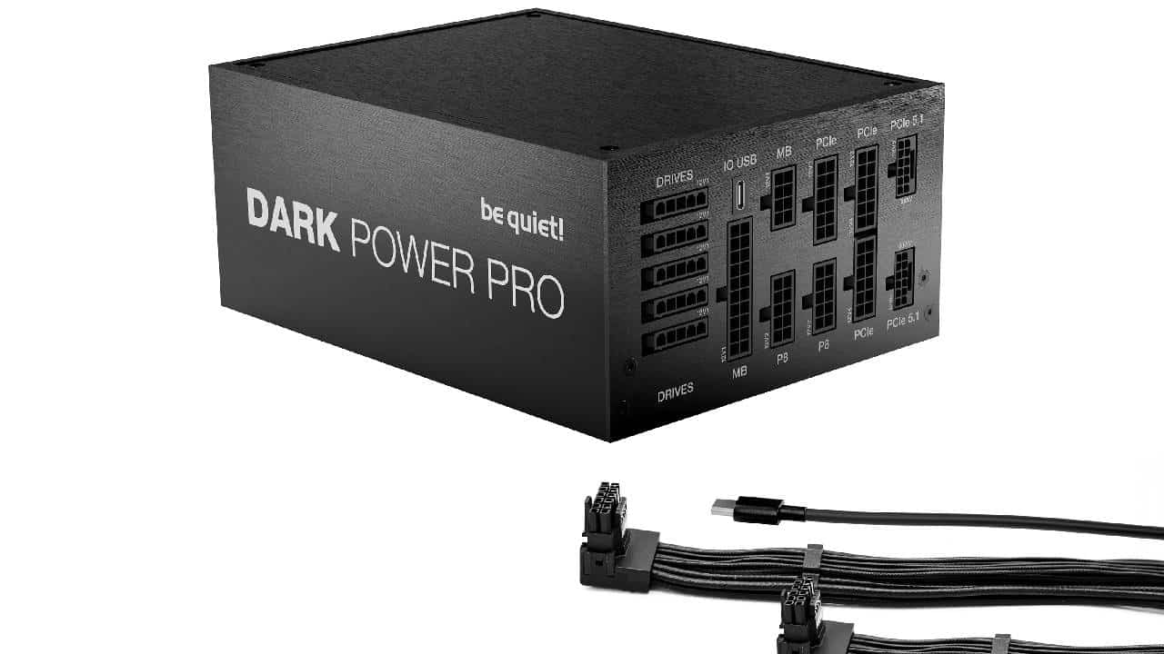

The Dark Power Pro 14 IO complies with the ATX 3.1 standard and natively includes a 12V-2×6 connector, designed specifically for next-generation PCIe 5.1 graphics cards. Four 6+2-pin PCIe connectors are also included to ensure compatibility with current graphics cards.

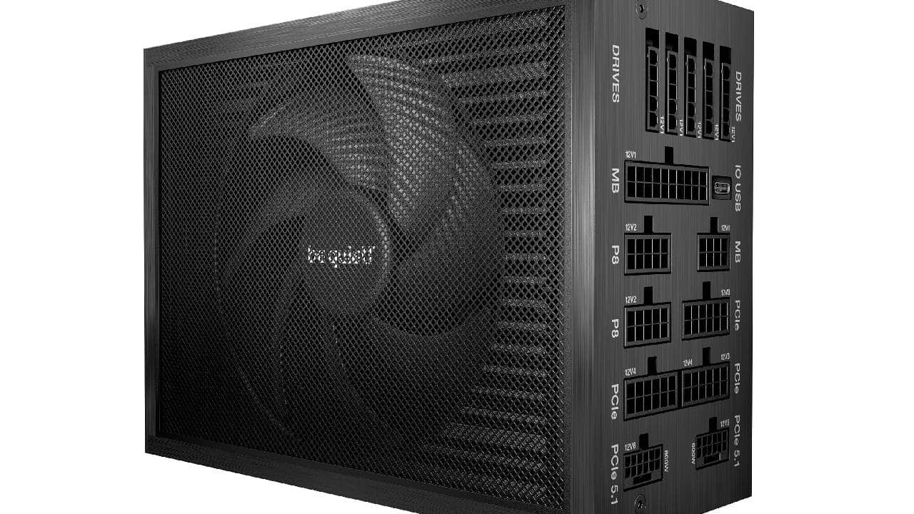

The fully mesh-covered front panel features a funnel-shaped air intake to improve airflow, even when the power supply is operating at full load.

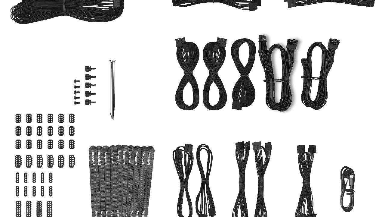

The power supply is fully modular and comes with sleeved cables. Four sizes of cable clips are included to help organize and route the cables inside the case. This arrangement can also help improve airflow in larger builds.
