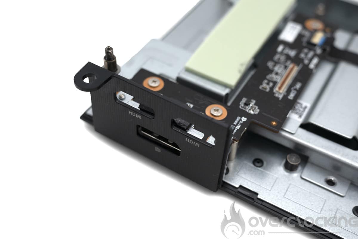

The special feature here is the second DisplayPort 1.4 port on the top cover. This can be configured on Asus ExpertCenter products as an RS232, VGA, HDMI, RJ45 or DisplayPort port.
Asus ExpertCenter PN64 - DisplayPort

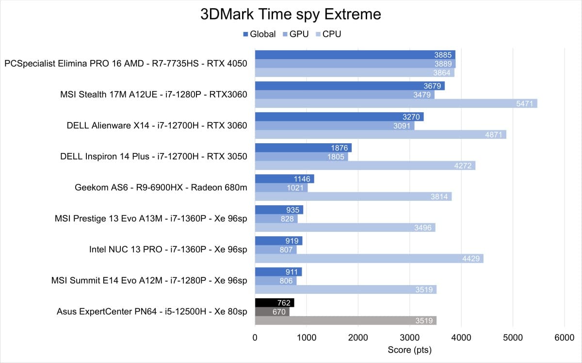

3DMark Timespy extreme
Asus ExpertCenter PN64 - 3DMark time spy extreme
As with Time Spy, performance on the extreme version of the benchmark is still lagging behind.

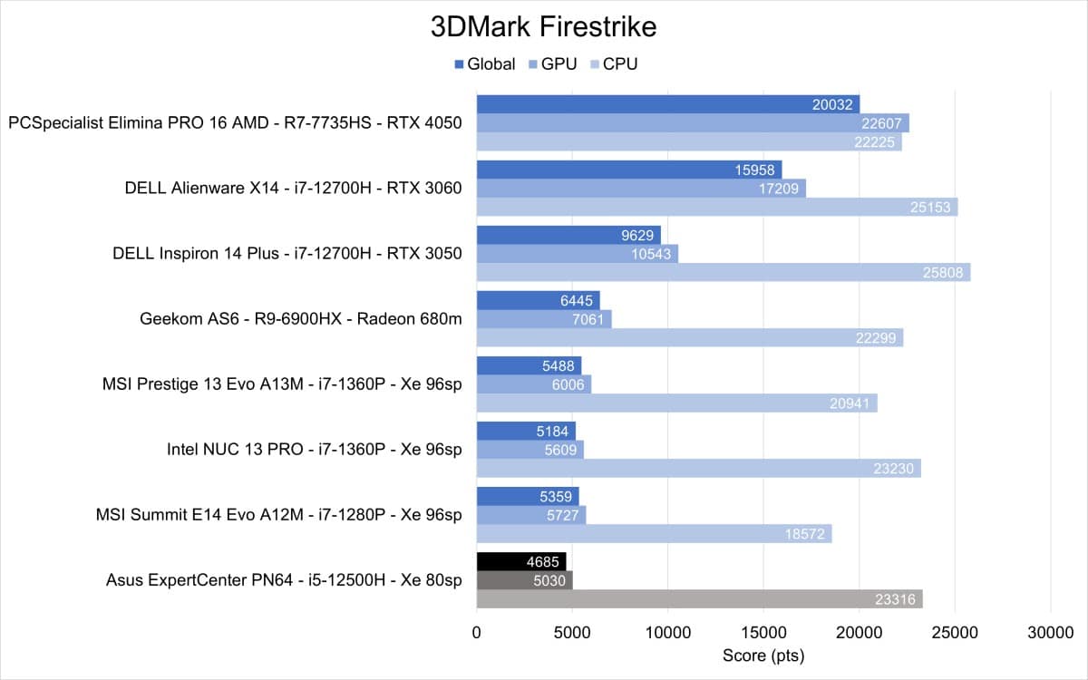

3DMark Firestrike
Asus ExpertCenter PN64 - 3DMark Firestrike
In 3DMark Firestrike, the Intel Xe 80sp continues to lag behind at the end of the ranking.

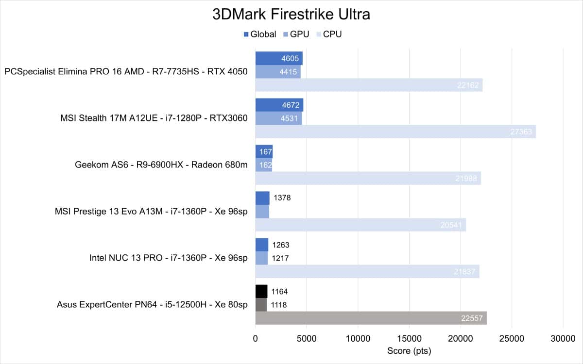

3DM Firestrike Ultra
Asus ExpertCenter PN64 - 3DMark Firestrike Ultra
On Firestrike Ultra, performance once again lags behind the competition.
It’s fair to say that we’re not dealing with a high-performance graphics solution here, with scores relayed to the bottom of the table. So don’t count on this Intel Xe 80sp IGP for gaming. It remains to be seen whether this will detract from productivity performance.

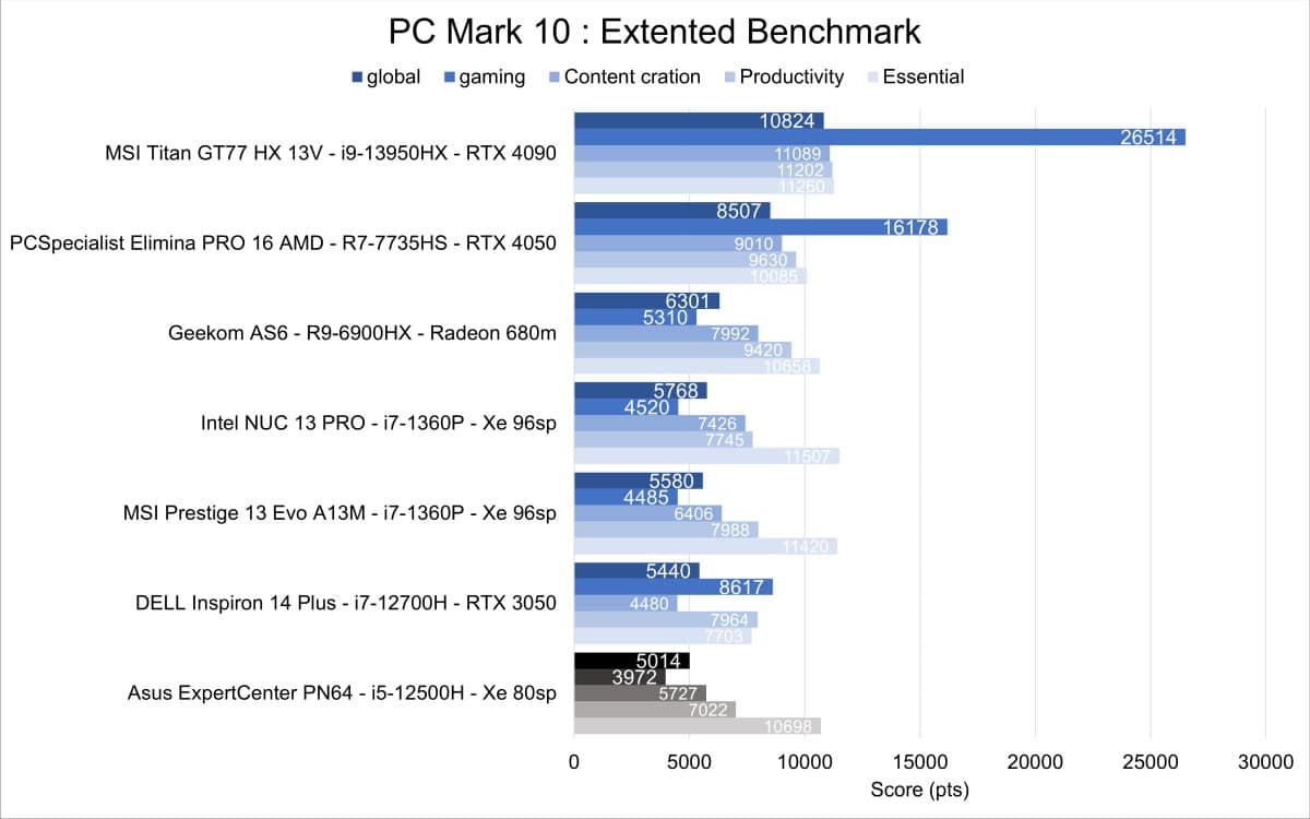

PCMark 10 Extented
Asus ExpertCenter PN64 - PCmark 10 Extented
PCMark 10’s overall performance is less impressive. Unfortunately, it’s hard to say because the SSD is clearly not up to the level of those tested on other machines.

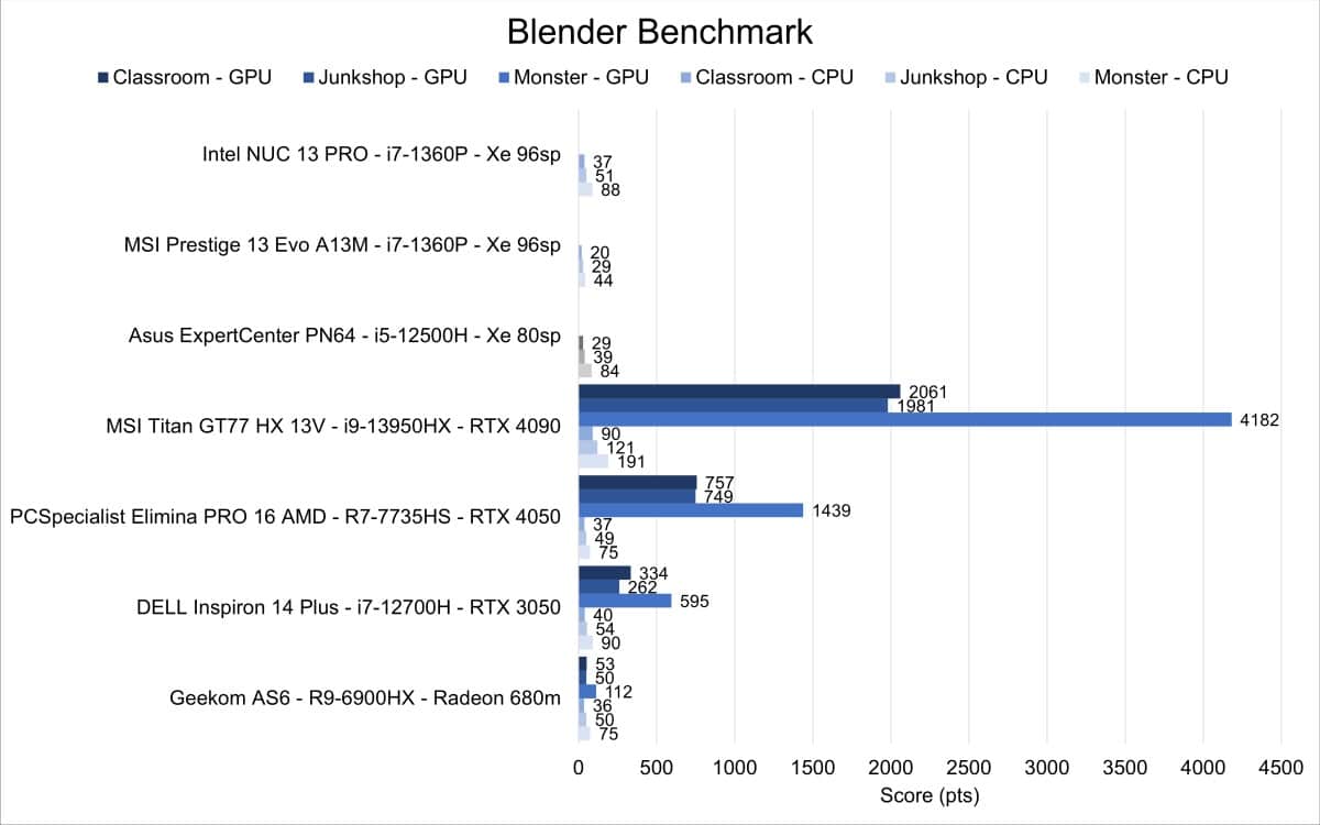

Blender
Asus ExpertCenter PN64 - Blender
Let’s move on to the Blender benchmark, where performance is midway between the two i7-1360p on an MSI ultra-portable laptop and Intel’s NUC 13 PRO.
