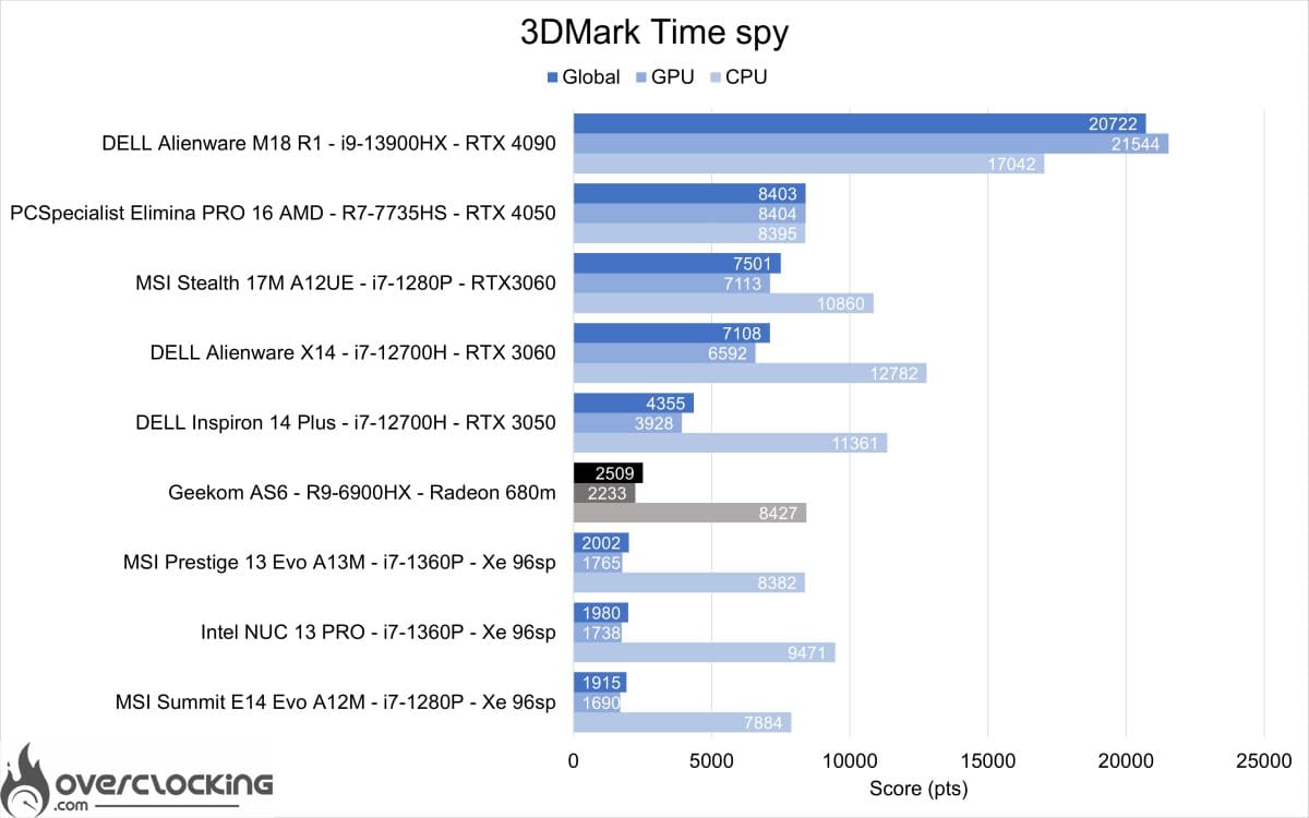

3DMark Timespy
Let’s start with 3DMark Time Spy, where we achieved 25% better graphics performance than the Intel Xe 96sp.

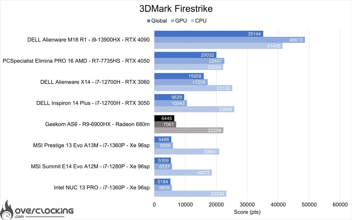

3DMark Firestrike
On 3DMark Firestrike, the Geekom AS6 does even better, this time with a 17 th improvement over Intel solutions.

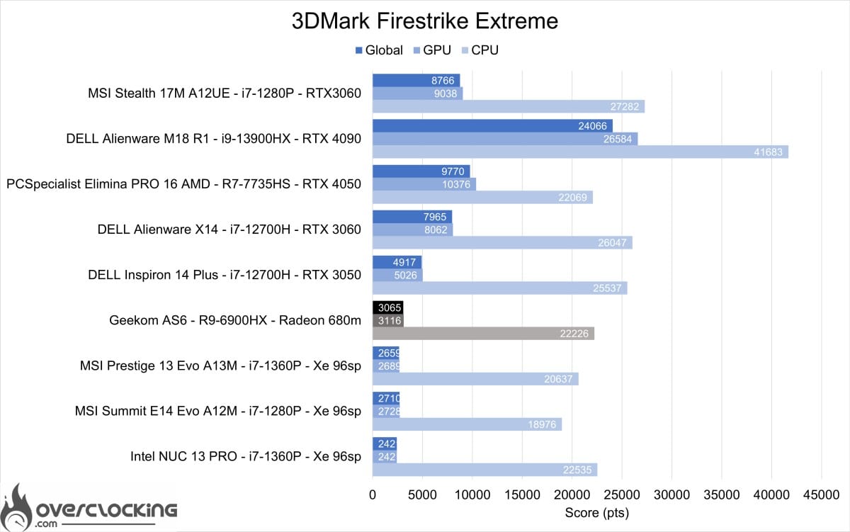

3DM Firestrike Extreme
On 3DMark Firestrike Extreme, the gap remains the same. We’d also like to highlight the CPU’s excellent performance on all 3DMark benchmarks.

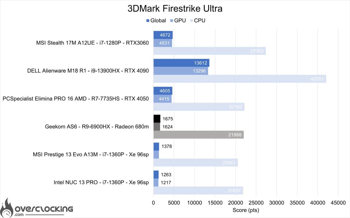

3DM Firestrike Ultra
On Firestrike Ultra, the performance of this AMD IGP is once again very good.
