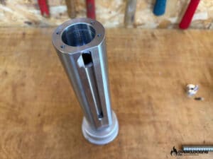

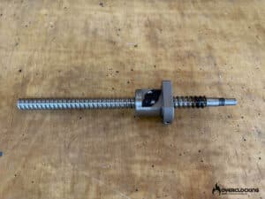

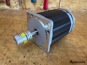

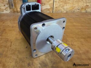

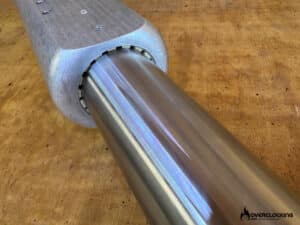

THE ACTUATORS

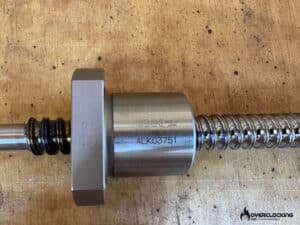

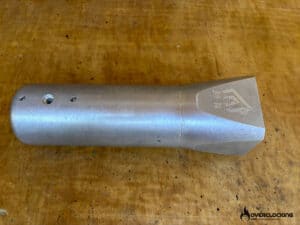

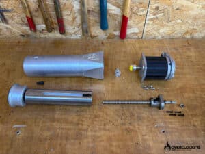

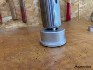

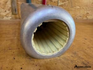

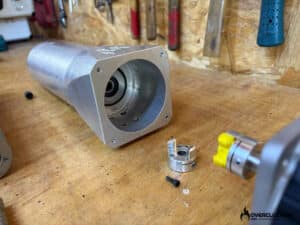

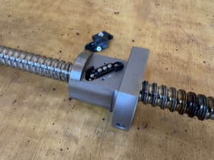

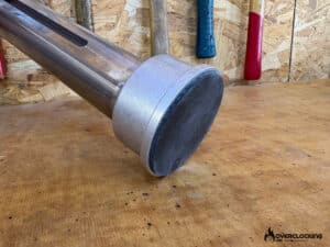

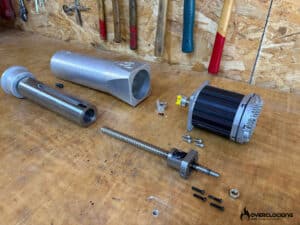

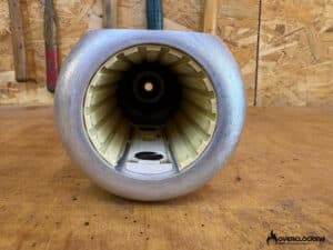

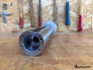

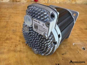

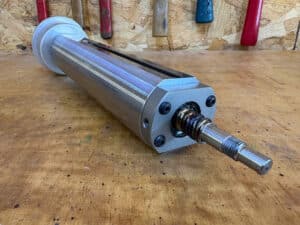

The actuators are a thing of beauty. All machined from billet aluminium, nothing feels cheaply casted or built. The integrated servo motor sitting on the top is an industrial grade premium solution from Teknic.com, an American company. The body of the actuator is machined in house by Sigma Integrale with solid nickel plated pistons. The bearings are German made IGUS linear bearings, never needing any lubrication, ever! And the ball screws are custom designed for Sigma from an industrial Japanese giant THK. Even the rubber pads under the foot are made by 3M. Nothing is left to chance.
The following pictures are of a DK6+ actuator that has been used for demo for a few years. This will also show us how the internals are holding up to the abuse.

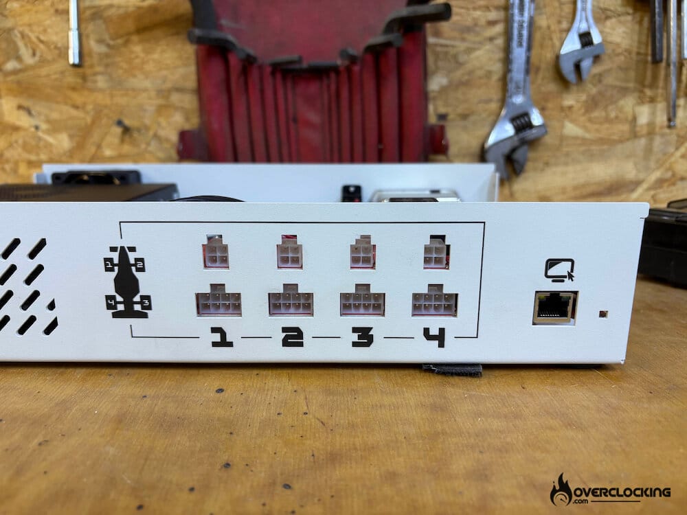

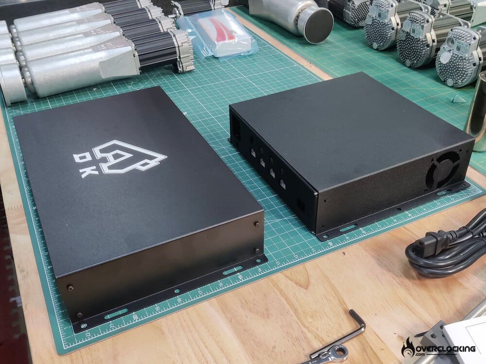

ELECTRONICS

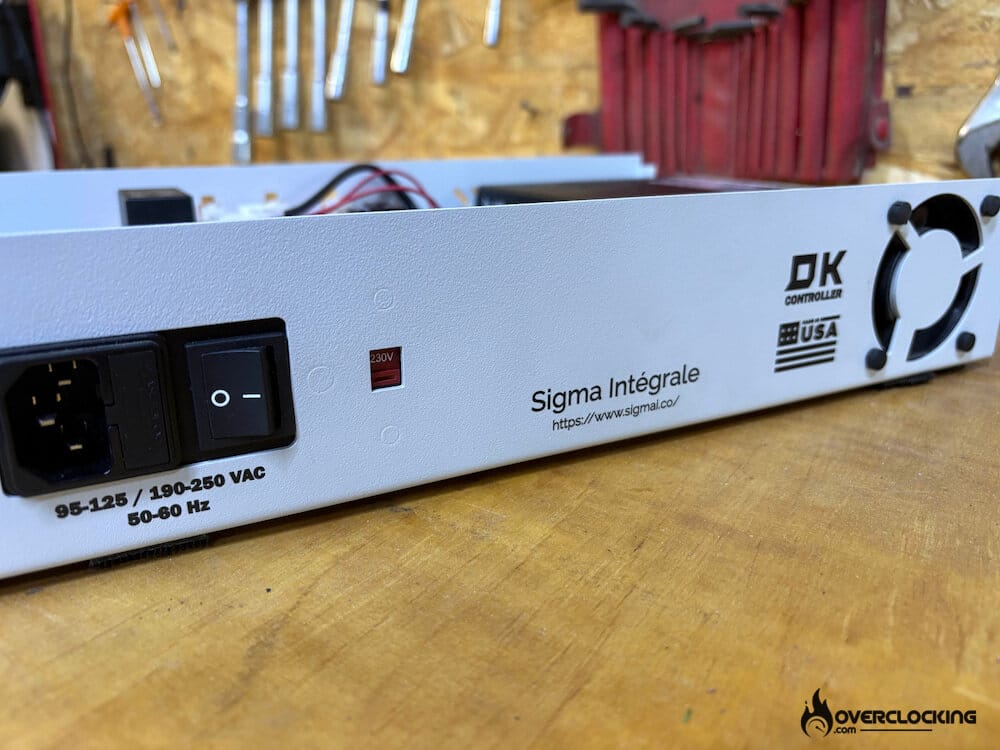

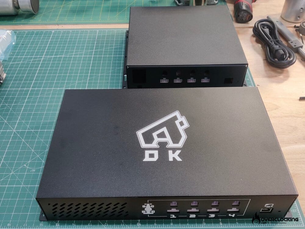

Same story goes for the controllers and cables. The cables are made by Molex, an American company, although manufactured in China. The connectors are ultra rugged and made for industrial applications. The cables can be disconnected and extended to lengths of up to 150-feet (45 meters) from the controller. The cables are also thin and pliable, or easy to install and route on your rig. This is mainly due to the fact that Sigma is the only company that runs a 75 volt DC architecture. This also makes their motors smaller but as powerful as some of the larger counterparts.
While other systems use a USB connection, Sigma chose to use an RJ45 or a network connection. And there are good reasons for it. Firstly, the cable is shielded, which prevents EMI interferences. Secondly, they can run much larger cable lengths and even have their controller connect to your local area network. This decision also comes from their past industrial motion applications such as auto shows, R&D and customer high voltage vehicle motion builds where unshielded USB lengths presented various issues.
Sigma Integrale

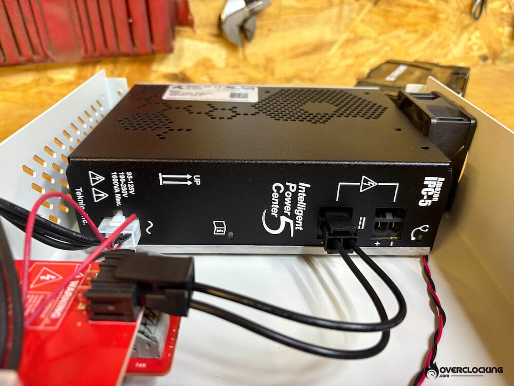

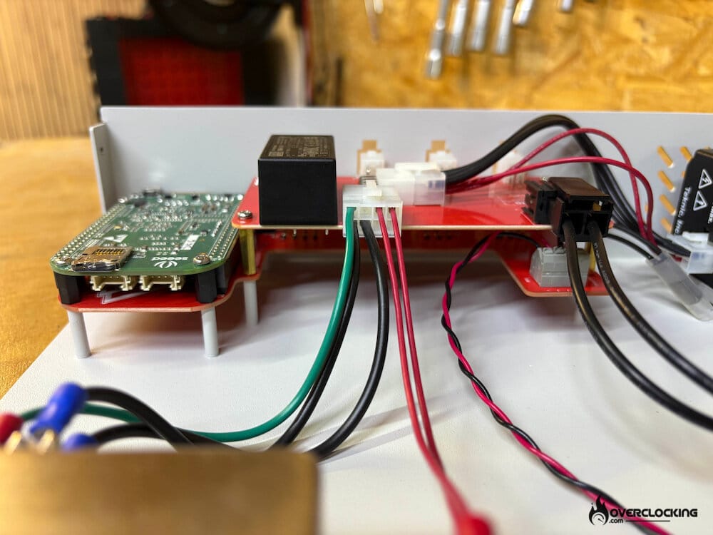

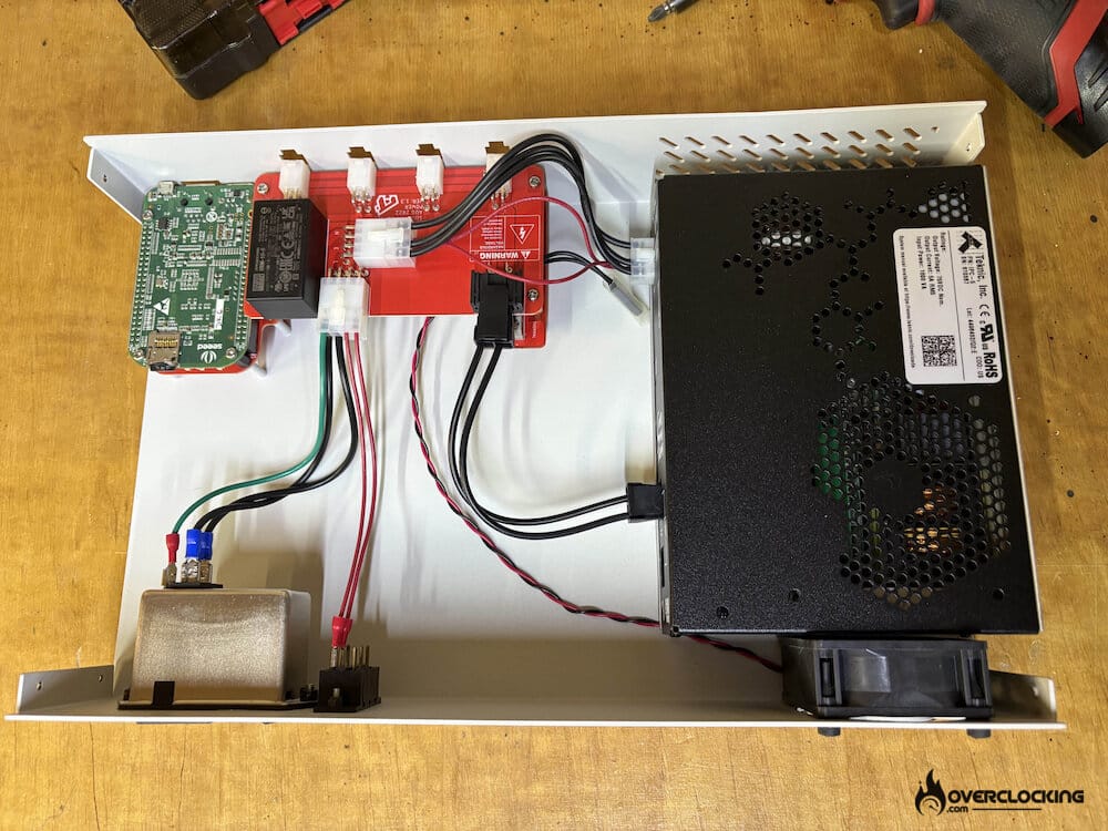

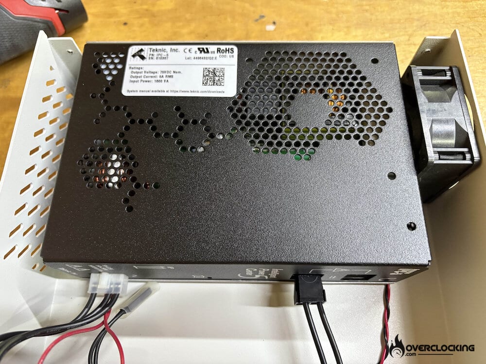

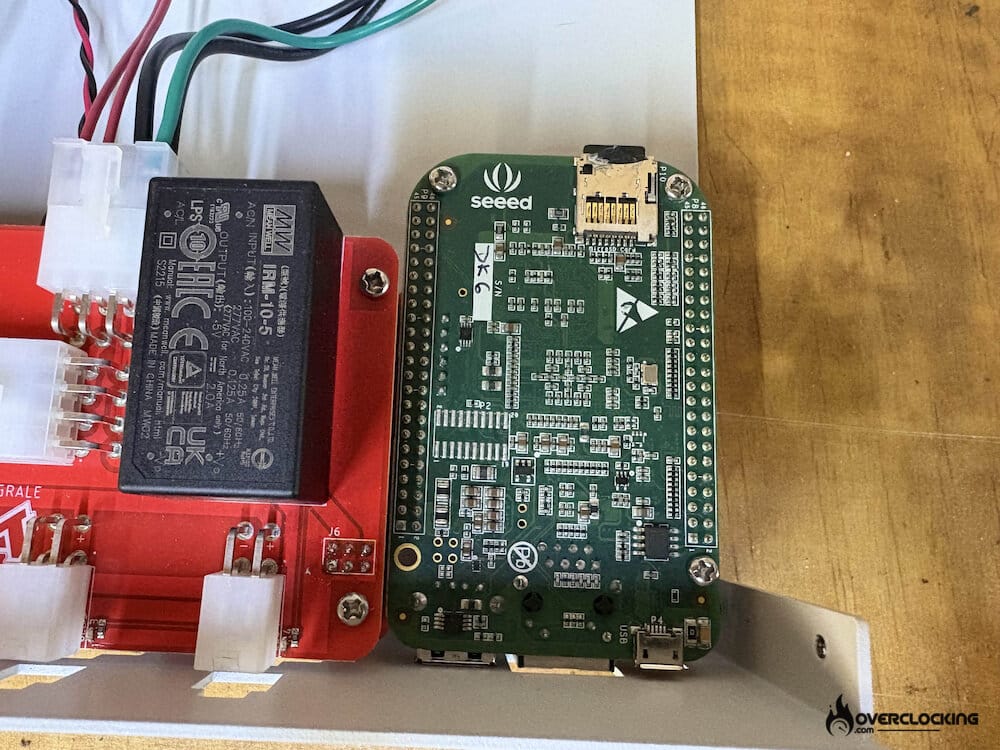

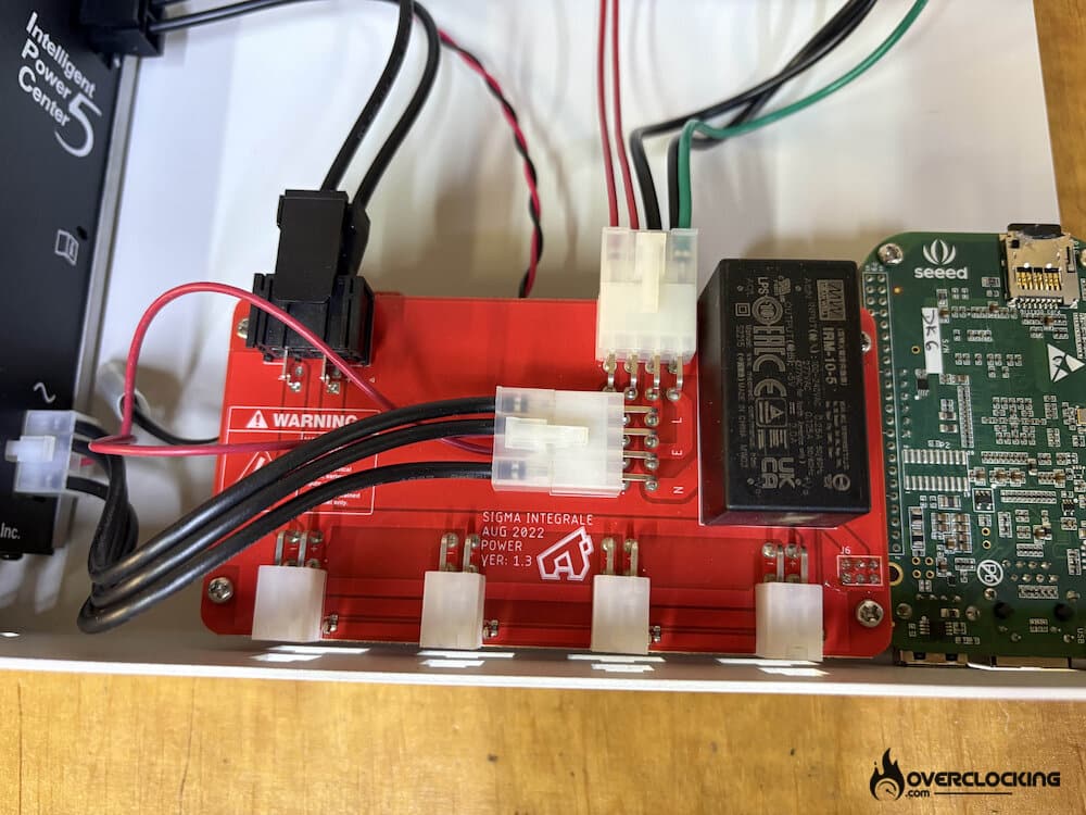

Inside the controller, we can find a power supply from Teknic, Inc and a controller board made in house by SIgma. On the board, you will find an ARM 32-bit processor and several other real-time sub-processors by Texas Instruments. This little beast calculates all the motion movements in real-time at 10 kHz, removing any potential latency typically caused by processing motion in non-real time systems, such as Windows OS. This is extremely important for movement fidelity, or that fine grit and detail you get from certain simulation softwares that properly laser scan their track and provide accurate physics vehicle/tire models. Subsequently the low latency also helps prevent motion sickness or removes any discrepancy between the motion and the monitor.

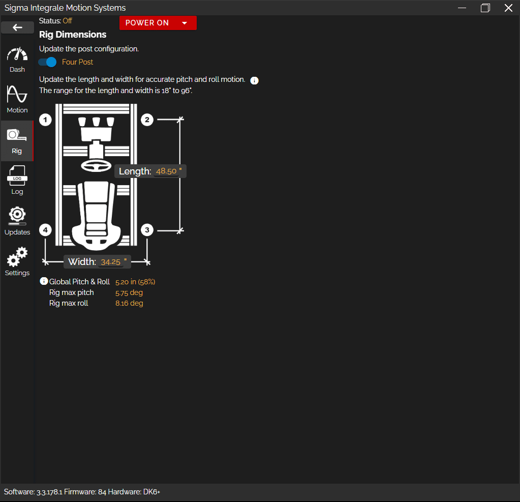

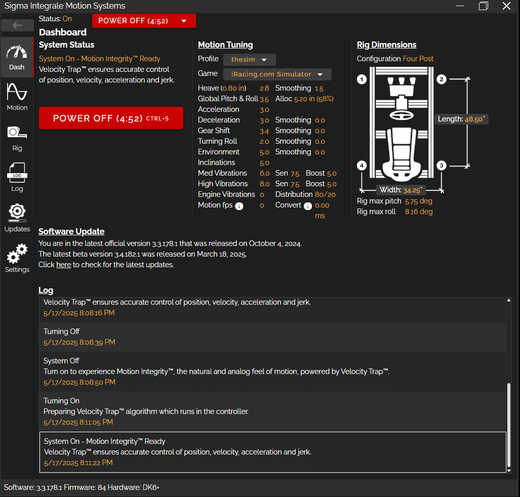

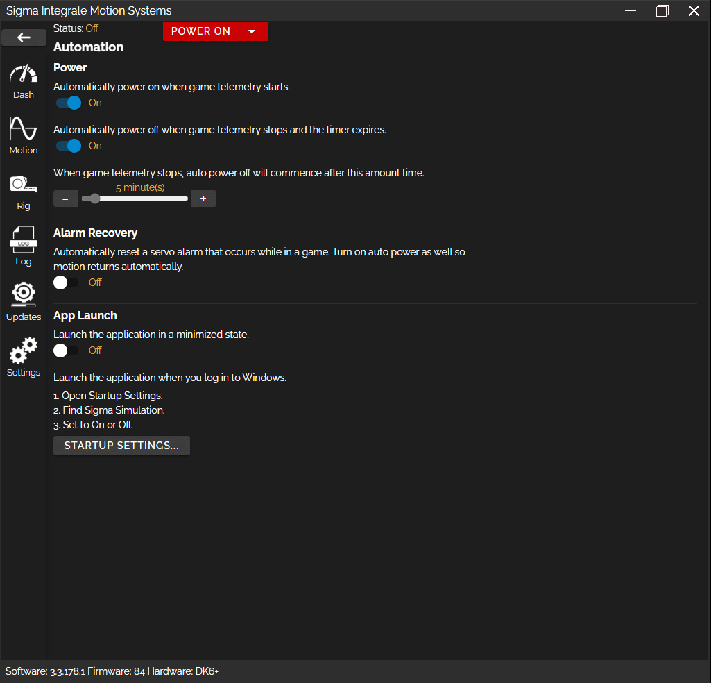

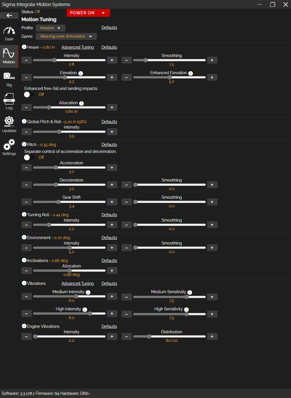

Once the setup is done, it is time to launch the SigmaSimulation software. Here you will have a one-time configuration to do which is to measure the length and width between the 3 or 4 actuators. This is done to ensure what Sigma call’s Motion Integrity, or to give the customer the best motion experience. Once the measurements are imputed, Sigma makes a simple calculation and changes the pitch and roll amounts to ensure that they match the simulated vehicle or aircraft.
From there, most games won’t need any other settings to play. So I jumped on iRacing, and as soon as the car started, the actuators came to life by detecting the game telemetry. You can also decide to power ON and OFF via the software, or even auto power off when the game telemetry is not being received for X minutes, creating an automatic sleep mode.

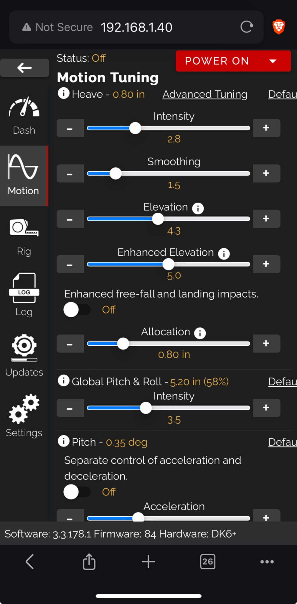

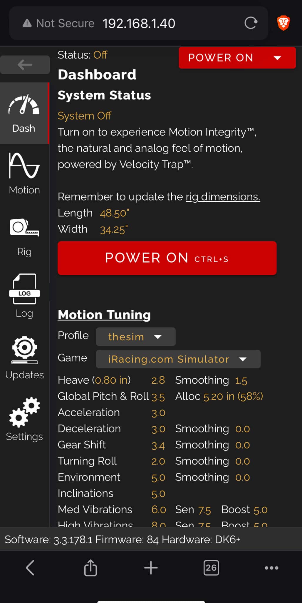

On to the motion settings. These can be modified either directly on the software, or on your phone via an IP address that you will input on your browser. So you can fine tune the settings while playing your software title, without having to switch back between game and Sigma software.
What’s missing? Maybe a few setups made by pro drivers for each game to make it even simpler…
