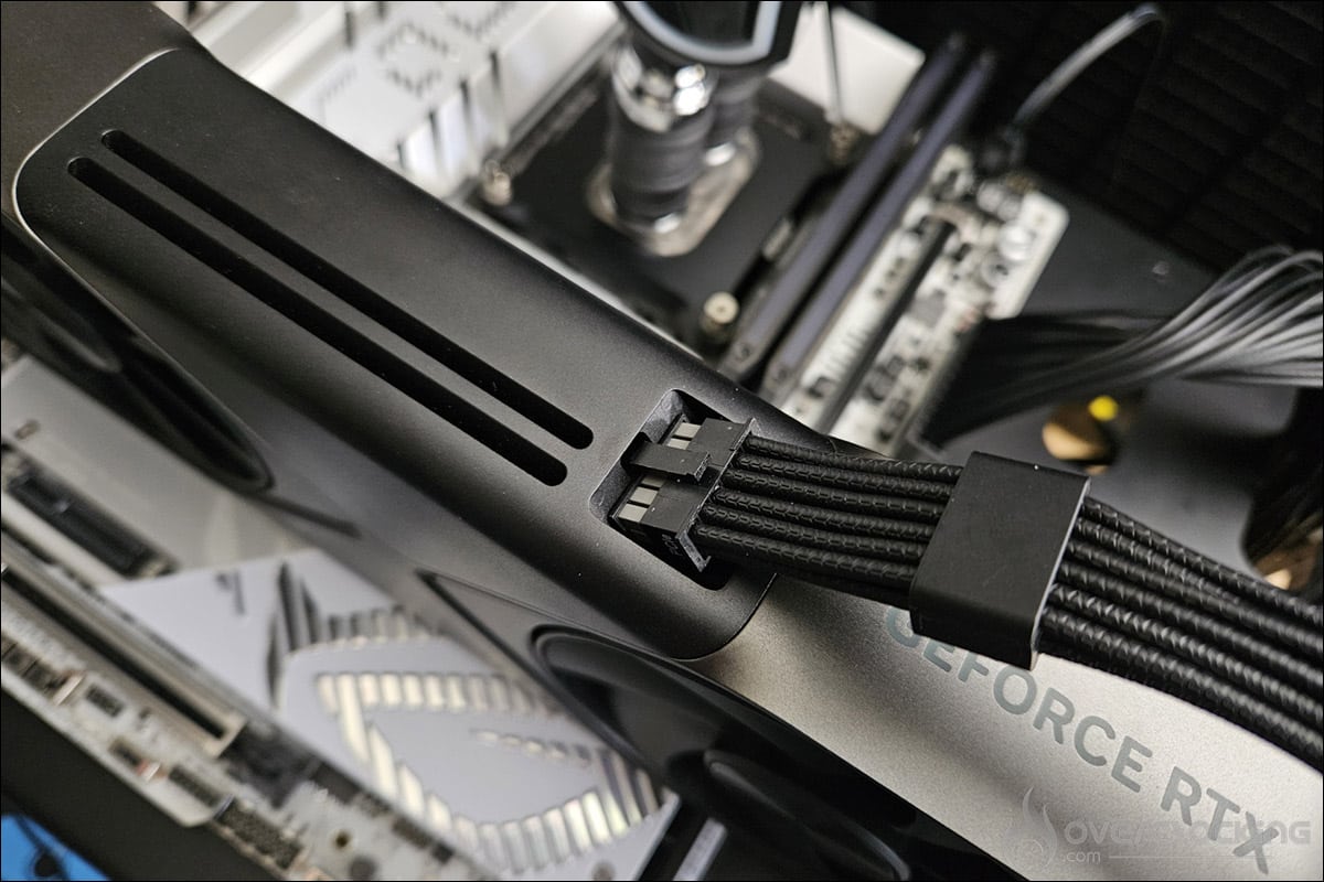

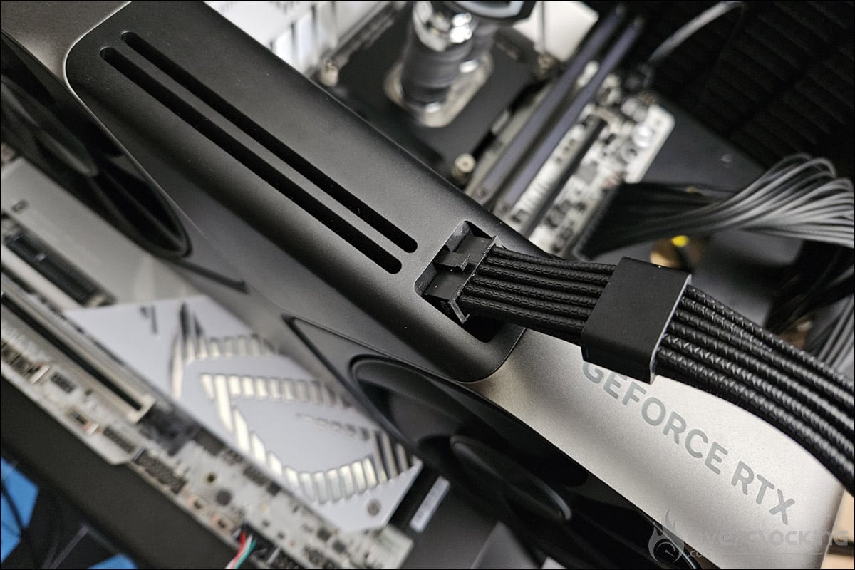

Let’s be honest, we’re not going to take the risk of incorrectly threading the connector or failing to insert one of the connector cables in order to ensure that the Corsair ThermalProtect 12V-2×6 cable is working properly. We’re going to run several stress sequences and see how our cable reacts by measuring its temperature. To test the cable, we decided to use it in conjunction with the MPG Ai1600TS PCIE5 power supply, which is compatible with any power supply with a native 12v-2×6 connector.
The photos above show, on the left, the cable not correctly inserted and, on the right, perfectly connected to our NVIDIA RTX 5090 Founders Edition. The gray end of the connector is invisible.

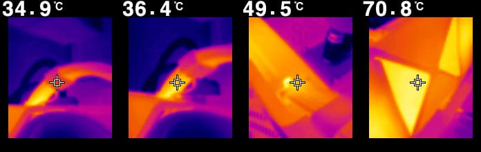

The idea of our tests is to put our NVIDIA RTX 5090 Founders Edition through its paces, in order to measure cable temperatures in normal use. As we’ve explained, the cable is perfectly inserted into our graphics card and power supply unit. We wouldn’t dream of deliberately damaging one of our components during this test. Despite a temperature of 77°C for the GPU, the various cable readings are excellent. After a third series of 20 minutes of stress, the temperature at the probe was 34.9°C, 36.4°C at the cables and 49.5°C at the connector. Let’s not forget that we’re drawing 577 watts at this point.
NVIDIA RTX 5090 FE – 20′ from FurMark – 577 watts
